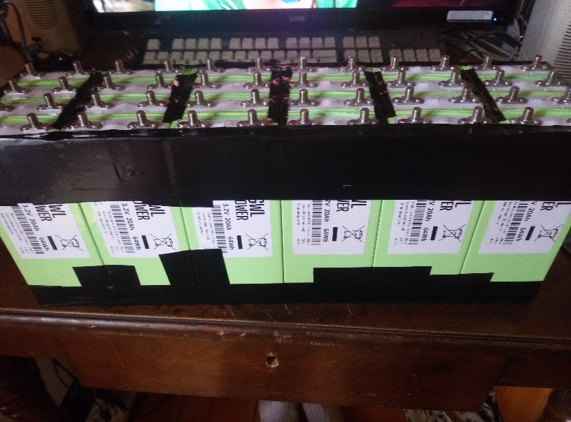

Ebike 7000W project
Jun 29, 2014
50
Motor
HPM-5000B 2-7 KW
Bat 24x LIFEPO4 3.2V 20AH ALU
Controler meantime KEB72451X,24V-72V,220A,4.5KW

I have the same BMS, it came on a 72v lifepo4 pack straight from bmsbattery
when I burnt the first one and replaced it, the charger/controller negative goes to p-
and you ignore the other connections
