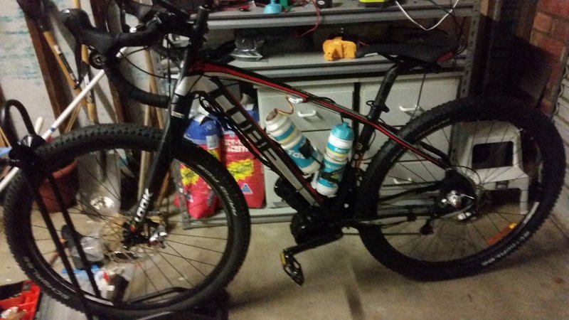

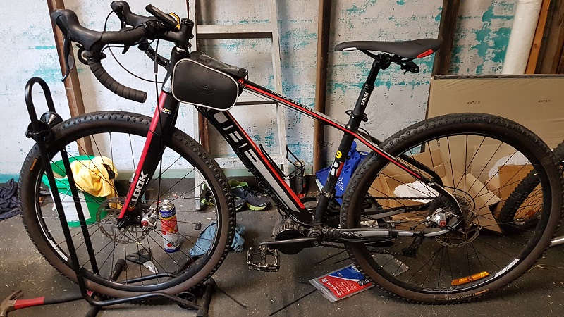

This is the bike in its current (final) form :
The Bike in it's Version 2 Form :
Bike :
- Cube Reaction 29er frame (aluminium for BB clearance)
- Look 986 Tapered Carbon fork for 29er
- Shimano 9 speed MTB megarange 11t-34t cassette (already had)
- Shimano Altus 9 speed rear mech (already had)
- Shimano Altus front mech (already had)
- Concept Ex wheelset (quick release), seatpost and seat (already had)
- Deda dropbar
- Shimano Sora 3500 sti shifters ( 9 speed - explain this later )
- Avid BB7 road disc brakes. 160mm rear, 180mm front.

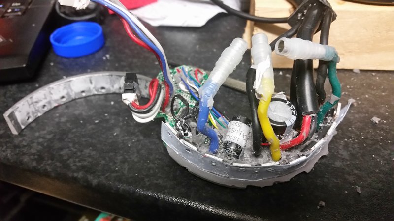

Electronics :
- BBS02 with C965A from eMax Sydney
- 52v setup - 14S1P of Hobby King Zippy Compact 5800mAh lipo (2 x 7S)
- Greentime 14S 30A BMS ( 5A charge circuit ) ~AUD$30.
- em3ev 58.8v 5A charger ( I also have a Greentime 58.8v charger coming which can be had for under AUD$60 delivered to Melbourne)
- Full charge from empty takes about 1 hour.
- Upgraded BBS02 48t chainring.
Details :
- Lights - Moon Comet Front and rear.
- Full weight - 19kg.
- I use throttle only for 99% of rides.
- It will easily do 25km on 5800mAh juice if you keep it under 35km/h. Going faster burns it faster.
- Top speed of 50km/h with assist ( 48t chainring and 11t rear makes this possible )
- 1 x 9 speed MTB setup gives enough low gears to get me out of most hills without power. As the BBS02 is geared, it doesnt have any drag, so feels like a normal bike.

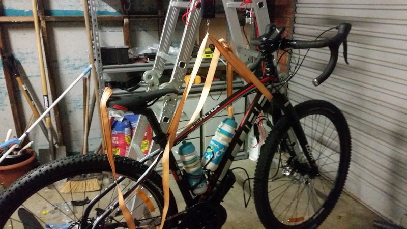

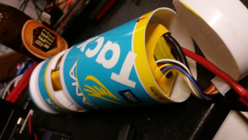

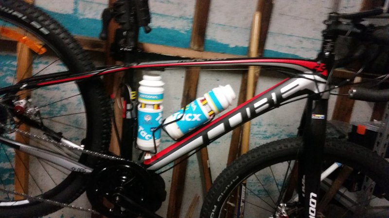

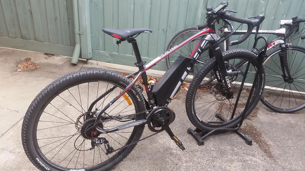

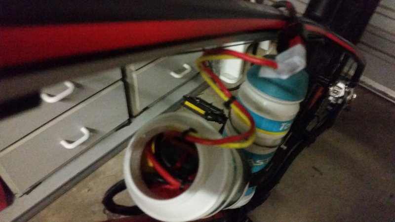

The original plan of hiding the batteries in drink bottles didnt work out(although would have been mad stealth). I actually had it working for a month while testing but I didn't have confidence that the bottle holders were strong/safe enough for holding lipo's. I even tried duct taping the thing down... The weight of the batteries inside the drink bottle kept on moving it around. It was a safety issue... So I went back to a formula I know works well. Metal box out of building frame metal and hose clamps. I'll revisit the water bottle idea later if I have time. The issue was the holder not strapping the water bottle tight. If I had better knowledge of 3d printing, I'd build some custom mounts and make it work.

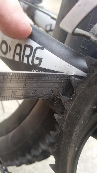

In regards to chainring size, 48t is the biggest I can go on my 29er frame. I assume this is the same for most MTB's as any bigger will foul the chainstays.

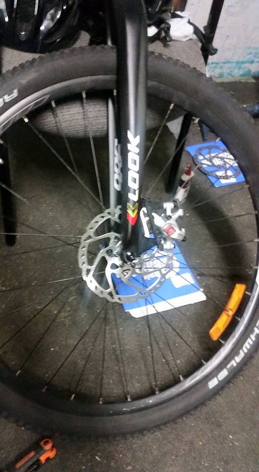

Issues : Avid BB7 Road with post mount adaptor for 180mm disc (front) will foul the actual brake pad. I was wondering why my front brake was making funny sounds until I realised the post mount adaptor is so close to the caliper that the long tab on the brake pad was touching the adaptor... You need to trim it shorter to work well.

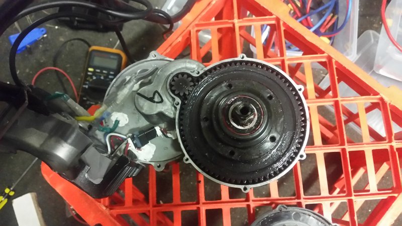

Issues : BBS02 BB creaking. As the BBS02 is only screwed in on 1 side. Over time the BB starts creaking as it comes loose. I've used blue locktite on the thread which has seemed to fix it for a while. time will tell.
Issues : Chainline isnt perfect. Without a front derailleur in place, it had an annoying habbit of jumping chains. I put the front derailleur on even though it is single chainring which solves the issue. Not really an issue. Just something to be aware of.

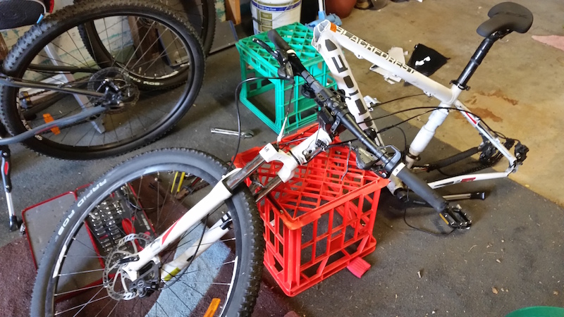

So after the destruction of my last bike (Focus Black Forrest 29er MAC10T 40A build thread here : https://endless-sphere.com/forums/viewtopic.php?f=3&t=58691 ) I've decided to go to drop bars and mid-drive super stealth. As a learning experience, I'm going to build it up myself as well using the spare parts that didnt break from my old Focus 29er.
Old Focus snapped frame (doesnt just buff out =( ) :

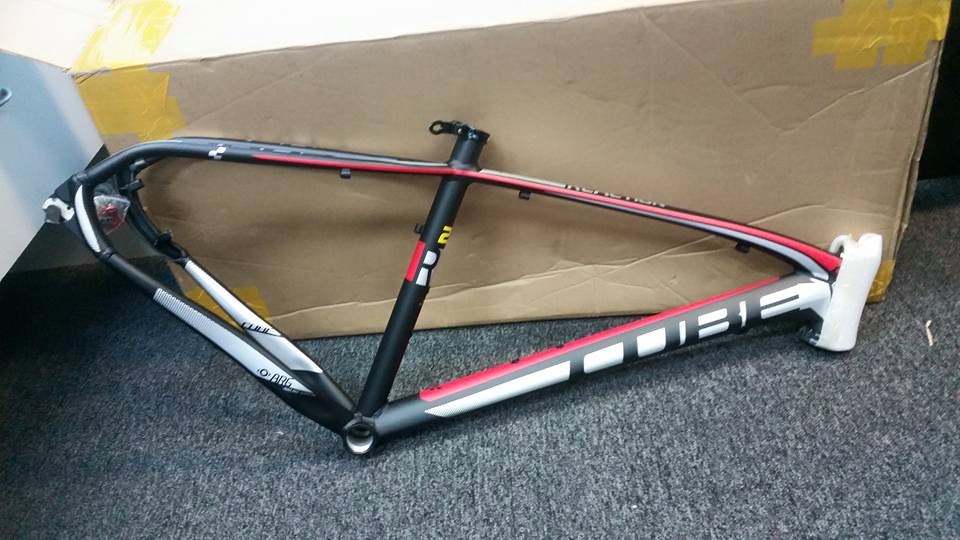

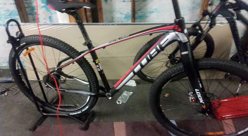

Cube Reaction 29er 17" frame :
Look 986 Carbon rigid 29er fork :

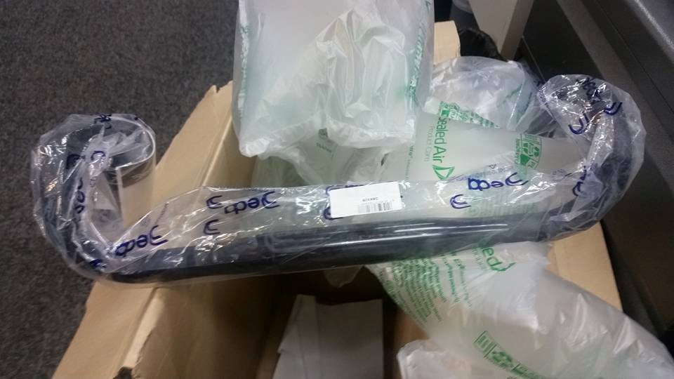

Deda Drop Bar :

Avid BB7 Road calipers (mounted on the fork) :
