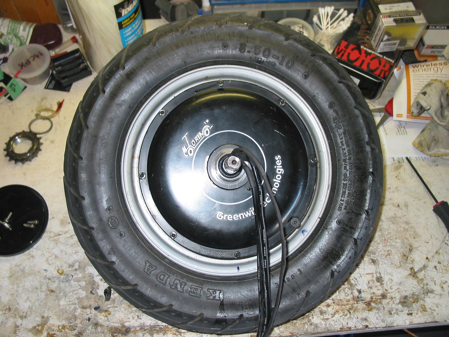

I had trouble with the motor on my scooter recently and after looking at different options, I decided to just go the easy route for now and replace it with the same thing from the dealer. So I have this extra motor lying around in pieces with two magnets that are damaged on it. I'm thinking that it's a good opportunity to learn about this motor and play with it a bit. So what can I do to make this 500 watt motor a little more than what it is right now. Any ideas other then replacing the broken magnets?
I have a few questions here, there's 46 magnets on the rotor/rim and 17 poles per phase on the stator. Isn't the amount of magnets suppose to be the same as the number of poles? Or are they just there to create some magnetic field and it doesn't really matter how many there are? I also noticed that the poles of the magnets are alternating, how is that important? The magnets are 45 mm long by 13.8 mm wide by 3 mm thick. If I was to replace all the magnets with 50 mm long ones, would that make a stronger magnetic field and help the motor? John in CR suggested ventilating like he did in here http://endless-sphere.com/forums/viewtopic.php?f=2&t=39773. This would be a good start but is there anything else that can be done to make this motor more powerfull or efficient or both?

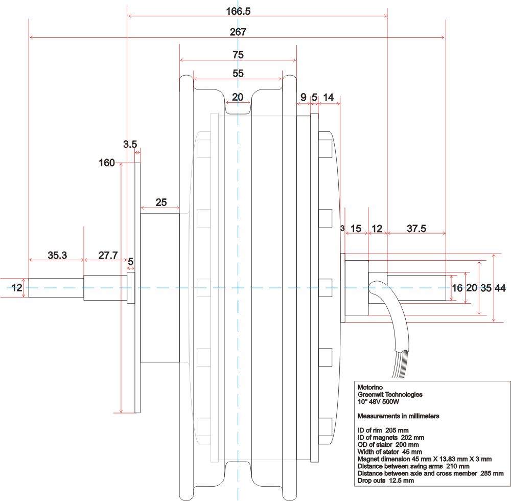

Thanks and here's a few pics and a drawing with dimensions of this project motor.

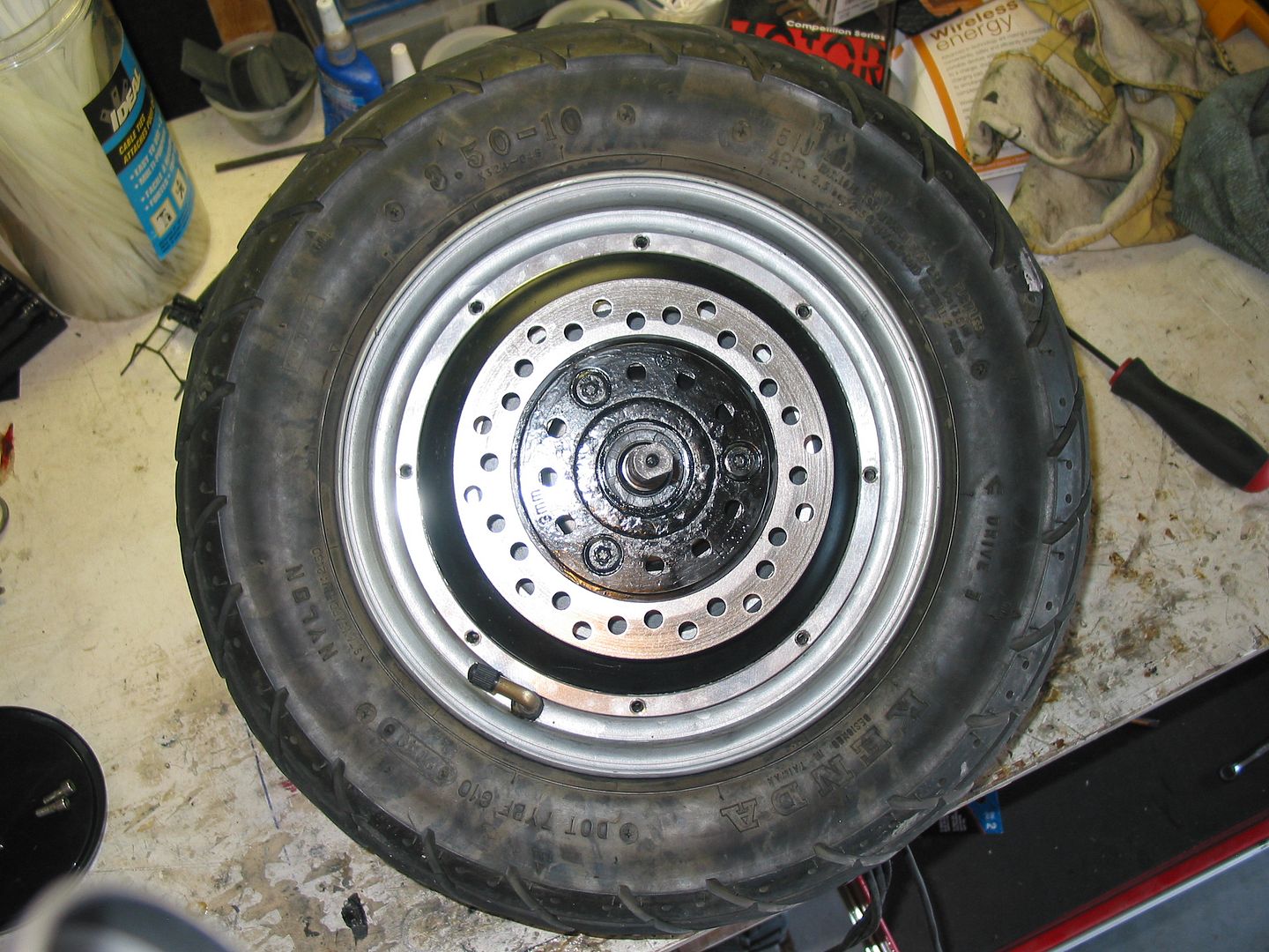

The one way sprocket side
The brake disk side

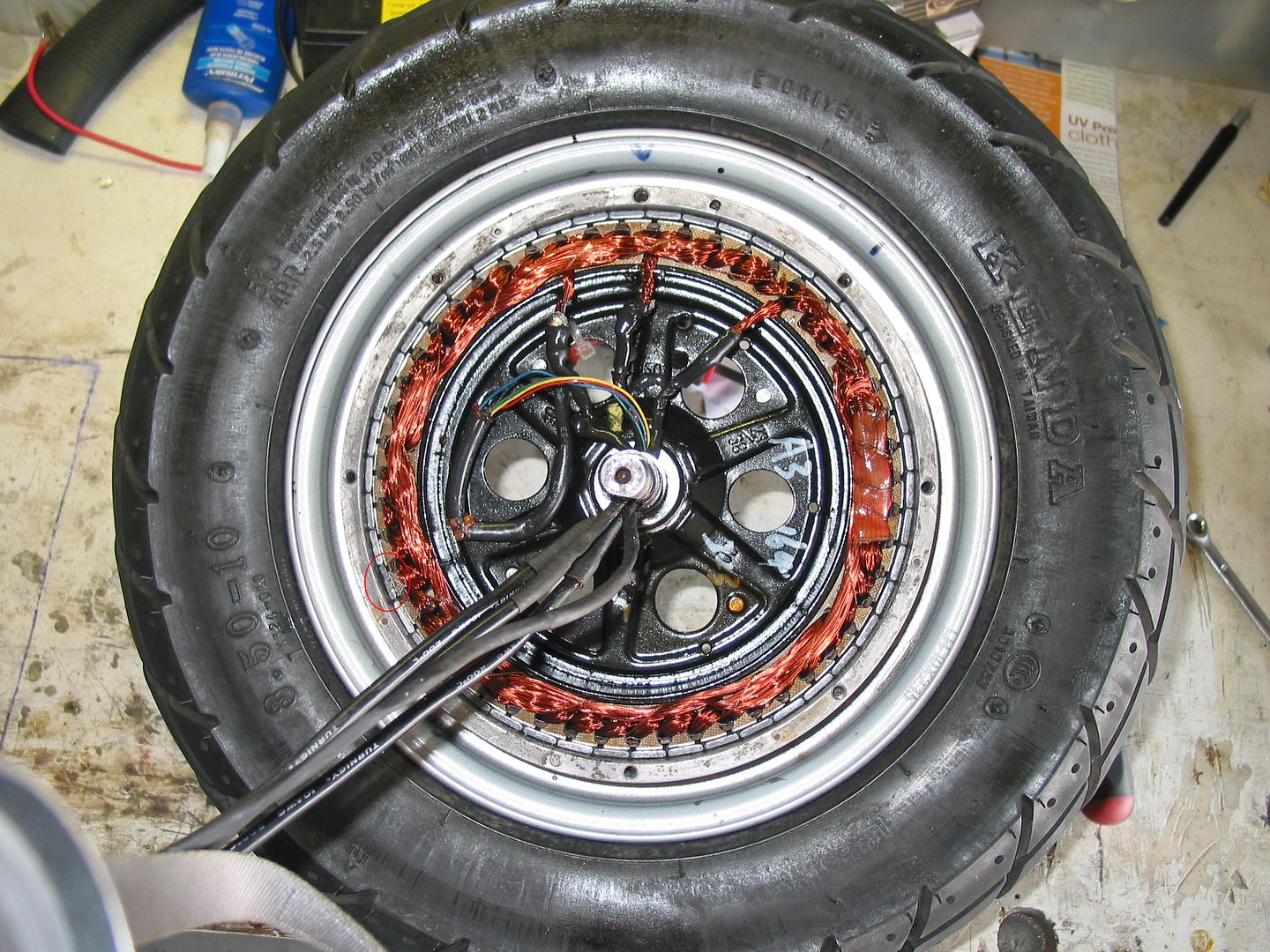

Without the covers

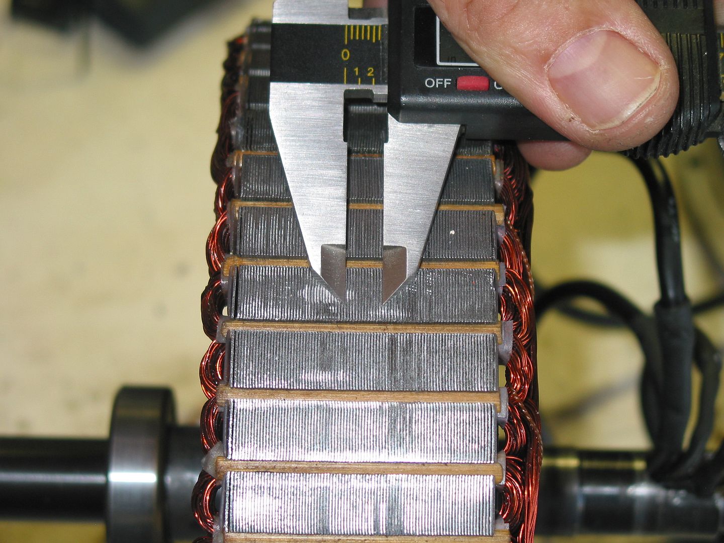

The laminations, the caliper is spread 1/4''. The stator is 45 mm wide

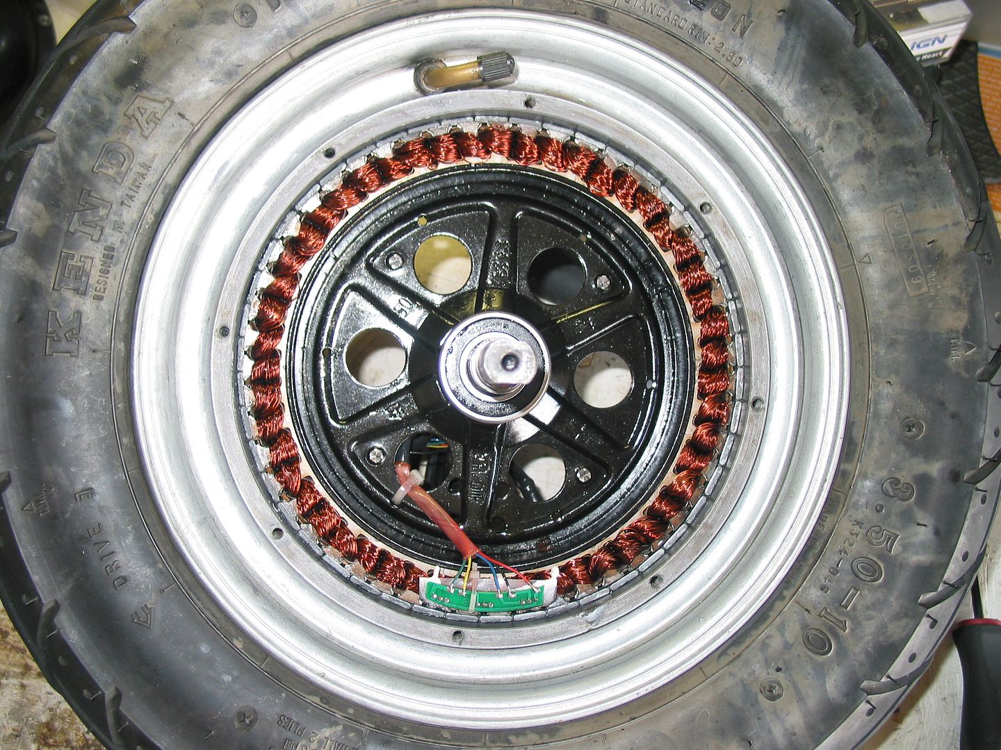

The hall sensors
And a drawing with dimensions

I started doing some stuff to the end caps. 12 holes on the brake disk side around the middle as air intakes and 20 smaller holes on the wire side close to the outer edge for air exhausts. To help the air go inside the intake holes, I thought of fabricating a fan out of a piece of tin that would be behind the brake disk. Anyone here that know something about aerodynamics can tell me if this would work well? :) I'm thinking it might help a little but the wheel doesn't turn that fast so I'm not sure if it's worth the trouble.
EDIT: That fan won't work at all, I didn't think of the brake caliper. I'll have to check if there's a way to make it smaller to clear the caliper but still big enough to move some air.

I finished making a small fan to put behind the brake disk. It moves air :D Not a lot of it but when I make the end cap turn about as fast as it would turn with the scooter going at 45 km/h, I can feel a flow of air twirling around and going on the stator. Some air is better than no air. I received the magnets I ordered to replace the two that were damaged. I couldn't find magnets that were of the exact dimension of 1.75'' X 0.5'' X 0.125''. What I got is 2'' X 0.5'' X 0.125''. Other than being longer they are also a little thinner and a tiny bit thicker but they fit. I'm just wondering if having two magnets that are longer than the others is going to mess up the motor. Also, the magnetism of those new ones seems to be stronger than the old ones.

Work continues to bring this motor back to life and learn a couple things. I took the bearings out, they are actually pretty good bearings but they felt a little dry so I took out the seals, cleaned them with WD40 and repacked them with bearing grease and popped the seals back on. The magnets are positionned on the rotor, I still have to mix some JB Weld and glue them. Here's a pic of the two new magnets.
I put the stator and end caps back on to see how it goes. Smooth as when it was new, the thicker magnets don't touch the poles at all. I drilled the hole in the shaft a little bigger and now I can push three 10 gauge Turnigy wires and the hall sensor wires which are wrapped in a thick heat shrink through the axle. I also Dremeled the holes in the end caps to help scoop the air in and out.
The small fan I made for the intake holes, just three blades to move some air in.
