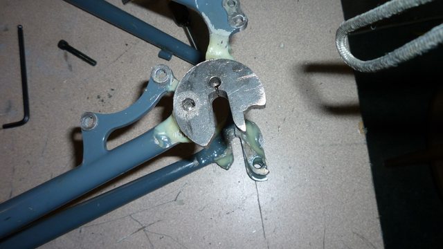

Postby keysersoze310 » Fri Apr 20, 2012 4:34 pm
So I tried removing my rear wheel a few days ago and to my surprise, one of my Doctorbass torque arms fell off! Yes, I used the DP420, but my alignment wasn't particularly good on the one that fell off.
Anyways, while I rethink my torque arm situation, is it safe to ride my bike with only one torque arm at low power (<2kw) ? This would of course be without regen.

Postby Ykick » Fri Apr 20, 2012 4:53 pm
I'm assuming direct drive since you mentioned no regen? I run 9C DD around 2kW with one thin AmpedBikes torque arm secured with sheet steel clamp. No regen and 3k miles later my aluminum dropouts looked absolutely perfect last time 'had the wheel off. No evidence it's even been needed yet. I don't know if I'd trust my setup to a geared hub motor at that power level but for 2807 in 26" wheel, I'm not pulling any wheelies and single torque arm is plenty.
You're probably okay although if one arm came loose the installation of both could be compromised and lacking structural integrity?

Postby ZOMGVTEK » Fri Apr 20, 2012 5:05 pm
I had over 800 miles with a GM at 8kW without any torque arms. Just standard steel dropouts.
I eventually made a single sided torque arm once regen started killing my dropouts. The axle still wiggled its way loose fairly quickly, so I'm not using regen on that bike anymore. This was even with nordlock washers, and tightly shimmed dropouts with no play.
Bottom line, is a properly installed motor appears to be fine without any torque arms. Two friends bikes have no torque arms and GM's at 8kW. Never had a problem.
Long term, it's a good idea to have double sided torque arms. If you use regen, its basically mandatory. One side is better than none, but sloppy.

Postby keysersoze310 » Sat Apr 21, 2012 2:21 pm
Thanks, I'm pretty sure that the torque arm that is still attatched is fine. The one that fell off looked sketchy from the get go, but I was still surprised because I thought DP420 was nearly indestructible.
I'll stick with one torque arm for now while I try to figure out a good torque arm setup that can use regen without my crystalyte axle rocking.

Postby ZOMGVTEK » Sat Apr 21, 2012 10:41 pm
If the DP420 fell off, it must have not adhered. It's probably not the adhesives fault. It's not a mechanical bond, so you need to be absolutely sure BOTH surfaces are clean. Sand them a bit rough, and wipe the surfaces with a solvent, it should hold well. Cure it at higher than ambient temps, with pressure, for best results.

Postby FastDemise » Sun Apr 22, 2012 1:37 am
Funny enough last weekend I found out I had the same problem with my Doc arms using DP420. Changed a flat tire and noticed it laying on the ground. :roll: I used vice grips to apply tight pressure and left it in front of 1500w heater to cure.
Did you just apply to the face of the torque arms? I applied to the inside and a liberal amount on the circumference to give a nice smooth look and help hold it. My guess is my arm was just not quite aligned right and my constant throttle and regen did it's damage.

Postby keysersoze310 » Mon Apr 23, 2012 9:08 pm
Tried pulling the other side off and... pop goes the torque arm.
I even was able to pull out the derailleur hanger than I epoxied in. In other words, my torque arm install was a complete and utter failure. Thank god my stinky's dropouts are apparently pretty strong on their own.
I'm honestly not sure where I went wrong. I followed all of the directions listed above minus the dremel to rough them up, but I did get them rough with a metal file instead. Maybe I should have cured at an even higher temp for a few more hours... oh well.
I think I'm gonna go with the new ebikes.ca torque arms this second time around. They look strong and idiot proof. DP420 and I are apparently not compatible.

Postby ZOMGVTEK » Tue Apr 24, 2012 6:05 pm
izeman wrote:
ZOMGVTEK wrote:If the DP420 fell off, it must have not adhered. It's probably not the adhesives fault. It's not a mechanical bond, so you need to be absolutely sure BOTH surfaces are clean. Sand them a bit rough, and wipe the surfaces with a solvent, it should hold well. Cure it at higher than ambient temps, with pressure, for best results.
would you remove paint before? or just sand the torque arm/plate and sand the paint a bit and glue them together? i have no idea how strong the paint sticks to the metal.
You ABSOLUTELY have to remove the paint. The torque arms need to be metal on metal, with extremely clean and flat surfaces. A little rough texture is perfectly fine, but the torque arm must be flat against the bikes dropouts with sufficient exposed surface area.
If you sand the paint and adhere it to that, your dropouts are as strong as the paint. Paint isnt very strong.
If you're concerned, put a bolt through it, and weld the circumference. If it's not stronger than the stock dropouts, whats the point?

Postby auraslip » Tue Apr 24, 2012 8:49 pm
Not really. The instructions weren't really clear in the thread. Maybe an install guide would be nice.
But just to be clear - you roughed up the drop out with a file. Did you also rough up the torque arm as well? Mind were covered with some sort of corrosion or something. Did you use a solvent? Did you apply pressure as it was curing?
I haven't done the math, but 4200 psi is an awful lot of shear strength. If they're installed good, they should hold. But I haven't done the math. Has anyone?

Postby keysersoze310 » Wed Apr 25, 2012 10:17 am
auraslip wrote: But just to be clear - you roughed up the drop out with a file
Yes
auraslip wrote: Did you also rough up the torque arm as well?
Yes
auraslip wrote: Mind were covered with some sort of corrosion or something.
Mine were too, spent quite a while using my metal file to get rid of all the corrosion on the side I epoxied
auraslip wrote: Did you use a solvent?
Just cleaned it with alchohol
auraslip wrote: Did you apply pressure as it was curing?
Yep, clamped it down hard

Postby psycholist » Wed Apr 25, 2012 5:25 pm
keysersoze310, You had a problem with a very loose fitting axle, resulting in a lot of rocking play in the torque arm and loosening of the axle nuts.
Did you ever resolve this issue? If you continued to ride in this state, something is bound to fail.
The integrity of the doctorbass torque arms require that the axle nuts be tight as well as a snug fit in the (torque arm) dropouts.
What might have occured here, is that you continued to ride with this condition and the loose axle nuts, accompanied by the constant rocking, caused the system to fail at it's weakest link...The epoxy bond.
I'm not implying that you did this. Just a possible scenario :)

Postby auraslip » Wed Apr 25, 2012 5:44 pm
i'd like to think john for making me paranoid. LOL.
What happened was me drilling out the anti-crack hole. I guess it got warm and weakened and the torque from the drill popped it off. You can debate this all you want. I don't think I got it too hot.
Here is the solution I'm working on. Huge pain ;(
