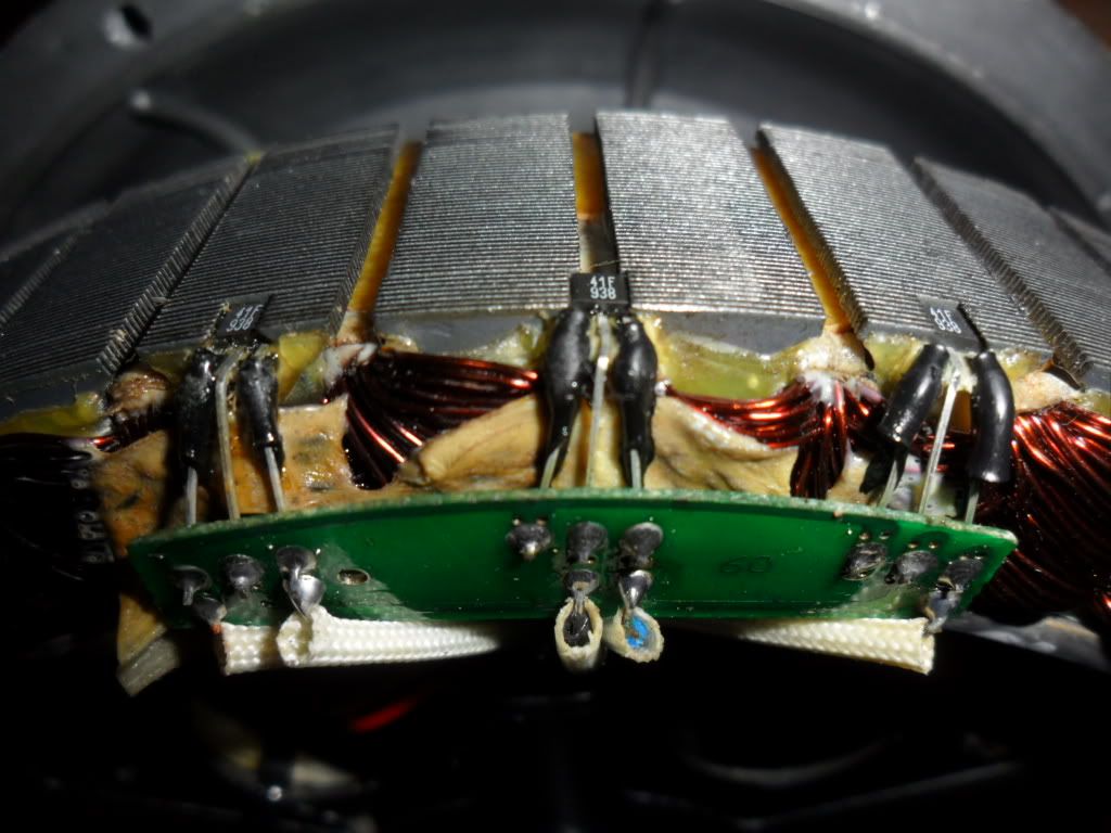

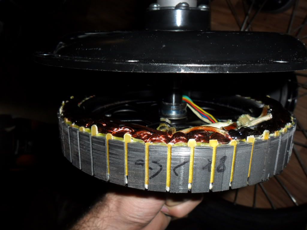

heres some pictures
I rebuilt it and it does not spin freely

too bad there is no info. you swapped out the stock phase wires for larger 12G? did you check continuity on the hall sensor wires after you pushed the new wires inside? if we knew more we could help you. have you measured resistance between each of the wires and the axle itself? is there 5V on the red wire on the halls and is there continuity of the ground from the hall sensor back to the controller? that motor was not hot from looking at the picture so it did not burn up.

It doesn't look like it got hot at all. Check the continuity/resistance of each hall wire from outside the axle, to the green board. Also check the continuity/resistance of the phases from outside the axle to where they attach to the windings. It should shed some light on things.

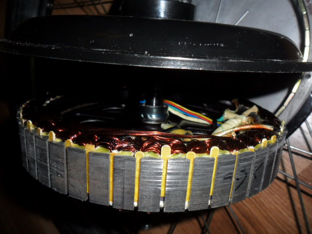

These pieces of plastic/wood should be pushed in flush with the stator, they could be touching the cover.

the plastic things pulled out after the run... they cannot be pushed down anymore... I dont know how

cut them off with dikes then. man that is the problem. i noticed that too, but did not put two and two together. good catch moloki. they are hitting the ribs on the inside of the cover. that's what makes them sing.
