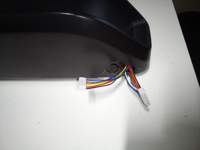

Cowardlyduck said:
I'm close to finishing off my battery...hopefully this weekend. :)
Nice! I have not used BMS too, just 2 7S balance leads outside.
Once I'm done the battery I can start testing out the difference my 3D printed sprocket cover makes. I'm hopeful it will help a lot.
I really hope you will succeed. Fingers crossed.
