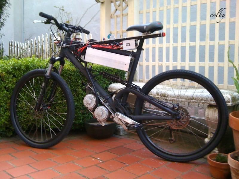

Postby colby » Mon Jan 18, 2010 3:30 am
this is the 2nd bike (2009) i built: EB2
4 36v bat836 (soon too be 6. 264a peak)
2 35a controllers (soon too be 1 100a kelly)
2 24v 450w MY1018Z
3 gears on motor side (18-35)
1 speed on crank
50lb

Postby bzhwindtalker » Mon Jan 18, 2010 10:38 am
cool bikes! I like the bar you placed under the seat, it breaks the bicycle look :D

Postby Microbatman » Mon Jan 18, 2010 9:38 pm
Colby
Nice work.
What bike brand is the EB2? Specifically what/who made the frame. Is the frame aluminum or steel?

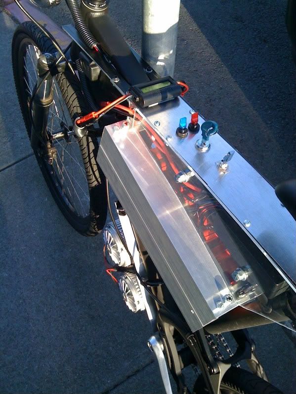

Postby StudEbiker » Mon Jan 18, 2010 9:42 pm
Colby, nice bikes. Can you post a pic of the "control panel" on EB2. I love rocker switches and stuff like that. Please show us the set up. Thanks!

Postby colby » Tue Jan 19, 2010 6:47 am
thanks guys!
i really appreciate it.
yeah, they turned out well considering my limited tools and space (hacksaw and a power hand drill) the bracket is kind of my signature for my bikes :) it definitely has more purpose on the EB1.
i really liked the EB1, but i built the EB2 because i wanted something safer and lighter at higher speeds and have the ability to shift the motors.
the EB1 was heavy as hell and every time you would hit a pothole you thought you might die :shock:
EB2 is a 2006 giant pistol 1 with aluminum frame. great bike. hayes hydraulic disc brakes, fox rear shock, etc. here's a link about it:
http://www.mtbr.com/cat/older-categorie ... 76crx.aspx

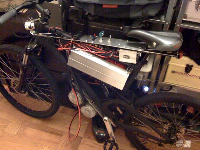

here's a couple more pics.
charging.
controls:
watt meter
blue=headlight
red=taillight
key=controllers on/off
silver=battery on/off
changes to come:
24" rims with 2.5 hookworms
new custom bracket/battery box and home made seat (kind of like a dirtbike seat)
kelly 100 amp controller...and if the motors die after proper cooling and gearing. maybe a etek/mars or possibly rc. the motors should be fine though (short 4kw bursts with very low gearing) will see though :|
2 more bosch fat packs (in the mail right now)
thanks for looking :)
think I'll start a separate thread for this :wink:
