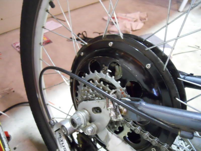

when you drilled the cover, did you drill from the inside and center the holes between the ribs?
maybe there is someone who can run a structural analysis program on the cover with holes drilled out, how to orient them to minimize loss of strength and maybe reconsider the idea of using one large hole versus say 3 smaller holes with one closer to the center and two on the outer edge of the cover in that radius-ed section, or even maybe make a small stencil and mark a section oriented between the ribs in a more trapezoidal section, on the outside between the ribs, then dremel out around the perimeter of that stencil.
maybe then the centrifugal force of the air entrained by the rotating cover would raise the lateral flow rate across the edge of the stator. maybe even add some little ribs of aluminum attached to the steel part of the stator under the winding with J-B Weld would force the air to flow radially across the stator sides. make sure you coat the hall sensors with a buncha sealant like rtv or silicone rubber.

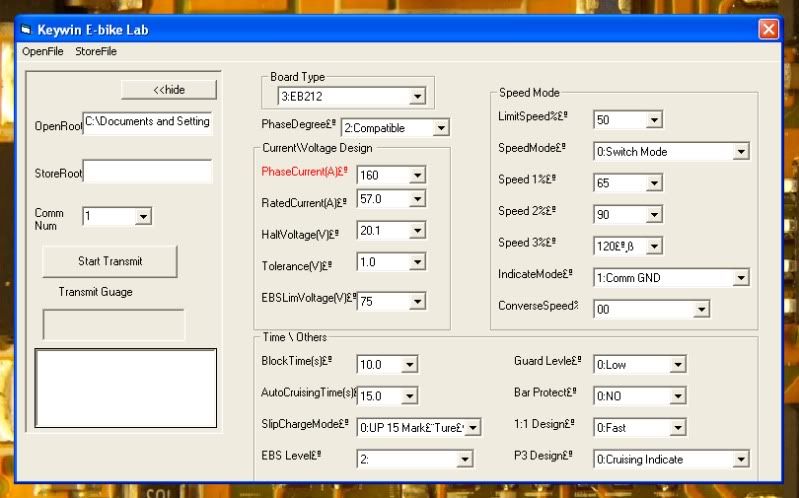

These are my current settings - Ihave my phase current at 2.5x the rated current.
I'll try maxing out the block time...
When I drilled my holes I drilled from the inside. I made a template out of a baseball card that fit in between the ribs and I marked my holes with that.
I'll coat my halls,,, Never thought of doing that.

Postby Metallover » Sat Jun 05, 2010 5:18 pm

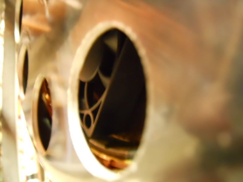

I just got back inside from lots of testing. I ended up putting the fan inside the motor and running it off of one 6s lipo. It was pretty loud and it didn't burn up! The exciting thing is that I had LOTS of trouble trying to get the motor up to the 95*C buzzer. I blasted though town at 35+mph, went up a mega hill maintaining 32mph, and only near the end of my ride did the buzzer go off.
I improved my top speed! With the 3-speed switch settings, I set one to 120%. I was able to go from about 38mph to 41mph on a smooth flat road. :D I also beat my speed record; Now it's 46.9! I was going down my mega hill..
I played with the block settings for awhile and I really didn't feel a difference. It's at 10 right now, but I think I'll change it back down to 4 or 5 because that is what I've seen other people using.
I tried to get more power constantly, and I ended up with only 31.51a and 2133w. The bike felt faster then before but it wasn't anything amazing. I did this by raising the max current from 40a to 57a. Both the phase current and rated current are maxed out. If anyone is running a 9c and making over 2500w, please let me know what settings you are running. A screenshot would be great. This is what I have ATM

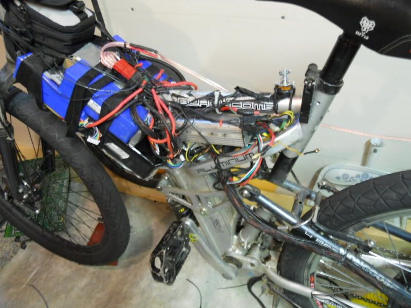

I took some more pictures too
Here is how I have my fan. It's a 12v fan overvolted to about 24v. :)
I couldn't fit the wires through the axle, so I dremeled a small slot in the axle and made the wires come out crystalyte style. 8)
Here's a shot of the other side of the motor. JRH, please explain to me what you mean,, Should I attach cooling fins to my motor?
And I'm open for compliments on my clean wiring! :mrgreen:
One problem I may have is a little rear axle play. When I hit the regen I can feel the axle shift. Maybe I should try to shim my torque arms a little more?

The jacking you feel may be play in the shock mount.
Make one side have all externally scooping holes, put a little angle to them. Then the other should be venting holes, reverse angled to scoop from the inside. It should pull air through the motor in one direction when it spools up. Basically, make the side covers like fan blades.

Best bet... set block time to 1, tweak your phase current to be a lower multiple of the primary current (try 1.5x for instance or 1:1 if you want to see true MAXIMUM TOP END)... when you have the top speed you want while you and all your weight are onboard (this means sufficient power to acheive max velocity) then you just bump that to 4 or 8 or whatever, the purpose is to give you less limiting for more low end launchign torque... once your moving it's like a passing burst, that is if your motor is capable of using the additional current.

What material should I use? What adhesive should I use to attach them?
A powerade cap fits over the holes, maybe I could modify them to scoop more air...

Postby Metallover » Sun Jun 06, 2010 2:33 pm
Well, these are the settings I ended up with. I tried your method Mike, but it was really slow accelerating at 1x and 1.5x phase current. It accelerates very fast at this setting. I pulled a max of 26.43a and I made 1922w. This is respectable, but I still want more. :twisted:
During testing, I looked at my watt meter and it said I pulled 39a and 2750w! :shock: At the same time I noticed that one of the six lipos had come unplugged. It was the pack paralleled with the pack I had my watt meter on. If someone can explain this please go ahead. :?: :?:
And here is a shot of my bike at the top of a hill. This is in a state park. Usually my motor will overheat and I need to slow down and stop. With the cooling holes and fan, I went up the hill faster than I ever have and I never needed to stop. :D
I have looked at a lot of threads, and I have seen people beef up their traces and shunts. Would those mods give me more power? Would they un-calibrate the software?

Postby Hyena » Sun Jun 06, 2010 10:04 pm
Why is your speed limit set to 35 and 50? I'd be bumping that up to 99 and seeing if that makes any difference.
Failing that it's probably your shunt. Is it a lyen 12 fet controller that's supposed to be a higher powered one ? Add another shunt or solder a few fine strands of copper across it and your current should jump alot.
I'm surprised you're managing to heat it up so much with those big holes and only 30 odd amps. Something doesn't sound right...
Your holes are also bordering on too big, I'd be a bit worried about them being able to take the load if you're doing alot of hard offroading...

Postby Metallover » Mon Jun 07, 2010 3:55 pm
This is how I have my packs set up. I would hook the watt meter up to the entire pack, but I don't think it can handle a fresh 75v, can it?
If the watt meter reads 26a, 1900w,, Does that mean that I am pulling 26a and 3800w throughout the entire pack?

Postby Hyena » Mon Jun 07, 2010 6:18 pm
OK yeah taht's not a good way to do it. I have mine set on my Norco to only measure one 6S group and as Mike said it makes your power and voltage inaccurate but most importantly (to me) the current and Ah IS correct (and I multiply wattage and voltage x 3 for true pack values) Mind you that's a 6S2P group - you're only looking at one individual pack the way you have it set up there.
You need to wire it like this:

Postby Metallover » Mon Jun 07, 2010 7:21 pm
I have been multiplying the wattage by 3 to get the total power.. Do I need to multiply that by two? Ehh, I'll do a little soldering work and then I'll see what data the lil thing puts out.... Or maybe I'll just wait until I get my CA...

Postby johnrobholmes » Mon Jun 07, 2010 11:29 pm
The amperage is off by a factor of two. You will need to monitor the overall pack voltage in a different way, or loosely multiply by three. So you may be running six times the power that you think you are :lol:

Postby mwkeefer » Tue Jun 08, 2010 5:29 am
Which meter is that? The Turnigy Branded, back lit units work on 18S hot (70v+) but... I smoked a watts up, though I think perhaps it was on 20S and not 18.
To calculate AH used (you do have cell monitoring right?) it would be AmpHours * 3 (as you have it hooked in your diagram) - when connecting the entire 6S subpack part - don't multiply by 3 as you are already getting the right Current now just multiply the voltage * 3 and then the current and voltage together to get true watts..
Based on your diagram, yep your pulling
18S Hot Maximum is 75.6v - I only charge to 4.16/4.18 depending but I've never had issues with the Turnigy Watt Meters at 18S.
Oh and they only ever show 66.4v maximum - maybe time for a CA or another Watt Meter... monitor 12S2P with one and 6S2P with the other... you will get real fast at adding big numbers in your head while riding :)

Postby Hyena » Tue Jun 08, 2010 6:55 am
mwkeefer wrote:To calculate AH used (you do have cell monitoring right?) it would be AmpHours * 3 (as you have it hooked in your diagram)
Actually the way he has it hooked now would probably be ah * 2 although I'm not sure how totally accurate it'd be.
If he wires it like I showed above his Ah will be correct but the voltage and wattage will only correspond to 1 6S bank.
You dont really need to see the whole pack voltage anyway, as you said as long as you have some sort of cell level protection/warning monitoring a single 6S sub pack is fine - the current is accurate, the Ah is accurate and you get used to basing your usage and approximating distance to LVC looking at 6S voltages (assuming you just glance down and don't look for the ah reading )

Postby Metallover » Tue Jun 08, 2010 10:55 am
I held my breath and hooked up my turnigy watt meter up to my entier 18s pack....
Then I went for a ride....
:D :D :D :D
When I had my watt meter hooked up to just one pack, the meter read 640.9w. I multiplied it by 3 and got 1922w. I should have multiplied it by 6 and I would have gotten 3884w.
