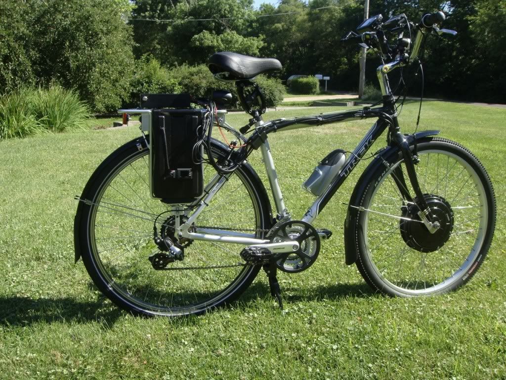

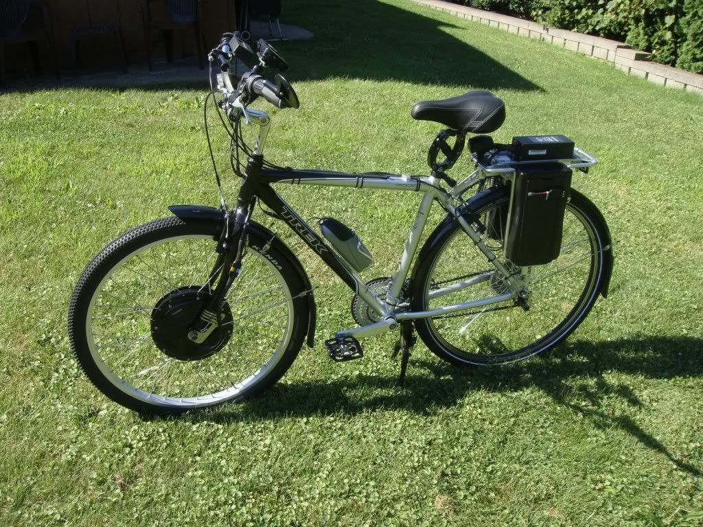

Hello all. With the help from members here, and with countless hours reading and studying this forum, I am pleased to have completed my first electric bike build. My 1st ever e-bike was a Currie E-Zip, which I used for 2 years. But as I get older, I get heavier :( , and it was time for me to get a more powerful bike. After shopping around, I figured out that for me and my size, 6'-1" 220lbs, I was going to have to build one myself to get it right.
This forum gave me the information and motivation to make this bike, which I have named "The Falcon".
Most of the tech information is in my signature already, so I won't repeat all that. The battery packs are in the hard sided panniers which I had on the E-zip, and the controller is inside the rear trunk.
So, let's get to the photos, eh?
Here she is with the Croozer cargo trailer. With that 5303 I don't even notice the trailer behind the bike.

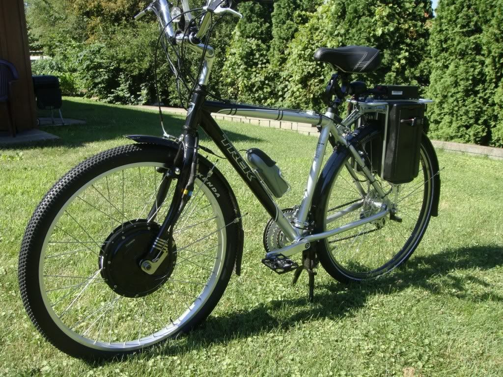

Postby The Journey Guy » Fri May 14, 2010 6:42 pm
And yet more photos:
Just some random guy who happened by and offered to model the bike.... :roll:
What a ham!
End of another day's ride....

Postby drewdiller » Fri May 14, 2010 7:54 pm
Nice!
Heh, a setup that will haul ass at hauling cargo.
Did you do the shrink tubing on the Y/G/B Anderson connectors at the front fork? If so, what gauge tubing?

Postby The Journey Guy » Sat May 15, 2010 7:45 am
drewdiller wrote:Nice!
Thanks!! Yep, I did the Andersons, and used 1" Shrink tubing to cover the 3 connectors side by side. Just barely fits.

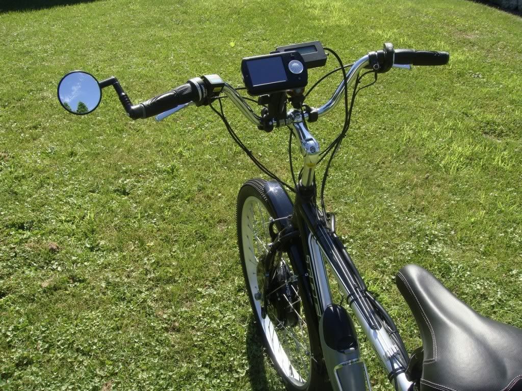

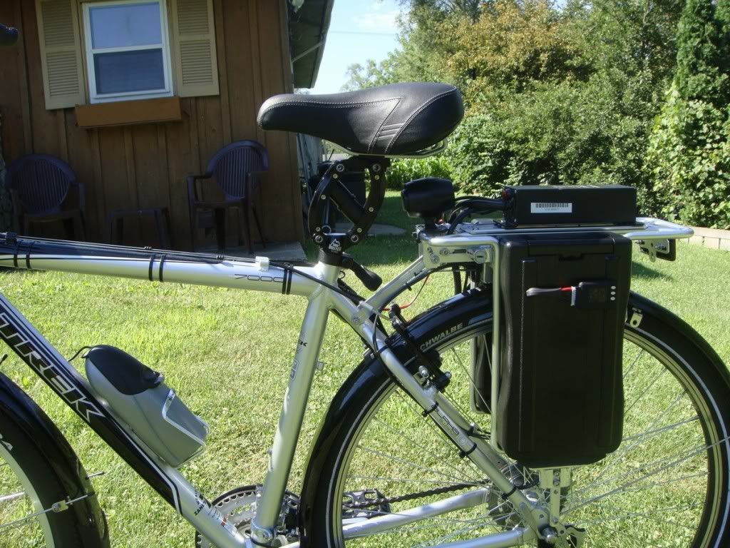

Postby The Journey Guy » Sat Jul 03, 2010 10:50 am
I've finally recovered from my operations enough to go bike riding this morning. I took the opportunity to get some new photos of 'The Falcon' in it's Version 2 configuration. I removed the rear hard side panniers, the rear trunk, and the rack that I was using in the original build.
I am now running a rear rack from Currie that the E-zip and I-zips used to use. I got a hold of 4 empty battery cases that those bikes use, and have made them into 24v10ah Headway packs now. One on each side, run in series for a total of 48V10ah. That will give me more than enough range for my Mon - Fri commuting to and from work. I have two extra packs that I can carry in the trailer on weekends when I go out for my long rides.
This Revision 2 has saved me aprox 15lbs at the rear of the bike. Much easier to handle now, and just as much power as when I was running the Ping packs, which weighed twice as much as the Headway packs do.
The Thudbuster has proven to be all it's advertised! Like riding on a cushion, the difference is day and night. For anyone who has a hard tail bike, I would suggest you try one out. I think you'd use one from then on, they are that good!
On to the photos:

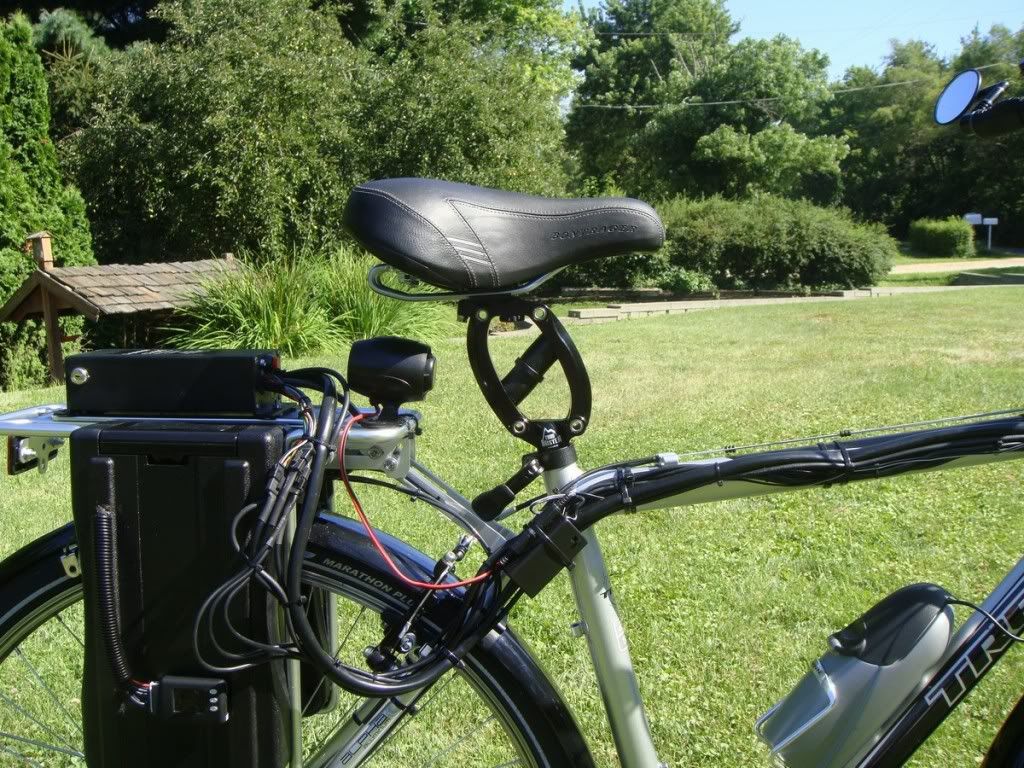

Looks less bulky at the back of the bike now. I'm not too happy with the way the wiring is just sort of hanging there. If anyone has any suggestions on how to hide them better, I'd be pleased to hear your ideas. :)

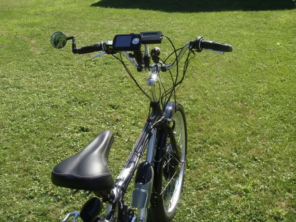

The new mounting system for the CA and my GPS/Stereo player. They are easier to read and reach to control while riding.
Still a fairly clean build, IMHO.
As I said, the Thudbuster is fantastic! Everyone should have one.
Yep, I sure need to figure out a better way to route/hide the wiring. Suggestions are welcome! :lol:

Postby torker » Sat Jul 03, 2010 6:15 pm
That looks good. The wiring would have to be trimmed to the same length first which would mean reterminating a lot of connectors. I like the woven nylon covering that is like a Chinese finger trap. You push it together and it opens up and then when you loom everything up you pull it to compress and ziptie it in place. I cheated on my recumbent and coiled my extra wire and added a sheet metal cover on one side and coroplast on the other. :mrgreen:

Postby The Journey Guy » Sat Jul 03, 2010 6:47 pm
That's a good idea about the finger trap stuff. I wouldn't know where to get any, but you did give me another idea! I have some shrink tubing that is about 2" in diameter. I could cut a piece to length, and then cut it up the side to open it up. Then wrap the stuff around all those wires, zip tie the outside, and then hit it with the heat gun.
Almost the same concept you had. Thanks!!

Postby amberwolf » Sat Jul 03, 2010 7:15 pm
Probably any place that sells cable-making supplies would have the woven wrap. Especially places that do custom work for PC mods and car stereos.
Another thing that works well and is cheap is the ribbed pre-split cable housing used in car wiring harnesses. Same places ought to have that, as well as automotive stores; I remember that network cabling stores used to carry it around here, too, years back when I did that sort of work (when it used to be a mysterious thing the average person was afraid of doing themselves and would pay others to do for them).
Heavier duty versions of it in larger sizes and brighter colors are also used for underground fiber-optic bundles; I used to have a few several-foot-long sections of 2"-wide dayglo orange ribbed split housing, but I have no idea where they are now. If I did, they'd already be on CrazyBike2 covering the wiring *and* the bike frame. :lol:

Postby The Journey Guy » Sat Jul 03, 2010 7:20 pm
Yep, I like that stuff too. If you look close at the last photo, you'll see that I used some smaller diameter wire loom on the balance plug that comes out of the battery pack.
I just don't have any that is big enough to hide all the wires going to the controller.

Postby ambroseliao » Sat Jul 03, 2010 9:53 pm
I recently found the stuff here.
http://www.parts-express.com/wizards/se ... ID=2524701
It's called "Split Loom Tubing".

Postby The Journey Guy » Sun Jul 04, 2010 4:56 am
Thanks for the links, Ambrose. Those cable pants have me stumped tho. Never seen 'em, and can't quite figure out what someone would do with 'em. :?
TJG

Postby LI-ghtcycle » Sun Jul 11, 2010 10:06 am
Very Clean! And I must say, very beefy tires too, if I didn't know better I would think those were 26" tires! 8)
