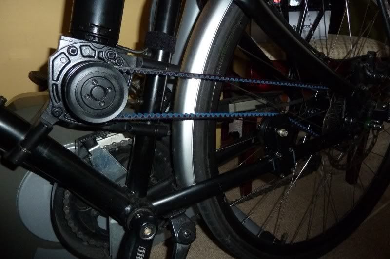

I would like to share with you my experience from my e-bike build (I started experiments january2010).
My first goal was build city commute e-bike (work-home, and a little around), with relatively light weight drive. Top speed about 20-22MPH, and 20 miles range.
For my project I took my 700cc wheel bike with Shimano Alfine SGS500 Disc brake 8-spd Internal Hub
I picked motor Hacker A60-18L 150kV due to low gear ratio needs, and I planned to run this on 6S LiPo 22.2V because I try to stay close to legal requirements with is 750W and 20MPH. I estimated if Hacker rated this motor with 45A constant current it shouldn’t develop more than 1000W at 22.2V. Minus energy lost about 10-15% on gearbox and minus another 10-20% on chain, it stay about 810 – 680 W delivered to rear wheel. (But later turn out my estimation was so wrong). With this I decided go to angle grinder gear box Bosch rated as 2HP. So I ordered new set: Gear crown and pinion. Next fabricate gearbox at my work. Small pinion was placed directly on motor shaft. Everything works in oil bath.
I used ESC CC Mamba Monster form my RC car E-max.
Speed was regulated by Turnigy servo tester, battery also from my RC car 10Ah 6S LiPo
Than I did quick assembly, and had first test run.
First; max. speed turn out to be 24MPH, (for calculation I used nominal 3.7V per cell, but fresh charged is ~4,2V)
Second; power close to 2000W during acceleration :shock: (whooooaaaaa!!!)
100A current just amazed me, I thought that, impedance at half of max voltage should not let reach so high current. What else interesting is, even though motor is rated for 65A max. @15 seconds current, at 100Amps (during very often acceleration on NYC streets) never got hotter than 65°C - this just make me happy.
So I was wondering what is going to break first. After 80 miles of run, motor shaft snap, and small pinion was worn out about 30-40%. There was no sense to fix this.
During these 80 miles I realized that, I need stronger breaks at the front wheel, so switching from 160mm to 203mm was necessary.
One more thing, it might be big rain of criticism on my head, but I realize that active safety wasn’t on right level. My e-bike was to slow to flow with traffic, an especially on switching lines for left turns. Thereafter I kept in mind to build 7S Battery when that time will come.
I decided to make new stronger gear box. I calculate torque and this Time Dewalt grinder rated 5,3HP was able to handle that. I mount small pinion on bearings independently from motor shaft, and like previously gearbox filled with oil for long life. Total ratio is 10,5:1.
Right after I build new battery pack using LiMnNi Rechargeable 26650 Cell: 3.7V 4Ah, rated – 10A continuous max. Discharging current. I pick cylinder shaped battery because are more resistant to vibration and unfortunately my bike have no rear suspension. I build 7S10P pack, over 1KWh. This gave me about 30 - 35 miles range @27MPH (NYC a lot accelerations and stops). And of course I had to buy new ESC capable handle higher voltage – CC Phoenix Ice 100. Now top speed and acceleration is very satisfying.
Some pics of my battery pack:
On new gearbox and new battery so far I have done over 600 miles and I realize that chain must be replaced with belt because:
1. Noise
2. Nonstop dirty pence or leg and bike
3. No effective breaks on rear wheel after every chain lubrication
I bought small pulley POLY CHAIN TIMING PULLEY 8MX-22S-12 and fabricate rear pulley 50 toth.
O new belt I have done 35 miles so far and looks like going to works fine.
If I do some modifications, or error come out I will write about this.

I used Turnigy servo tester. I removed original 10Kohm potentiometer and connected directly Magura E Bike Electric Scooter Twist Throttle 0-5K Ohms, and so far works god.

Yes it's kind of... But sound is very soft (due to rpm are ~ 6 times smaller than original tool rpm.) It’s used to be worse with chain, but now with belt is kind of nice and quiet.

I am metal worker. I make custom furniture from brass, stanley steel, aluminum ect.
The thing is I make them from blueprints to final product, so I have to be everything: milling machine operator, turner, TIG welder.

36V yes I wish, but bicycle without full suspension at speed over 30mph just scares me.

Like you noticed I did this the same way like chain and belt is just 12mm wide. I bought the smallest available pulley – 22 tooth (the closest to old free wheel) the closest belt length to the chain and calculate what maximum pulley I can fit on rear. Unfortunately this change my ratio by 10% down, and I thought bike will be faster, but is not, and this also affect my total range from 30-35 to 25-30 miles. Before I had stabile 27mph on flat road after full charging, now sometimes is 25 sometimes is 29 – conclusion: motor is over loaded. Now I am getting ready to make custom pulley 21 tooth even though Gates do not recommend that for their belts, and new one 51 toot for rear to have exactly ratio I use to have.

I used hardened screw for shaft
and few more
this rectangle no the bottom gearbox it's magnet to attract unwanted particles.
spinningmagnets wrote:You mentioned excessive wear on the right-angle drive pinion, what type of lube were you using in the gear-box?
I really like how you attached the belt-pulley to the rear brake disk, very clever and helpful...
I do not know :oops: , I got this oil from someone, i grab from my shelf and feel up gear box. I thought oil is oil this bike is not a rocket... it wont fly to the moon ... :lol: :lol:
But for my second gearbox I did my homework an now I am using: Mobil SHC 634 (ISO VG 460)
This one is for low rpm and high loaded gears.

slawek wrote:this rectangle no the bottom gearbox it's magnet to attract unwanted particles.
That's genius...I dunno how many gearboxes in various equipment I've seen trashed just because some little bit of metal ground or flaked off a gear, then began chewing up another gear, then all those pieces chewed some more.... :( That magnet might've saved them (assuming an oil bath for the bits to float downward in, isntead of jelly-like grease).

Genius solution ...to use that hardened shoulder screw with a modified head , for the motor shaft & drive coupling ! :o
