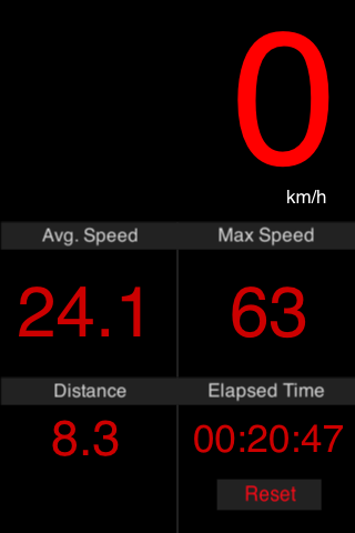

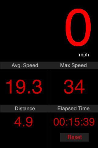

Postby snellemin » Mon May 02, 2011 11:30 pm
I received Lyen 12fet sensorless controller today and tested it out. I'm at 18s Lipo now and did a test run at 31mph. I'mthe same ebay motor and same dinky thin wires with 4mm bullets. I blew up my eagletree in the process. But I verified the speed with my Iphone GPS. 31 Mph on a bicycle is stupid fast and scary. Acceleration is much quicker now and just couldn't stop grinnin'.
update:
Went 34mph. Peaked at 3600W and only used 2000mah to my commute to work this morning. Got to love HV setups.

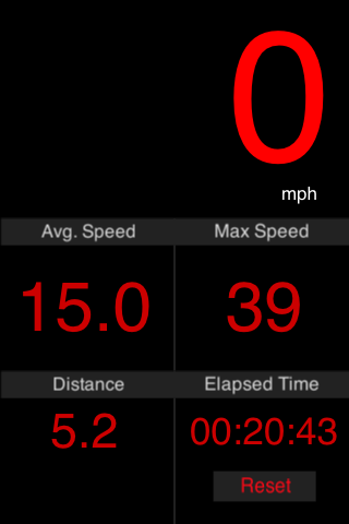

Postby snellemin » Tue May 24, 2011 7:26 am
Yup that is why I blew it up. I used the 70V version instead of the 80v version.
oh, and I eaked out 39mph with fully charged 22s lipo.
