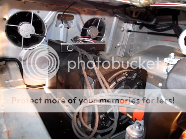

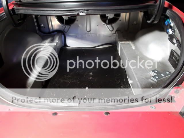

Did some work today worthy of a minor update. First of all, the current-controlled charging system works, but needs to be tweaked to make sure it's set to the right maximum excitation voltage. I'll do that part tomorrow. For now, here's the test hookup in the trunk:
That's essentially the same setup as in the schematic I posted a few weeks ago, except that I went to the DC side with a hall effect transducer. The upside is that it's receiving a much less noisy signal than the AC side of the rectifier would have provided, but the downside is that it required the 24 V supply to run it. I use the 0-5 V signal that it provides, which floats relative to the motor controller's supply, to "throttle" the motor controller's current supply to the exciter winding on the generator head. I tested it, and the charging current now never exceeds 30 A DC. I have to program the controller for its maximum supply voltage to make sure that maximum excitation is exactly right. Again, that's a job for tomorrow.
The main job of the day was to get cooling set up for the trunk. Both the gen head and the engine are air cooled, and that little space will get hot unless it's actively ventilated. I'm not sure if I ever posted a photo of the area behind the seats, so here's one with some labels:
The idea is to use these two 600 scfm fans. I estimate that they'll turn over the trunk air volume twice every three seconds or so with cool air from the cabin, which should work well. They only pull about 80 W each.
The problem is that the blades are about 8.5 inches in diameter, so I had to use a large hole saw with an arbor. The drill needed to be one with a half inch chuck, so I got this beast. Today, it had the last laugh.
Here are the pilot holes and the finished holes.

Postby paultrafalgar » Tue Apr 05, 2011 2:41 am
Hey Jason,
You should have put those fans on the back side of the boot(trunk). Then instead of sucking the back seat passengers into the trunk you would have had electric jet-assist! :D
If we knew what it was we were doing, it would not be called research, would it? Albert Einstein

Postby JCG » Tue Apr 05, 2011 8:36 am
paultrafalgar wrote:Hey Jason,
Now you're talking, Paul. I was thinking with the fans, LEDs on the dashboard, etc. that I might as well finish what Doc Brown started... let me know if you have an extra Mr. Fusion!

Postby TylerDurden » Tue Apr 05, 2011 9:01 am
Those fans are a hoot. :D
I would suggest radials tho, good flow, less noise.

Postby JCG » Wed Apr 06, 2011 1:06 pm
TylerDurden wrote:Those fans are a hoot. :D I would suggest radials tho, good flow, less noise.
Hey TD, good to hear from you. I had considered radials, but couldn't get the flow rate I needed in a small package. As long as you can keep the pressure drop relatively low, axial fans are the way to go for high flow rates, although they are a bit more noisy.
Weird thing is, and maybe this is common, but the fans sound a lot noisier (more of a hum) on the video than they did in person. I think that the camera mic is more sensitive than the human eardrum for those frequencies...
Cleared out the wiring, etc. from the trunk (boot!) and have put down a rubber liner on its floor. Chris and I will try to cram the genset inside tonight using the hoist and a bit of elbow grease.

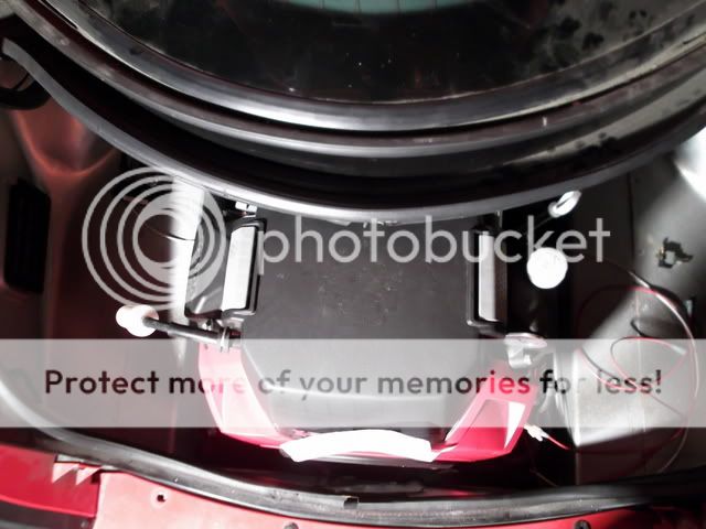

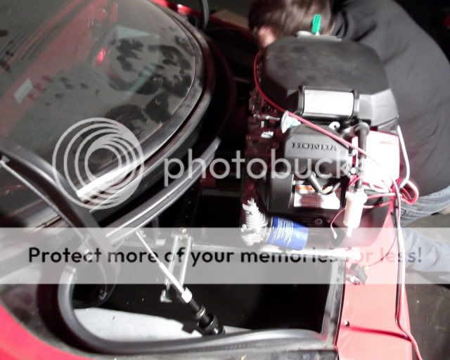

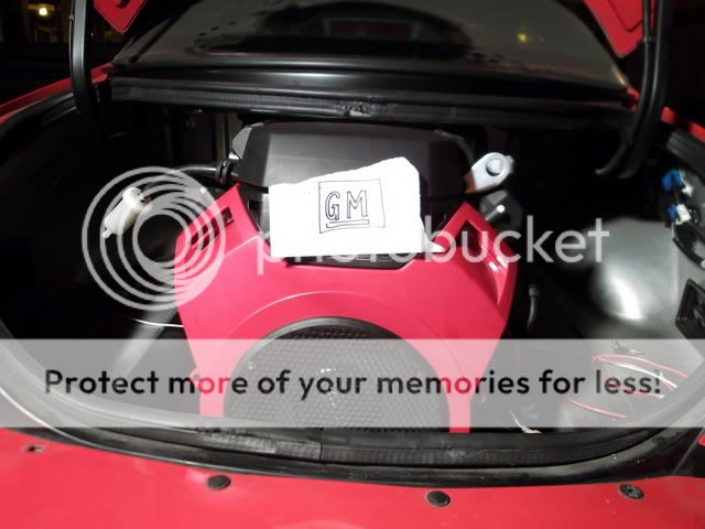

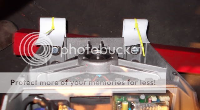

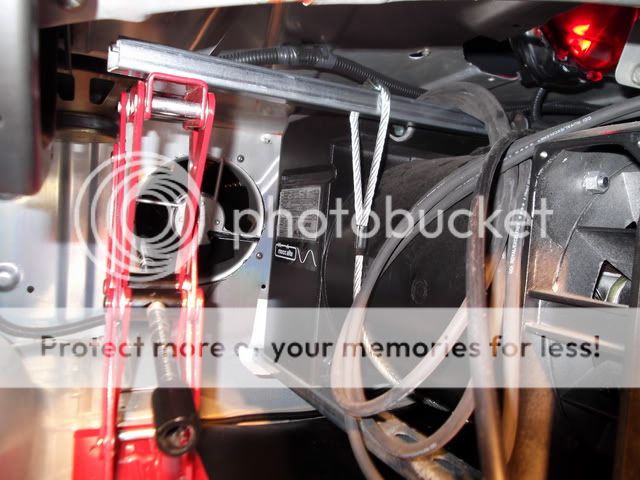

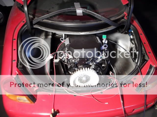

Postby JCG » Wed Apr 13, 2011 12:08 am
I think that without the genset you basically go 1 mile and then limp the mile back... and that 's on flat road.
Anyway, long night but a good night tonight. Here's the latest.
Last week Chris and I tried to cram the genset skid into the trunk and basically hit a brick wall progress-wise. Tonight, after planning over last weekend, we had much better luck.
The first step, which I actually did last week, was to put down a relatively thin (3/16" thickness) polyurethane sheet that was cut to size on the trunk floor. This was to help dampen vibration and to give the genset something squishy and grippy to sink into.
The generator head goes in first, with the engine to be positioned at the rear of the car for easy access. That's tough, because the generator head is way heavier than the engine. In fact, to move the skid around, one of us would work the hoist to raise the gen head while the other hefted the engine by hand to keep things in balance. It was a good workout.
I covered the skid end on the generator side with Teflon "footies" to help the unit slide forward.
The problem in inserting the set into the trunk came when the throttle body was blocking any effort to push the set further in, so that the engine could drop down. Note, this is after the muffler was removed to give more room to slide forward.
This was where we hit a dead end last week. What needed to occur was raising the generator head (already deep in the trunk) nearly up to the roof of the trunk, so that the engine could drop forward and down. The problem was that the head weighs 80 kg and there was no way to get to it.
So, we used a wire rope around the generator head body, put a steel channel strut through the loops, and used to scissor jacks to lift it basket-style all the way up.
We brought it up to the ceiling, and scooted the jacks forward (while loaded) to drop the engine in. We had to take the face plate off the fan, but it went in.
Keep in mind, this was a tight fit. It was worse than a square peg-round hole, childbirth, or trying to get that big couch into your apartment when your front door is on a tight staircase. Here's a view from the top.
How did we do that?! And there was no room to fool around with. Here's an idea of how close the gen head is to the cabin wall. Things did fit nicely in the end, though. The fans are not obstructed.
I didn't even plan on this part working.
Granted, we had to take out the trunk latch to get the engine in, and it has to stay cracked (for now) to keep the air flowing, but closing it up was a nice touch. Also, although it's not clear from the photos, the muffler is back in place. I'll tie the exhaust line in when I get a chance.
Now all that remains is to tweak the current controlled charging setup, mount the various items for operation (connect to auxiliary battery to start, mount laser for tachometer, fuel tank, starter switch, and throttle knob). For now, I'll send an update to our wonderful project sponsor. They'll be so proud.
