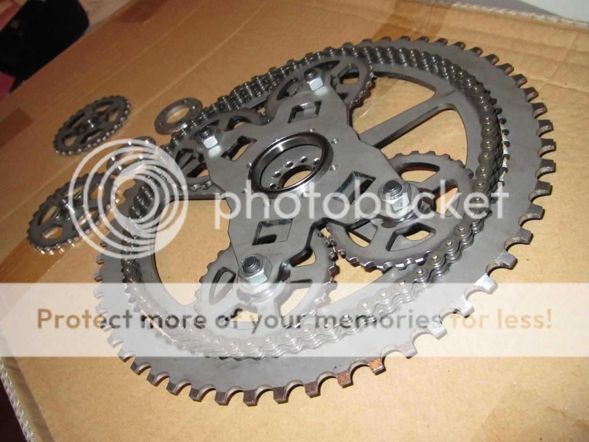

Stuff arrived in the week; I've started assembly. So far so good, it all goes together, the triplex chain is tight, heres a photo. I got some seamless (DOM) tube to make the planet carrier bearing supports and some 6mm plate to make the tapered inserts; I forsee some more lathing sunday afternoon (kinks)

OK I've done a short demonstration video; only one side is on and none of the locating bearings and it's all new and stiff, so it's a bit clunky but you can see the unfeasably large reduction ratio (!). It will be a while before the target bike is ready unfortunately.
My impressions from doing the test on the lathe are that it will all be rather too "busy" if I'm looking to get output speeds up to 100rpm. I reckon I should probably halve the reduction ratio from 20:1 down to 10:1 - this will make all the gubbins 1/2 size and they will run at 1/2 the revs. And put a greater proportion fo the "gearing down" in the primary timing belt between the motor and the gearbox/chainring. I'll get this one going first though ;^)

Awesome! What keeps it all together when you are standing on the pedals...

Ball bearings fixed on the crank axle Whiplash - they should control positions of planet carrier & therefore outer ring rather better too. I'm pleased with the way the outer ring is solidly located (it floats on the chain loop. Thinking about the size and gearing I've been idly sketching up mk2 - this is just 10:1 reduction & thus much smaller. Now I can hide all the workings inside the toothed belt primary drive pulleys - here's the sketch.
I think this is much more practical: I'll need 6:1 or more reduction via the toothed belts but I don't think that's a problem...

bobc wrote:I think this is much more practical: I'll need 6:1 or more reduction via the toothed belts but I don't think that's a problem...
It would make it more attractive if only one other reduction stage was needed. If you can get a 12:1 ratio, it would make that more doable, perhaps?

Thanks for the generous comments ;^) Miles - I'd say any ratio you want between 10 and 20:1 is pretty easy. Spinningmagnets - what I like is how accessible it is - I made that in a fortnight by walking down to the local laser cutting shop with a pen drive in my pocket with dxf's on it, bearings off the web & an hour or two on my lathe. A spur or planetry gear would need more than one stage to get that degree of reduction and is an expensive technology way outside the scope of the amateur tinkerer. I'm fairly happy with it; I don't think the mk1 is a practical solution;- too much metal flying around too fast... but I think the mk2 will be. And the way the whistling input and wobbly chain motion translates to such a smooth slow output drive is, well it's just cool!

New drawings taken to the laser cutters today.
This is what I'm aiming for
There is 10:1 between the timing pulleys and the chainring, with the harmonic stuff all protected inside the timing pulleys. Plan is to clamp an outrunner to the seat stay driving the timing pulleys directly, giving me an overall 70:1 reduction.
Yes I've ordered the big chainring is stainless - should look good ;^)

New parts for the smaller, neater and less frantic mk2 - I'll assemble this over the next few days & start thinking about installation ;^)
stainless - bling... unfortunately I'll have to do some grinding to fit the 7 speed chain......

bobc wrote:New parts for the smaller, neater and less frantic mk2 - I'll assemble this over the next few days & start thinking about installation ;^)
I'd definitely like to see this in action. :) But am I missing something, or do all the moving parts end up invisible inside the pulley? Seems a shame to hide the wonderful clockwork. ;)
Speaking of clockwork, what are you going to do with the first one?

Postby bobc » Fri May 20, 2011 5:32 am
yeah, the laser cutters really do a quality job.... ;^)
I'm afraid the gubbins will all be out of sight - yes it would be nice to see the mechanics strutting their stuff, but I reckon it's nicer to keep the noise in and the road grit out.....
The original? wall decoration? modernist sculpture? mount on a plinth as a trophy? Might make sense to mount it up as a working demo model ;^)
22/5/11 - I started putting it together - need to get hold of some loctite & do a bit more fettling.......
I'm hopeful I'll be able to get this onto a bike over the next couple of weeks.
