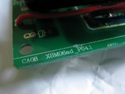

Is there someone who opened the controller ? Can you see if the battery wire and the voltmeter wire are directly in parallel or is there something between them ? Because the voltmeter plug could be used to bulk charge the batteries or to feed a second controller...

Re: 72v 1500W 40A Hua Tong Generic controller connections
Postby kentlim26 » Mon Aug 08, 2011 11:54 pm
i have open up the controller afew times. i cannot see they join in parallel, i have took the volts meter out Too. they are not useful wires. the volt meter wires are very thin, cannot do anything much except to check volts.

Postby jonathanm » Tue Aug 09, 2011 12:39 am
Yes it does. the voltmeter is the wire in this photo and you can just the the V+ pad in the top of the picture

Re: 72v 1500W 40A Hua Tong CA08 XM06AD_P04.1 controller
Postby wesnewell » Fri Aug 19, 2011 5:37 pm
The fets are 4410's, rated for 100V.
