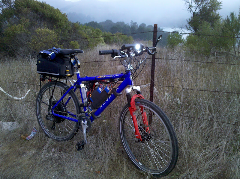

Morning Commute
The Cycle Analyst current measurement is acting strange. Both the instantaneous and the integrated amp hours. The values I'm getting don't make sense. The CA says 4.7ah used, the charger put back 6.5 on one bank. I'll get numbers from the other two banks to confirm it.
Nice view this morning. Left at twilight, watched the sunrise. Some fog. Briones Reservoir.
Cycle Lumenator. San Pablo Reservoir.
ebikes.ca tail light. San Pablo Reservoir.

Commute run, first time in awhile on the Mountain bike. The Cycle Analyst seems to be working better after the 0.1 capacitor was installed. It is probably not well calibrated right now.
Rode hard on the inbound route, don't usually do that. Got down to 3.6 volts on the last climbs. Popped right back up to 3.7 when the load reduced. Probably close to a full discharge. CA says 10.35AH but the calibration is suspect. Lowest cell voltage was 3.719 a few minutes after arriving. Bulk charging so won't get a confirmation of the capacity. Should probably go to 15AH on this pack for this commute to have a bit more margin.
Was a good morning for a ride. Passed a mile of cars stacked up at a light, backs up out of Orinda.
Brakes worked really well (one steep descent into work). But the rear is screeching badly. The Hayes Stroker front lever was closer to the bars than I like, adjusted it before I left home. The adjustment may be drifting.
