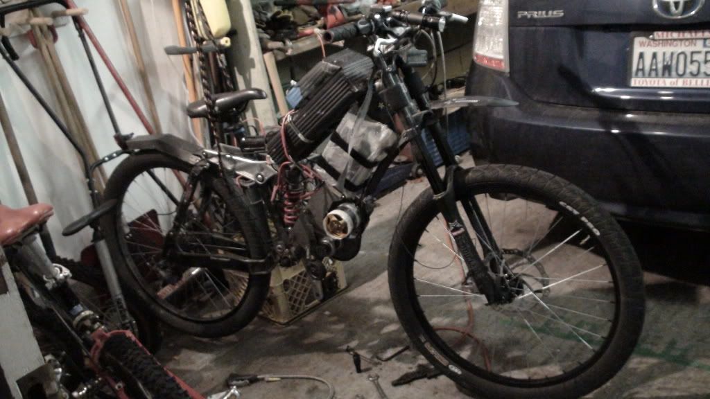

Postby fizzit » Tue Oct 18, 2011 6:00 pm
Sadly you posted that a little too late, I had already picked up the metal :( Thanks for the tip though, I'll check those places next time!
I'm sorry to hear about your crash. That really sucks that it was so expensive!
Anyways, it's been a week that i've been riding it so I figured I'd post some pictures of my bike with new reduction built, new hydraulic disc brakes, and new frame.
It handles and brakes great! The new ride is really low, with the new seat. Personally, I think it looks a lot better. There a couple of mechanical bugs that I need to get sorted out. One, it's really loud! I think the reduction may be vibrating from the chain and transmitting it into the frame. The noise really picks up around 20mph and it gets nice and quiet at 28+ mph.
For the batteries, I just took the old boxes and painted them black. It works okay, except for by the time I get home from school the batteries are falling out of the boxes and hitting the suspension linkage. In addition I just got three 4s 5000mah hardcase packs from hobbyking so I can run 12s 15ah, and get 15mi range! I'll probably make a new battery box to fit these in and keep the batteries from falling out. And I want it to be pretty and keep the styling of the bike.
The hardcase packs do cause a problem, in that I charge the two 6s-10ah units in parrallel. The harcases are 4s so I need to figure out how to split one of them up without it exploding... lame that they're heat-welded shut :?

Postby Whiplash » Tue Oct 18, 2011 6:11 pm
That thing looks straight robotic! Its the T1 bike! Lol!

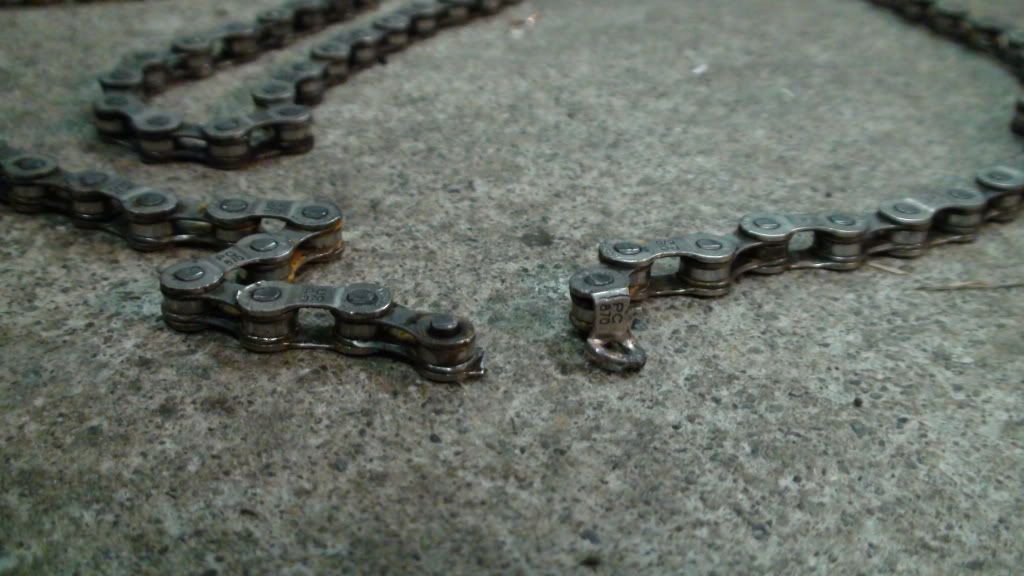

Postby fizzit » Fri Dec 30, 2011 7:11 pm
Well it's been a while! And I've continued to ride and work on my bike.
As for the question about driving through the derailleur, it's a bitch. I never shift because my derailleur never worked right after I crashed my bike. It squeaks a lot and sometimes shifts on it's own. I'll fix it soon, I keep telling myself. I have no front derailleur, so no, it doesn't feel like the power will tear it off, because the rear derailleur does not transfer any power.
This picture pretty much says it all for what I've done to the bike. I've added 5 more ah of batteries to bring it up to 15AH/15 mile range. I also recently painted my rims and spoke nipples black with spray paint. I added a generous amount of clear coat, so hopefully it will stay on.
In addition, as you can see I recently purchased a new motor, which I am currently figuring out how to mount to the bike :mrgreen:

Postby amberwolf » Fri Dec 30, 2011 11:03 pm
fizzit wrote:In addition, as you can see I recently purchased a new motor, which I am currently figuring out how to mount to the bike :mrgreen:
I think the hard part will be not twisting the entire frame into a little spiral wrapped around the shaft the first time you power it on. :lol:

Postby motomoto » Sat Dec 31, 2011 12:29 am
You need to have a derailleur that is in great shape to run anything above 3k watts, but it is amazing what kind of power you can run

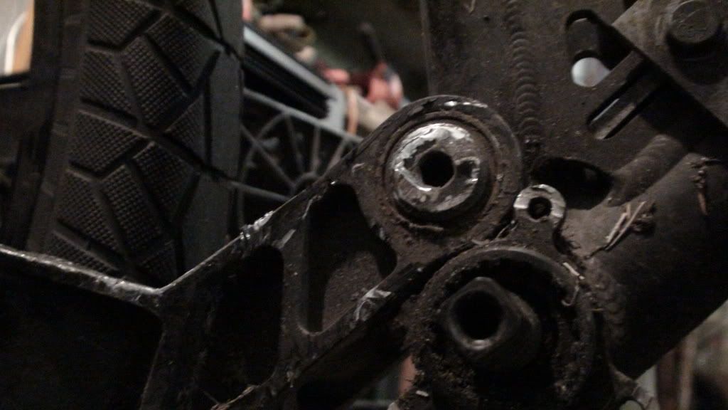

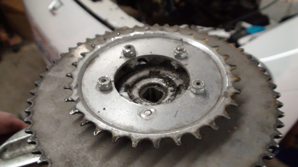

So, I completed the power train replacement. After the standard breaking-in period, it's been great and really fun to shift gears and get up to 37mph or so on the flat.
However, earlier this week, I had a problem! When I was riding home on Friday, my chain randomly shifted to 6th gear - I'm assuming that this was caused by a mis-adjusted derailleur. (they seem to de-adjust over time)
It derailed the rear chain and pulled off the smallest chain that's on the motor. I replaced the chains and slowly rode home, thinking nothing of it. Then on Monday, I headed out in the morning and my middle chain derailed! No big deal, I fixed it.
Then, Tuesday, everything goes to shit. I'm good for about 15 seconds, then the chain makes a very loud noise and binds up. Here are the results.
You can see that one of the 10-32 bolts is sheared off completely :shock:
Destroyed chain
Deep gouges in frame
another angle
I just went to the bike store and got a new chain and sprocket. I'm guessing that the old chain or sprocket got bent when it randomly shifted under load, and caused a catastrophic failure after a couple miles.
Here's a picture of the bike as it is this very moment (I'll get around to replacing the sprocket and chain tomorrow)
