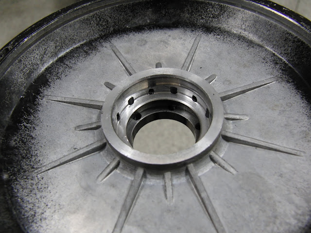

Postby andreym » Fri Nov 18, 2011 4:39 am
Some additional motor pron and more accurate measurements :D
the stator and magnets appear to be ONLY 50mm width though 5404 is only 42mm :D
oversized pictures can be found here https://picasaweb.google.com/1108717824 ... fdrLnIlQE#

Postby dbaker » Fri Nov 18, 2011 7:59 am
Great pictures :D What do you think of the screws holding it together? Were they all in good condition or did some have poor threads? What is your opinion of the rotor mount?

Postby itchynackers » Fri Nov 18, 2011 8:06 am
10kg of pure, unadulterated awesomeness.
