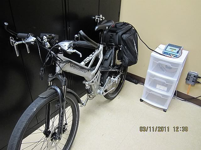

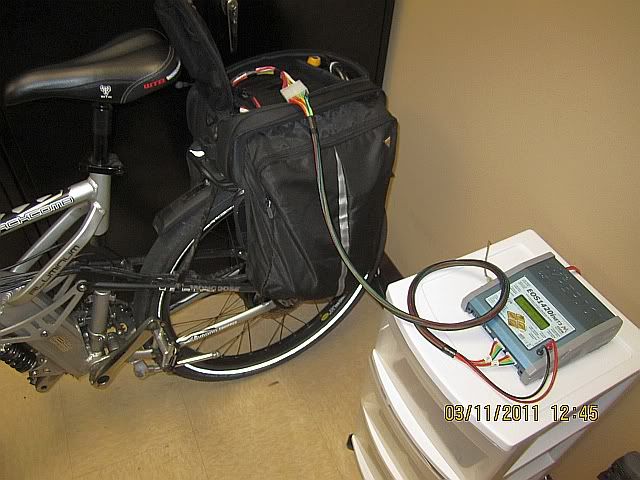

Postby Sacman » Sat Nov 19, 2011 2:11 pm
If you ever get tired of breaking down your 12s packs down to two 6s packs just to charge them... you can do what I do. I keep my packs at 12s while charging/balancing and I only have to deal with "one plug" to make the connection to the charger. Here's how I do it: I use Gary Goodrum's BMS boards and a Hyperion EOS 1420i charger that's capable of charging up to 14s packs. (the rest is just a copy of my post on another thread discussing the Hyperion 1420i charger)
Gary's boards and harnesses work great for a "one plug" charging and BMS replacement solution for my 12s8p (44.4v) 40Ah LiPo pack. I use his boards and 2 sets of harnesses and 2 Hyperion EOS 1420i chargers... one set for home and the other set for for the office. After my long commutes to and from work I just connect the one single VAL-U-LOCK connector and start the charger. After 3 hours the pack is charged and balanced and I just unplug the VAL-U-LOCK connector. Like Gary said "one plug charge and balance solution! No muss... no fuss".
The only change I made was to make longer 3.5 ft section of the harness (the one between charger and VAL-U-LOCK connector. The added length allows me to leave the batteries on the bike and still connect to them for charging. Thanks for the elegant solution Gary!
Here's my ebike & charging station at work. Notice the short section of harness that I replaced with a longer 3.5ft secton.
