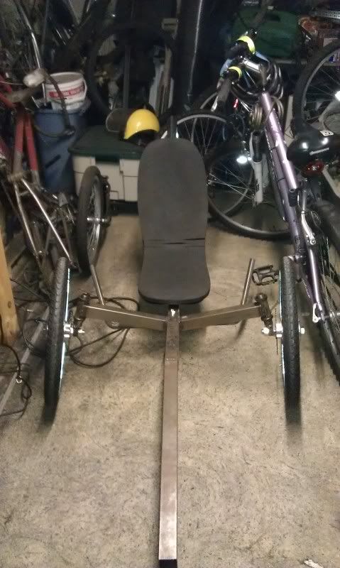

Postby Xanda2260 » Sat Nov 26, 2011 3:00 pm
Ok, got steering sorted at last! still needs tuning but it works! Went for first ride this evening, just down the street. No power, no lights, no pedals and NO BRAKES!! Rides nice, turns well - I'm chuffed!
Handle bars will not be this long when finished. I'll cut them down once I've stuck all the goodies on. Think I'm gonna have an issue with my thumb throttle hittling the right hand wheel. Anyone got a nice slim one they want to sell me? This beast has an LED fuel gauge built in so it's huge!!

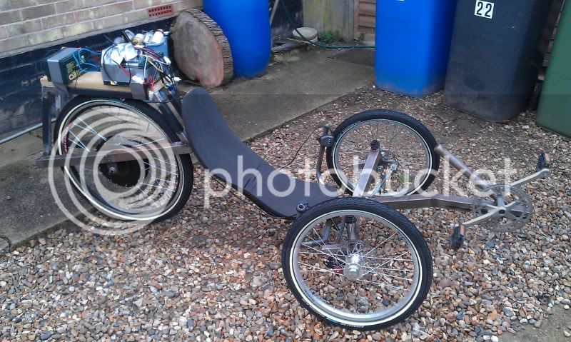

Postby Xanda2260 » Thu Dec 15, 2011 8:39 am
It's ALIVE!
Feast your eyes on the duct tape disaster-waiting-to-happen!
36v 15ah of appalingly heavy lead on my lovely new rack. Wires bloody everywhere, ductape holding it all together(ish) and me with a huge grin in my face!
She's no where near ready yet (no brakes for a start) but it works!!
I like the EV grin :mrgreen:

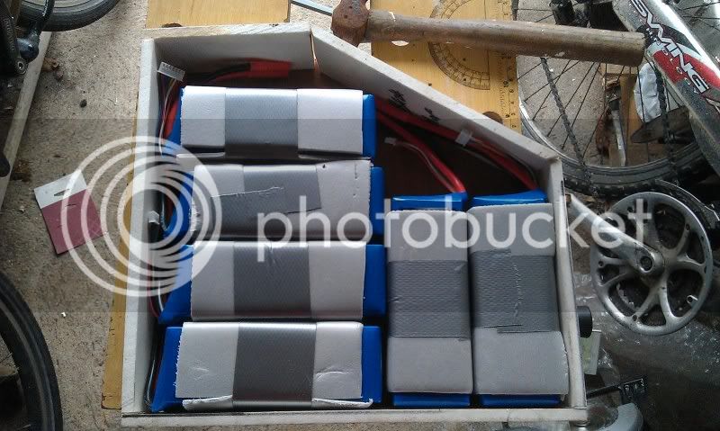

Postby Xanda2260 » Tue Feb 28, 2012 9:46 am
Oky guys, sitrep.
Batteries have arrived, I've nearly finished a temporary battery box, and the trike can be pedalled!
http://i75.photobucket.com/albums/i293/ ... EO0019.mp4
This is a bid of my bro in law pedalling it up our street (yes, the girly laughing in the background is me). The rasping noise is the connector for the halls rubbing on the tyre! Apparantly the cable shifted when he hit a bump.
Below is my temp batt box
Will make a better one when I find some material that is strong, tough, easy to work, and thin!
Im tinking carbon fibre, but I wouldn't know where to start. Clearances are VERY tight. With is box I have around 10mm between it and the rear tyre, and maybe 3-4" clearance with the ground which annoyingly makes the batteries joint lowest point on the trike!! Eek!

Postby Xanda2260 » Thu Mar 08, 2012 4:29 pm
It lives! And 38mph withe you arse 5" from the floor is scary!
