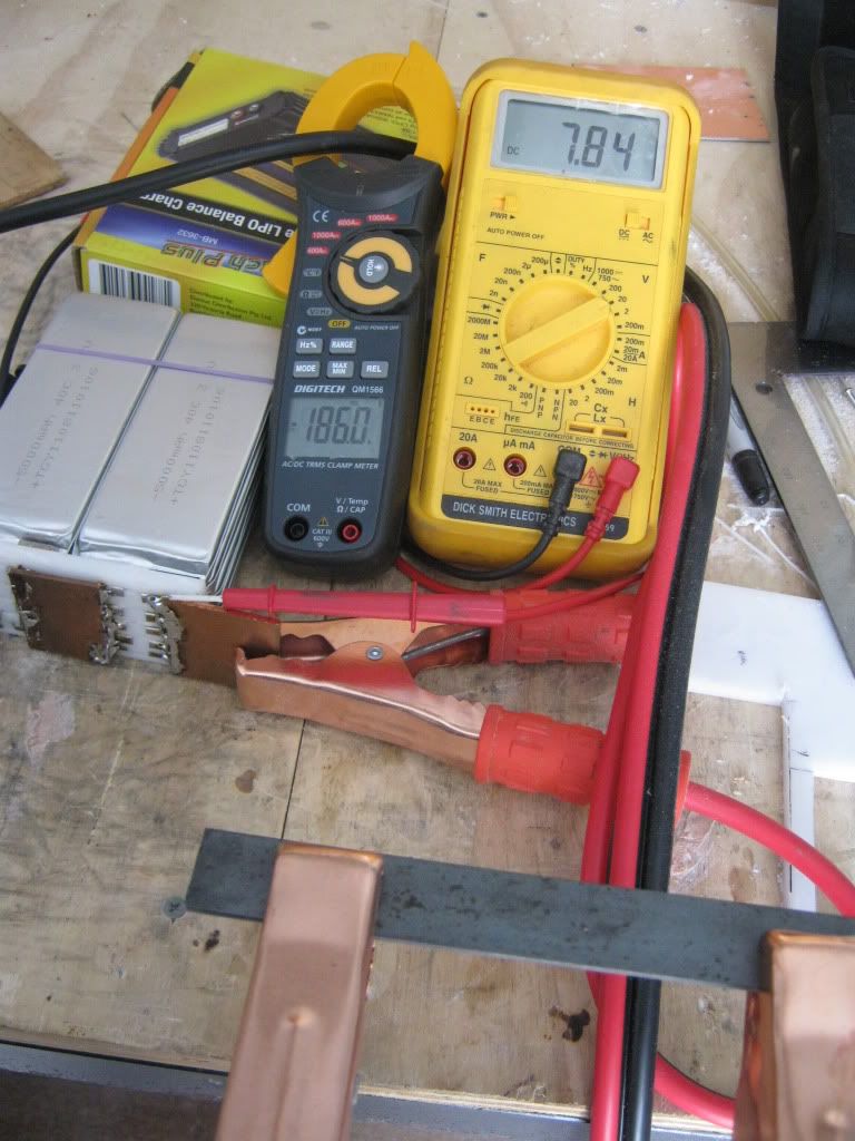

Postby jonescg » Sat Nov 26, 2011 9:15 pm
TD - not bad, but if there was a way of making it more compact that would be better. I have also been reminded that screwing the terminations together only really works well if the entire clamped bit is metal to metal (i.e. copper plate through tab to brass backing plate). I will come up with a few ideas today hopefully.
Meanwhile - did my soldering stand up to the task?
At 186 amps (7.5C) the terminations are stone cold, busy thinking about what they plan on having for breakfast. So even my shitty soldering is enough to take roughly half of what I plan on giving it. I will try to make some decent cables out of 50 mm2 cable, cause my 200 A jumper leads aren't up to the task.

I also tested it with both clamps on one side, utilising twice the cross-sectional area. I managed to get a burst of 600 A, which later settled down to 400 A. Again, the soldered terminations didn't roll over in their sleep, while the booster cables are suffering some serious heating :D
Conclusion; even my lousy duckshit soldering can still handle very high currents without failure. It's just a royal pain in the arse to solder the whole pack together. Back to the drawing board for more clamping ideas...

Regarding battery heat. How about finding a way to discharging one of your loose cells at 10C,20C, and monitor the temp. This should tell you if you need to do anything special. If they are still not getting hot then ditch the idea of spacing the cells apart.

I think I get what you are saying, Tony. Still convinced I can avoid busbar and spaghetti junction wiring by going with bare cells - just need to nail it somehow. I think I am close.
For any interested parties - the TTXGP rules have been updated. Maximum permitted system voltage has been increased to 700 V :shock:
