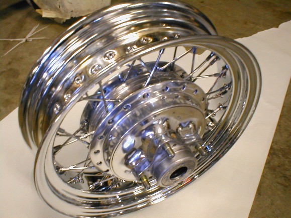

Great, looking forward... :)
There are several different ways of lacing, if you need ideas check out some old drum brake motorcycles, many of them have shorter spokes. But in the end, it all comes down to your rims and the way they are meant to be laced. Maybe this could also help:
http://www.oldbritts.com/image/wlacing5.jpg
http://www.oldbritts.com/image/wlacing6.jpg
http://www.cyclexchange.net/index%20pic ... %20rim.JPG
Some rims/wheels even tend to have asymmetric lacing patterns:
http://www.wswws.com/media/images/image ... g3107w.jpg
Anyway, keep up the good work... ;)
