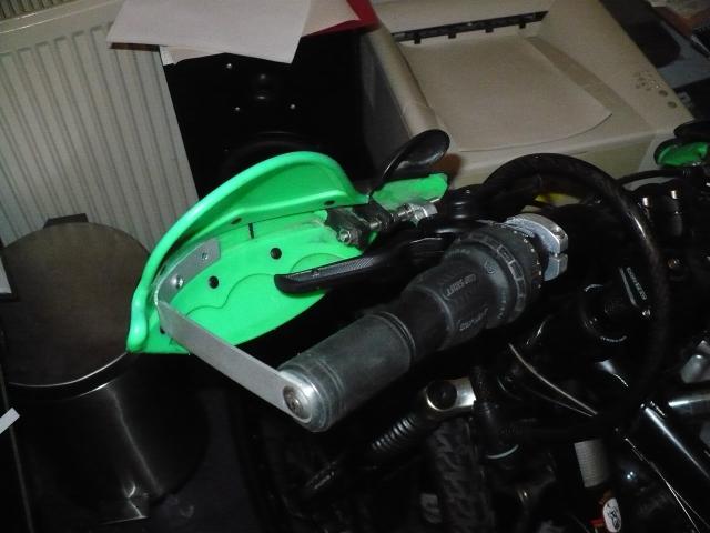

Postby Pure » Sat Nov 26, 2011 9:38 am
Interesting build. Where did you get those hand guards from?

Postby crossbreak » Sat Nov 26, 2011 7:38 pm
the bay.. about 15 bugs :P
looks really horrible I know... next week they'll get paintet I pomise :wink:

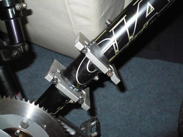

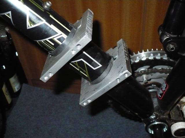

Postby crossbreak » Sun Nov 27, 2011 7:18 pm
frame mounts:
I used 10mm alu sheet, but I should have used 12mm. The screws arre all M6
The mounts can also be used as hub motor mounts. The width should then be 100mm, not 80mm.
pieces of bike tube portect the frame from scratches.

Postby crossbreak » Sun Dec 04, 2011 7:11 pm
the handguards are simply fastened by a drilled synthetic cork, pushed into the handle bar and then squeezed by an M5 screw. note that the aluminium bar at the side is homemade

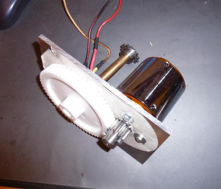

Postby sn0wchyld » Tue Dec 06, 2011 5:43 am
crossbreak wrote:Hey ...............
inspiring drive/build mate, ive been debating how to go about a mid drive for a while, and this might be the thing that pulls me away form a middriving hub to a 80100/8085... Re-terminating seems like a good option since it almost halves the kv, and would be an interesting project in itself to...
What material is your 1st reduction drive cogs made out of? is that nylon/strengthened? and how much power do you intend running? I could only see reference to 45V, but not to amps...

Postby crossbreak » Wed Dec 07, 2011 9:26 am
Hi sn0wchyld,
I didn't care much about the electrics yet. I designed the gearbox to last about 10NM at 4000rpm at the motor, thats about 4kW in short term, with steady load it should last about 3NM at the same speed, about 1.4kW. I hope that all of the chains and gears will last about 10.000 km or two years with good lubrication (including the final shift drive). Then they will be replaced all together.
The bike should not be faster than 35mph or 55km/h, to save battery capacity. Wind drag makes the most, which rises exponentially with speed.
The pinion gear is made of 11SMnPb30 Steel (not stainless), big one of casted polyoxymethylene (POM), their module is 2.
I will start with a sensorless 12-FET, 37V, 15amps (about 500W) with 10ah 10s2p LiPo. If that runs good, I want to increase it to 24-FET 48V, 100amps, 13S Lipo with 20ah and the same but then modded controller. I want to stay below 60V because of legal issues. I also don't like to add halls or optical sensors to the motor, but most likely I will have to.

The 1KW for the nuvinci can be reread at their specs. But the 1KW is at 1000rpm. It should mean that it can last about 10Nm torque.
The Plastic Gear has 60 teeth, module M2 and can last 18Nm torque, the motor sprocket has 12T, that would be 18NM/60x12=3,6Nm at the motor. That is about 2.2KW continous power it will withstand.
If you want to go further you should just take a larger motor gear. but you have to keep in mind that you should get an over all ratio from the motor to the pedal cranks of about 6000/120=50 if you go for 48V and take the 130KV 80-100.
