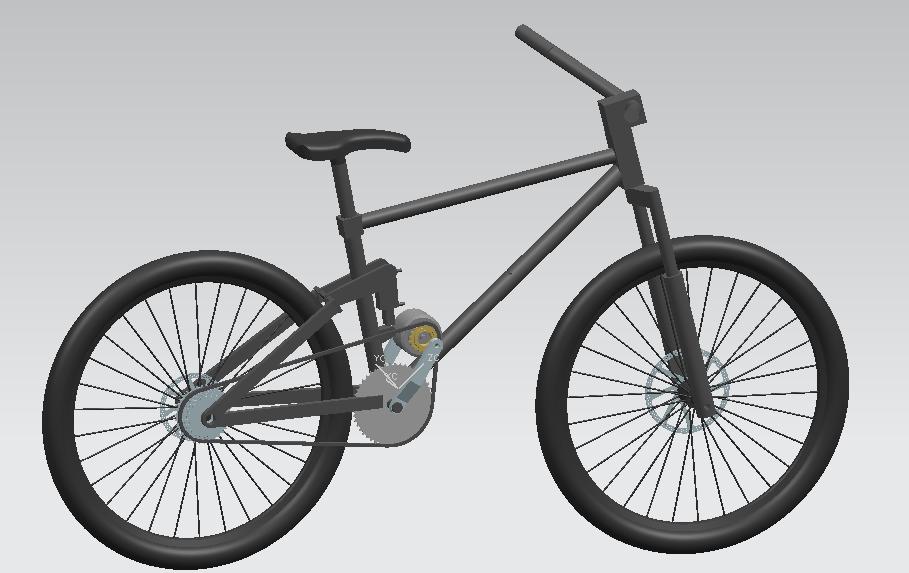

Postby crossbreak » Thu Feb 02, 2012 6:42 pm
Hey docnjoj !
Thanks for the TongXin MidDrive tip! It's just like I imagine, also thanks to y amberwolf who tried to build that:
amberwolf shows us a 24t sprocket on the motor
I think the sprocket is too large for my purpose
The motor does 190rpm at 36V. I want 100 at the crankwheel. I have 38t on it. So I calculate t=38/190*100=20
I guess I will be lucky with 18.

Postby crossbreak » Sun Feb 05, 2012 6:45 pm
Notice that one bearing is missing. I had only one 12x21x5mm one, I have to buy a second. It should be pushed into the right part in the picture below. Also a bushing which should be between the bearings isn't manufactured jet.
I know that a second freewheel doesnt make much sence, but the one I used has much less drag than the originial one still build-in.

Postby crossbreak » Wed Feb 08, 2012 8:35 pm
OK! Now you got me :D
I will test this motor in my black mountainbike first, just like the Conhis motor ;)
i mean this one (note my new 130mm fork and 203mm brake rotor :D )
The fork was 40 bucks from the bay, the disk about 10 with shipping from china
I can also recommend the upper head light ( an Cree XML T6 Flaslight front end ), for about 15 bucks with shipping from the chinese bay.

here you can see the bearing between the chainring and the bottom bracket that i meant.
The 8mm chain was waste after about 90km :( I'll try a 3/8 x 7/32" chain with 13 to 32T now.
the swing arm isn't where it should, but it shows the principle.
