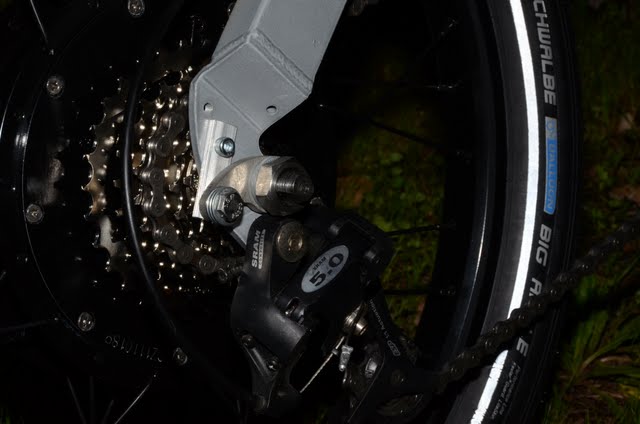

However the torque arms are a problem. The holes are undersize. Hard work gently enlarging them. 1 hole of 4 done. :(
Also it appears there is not enough room for the standard torque strut. So I will have to make custom ones. :(

I remeasured the axle to axle length and it is 52". So it is the short wheelbase, unfortunately.
So I spend the rest of the evening filing torque arms. Now all four holes fit. Whew. :)
The torque strut is the piece that goes from the end of the torque arm to the frame. It is in tension or compression. On my mountain bike I went through the calculations and discovered that at the force level it operates it could be 6061 Aluminum so they are not hard to fabricate. I do not like the slotted ones that are supplied as the slot makes it easy to adjust but allows the parts to slide at some unknown force far below the material strength, so I make a strut the right length and drill precise holes to fit the bike. In addition I thread the strut on one end because on my mountain bike there was insufficient space for the supplied nut to clamp the arm to the strut. The same appears to be true with this recumbent.
I also drill the clearance hole at the other end undersize and ream it to fit so there is very little play in my torque strut.
So, to complete the rear wheel installation I need to take the hall plug apart and thread the nut and extra washers off, thread torque arm and washers back on, put it all together, make the torque struts, and reassemble the hall connector. I might have to take the phase connectors off as well and replace them after.
Some folks have indicated that the torque arms might not be needed with the steel dropouts, but given they are 12mm wide and the axle flats are 10mm or a bit less I think the torque arms are probably required.

One other comment is that the torque arms are pointing to the rear, so the reaction force is upward into the dropout. This is especially important since the shallow dropout is not a tight fit being 12mm wide where the axle flats are only 10mm. So all forces on the dropouts are either up or to the rear.

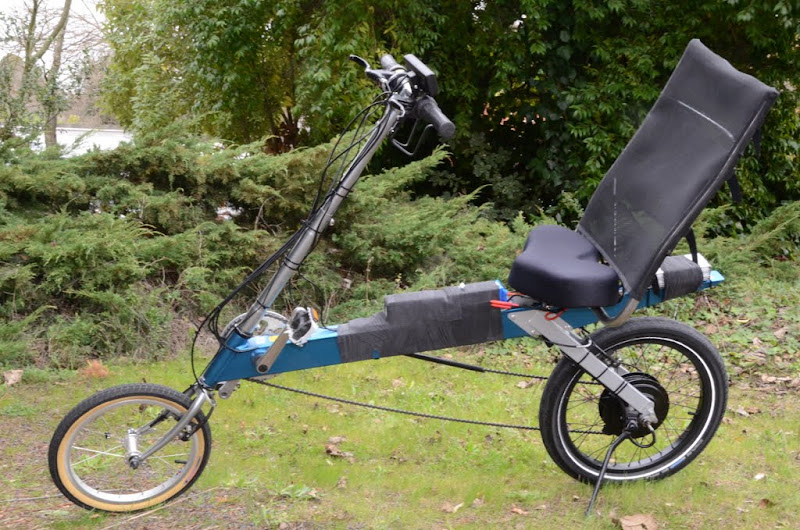

Postby Alan B » Sun Feb 12, 2012 7:14 pm
She's electric!
12S 5AH 50V (full charge)
BMC V4C rear hubmotor (speed winding)
20" Schwalbe Big Apple rear, 16" gumwall front
Lyen 12FET Controller
Cycle Analyst Large Screen direct plug w speed sensor
2 ebikes.ca torque arms with homemade torque struts
Top speed approx 25 mph, still accelerating a little, calibrated the wheel from measured diameter.
Power 1000w noticed so far when climbing
Climbing 10% did okay, not super fast, will have to measure better later.
Was reminded that I need a rearview mirror, forgot to install that.
Slight surging noticed if the load is very light, will have to try adjusting parameters or try an Xlyte analog controller.
I like the motor on the recumbent. It is really nice gliding along, and getting launched up to speed. There is a little gear noise, not loud but noticeable. It glides very nicely when the power is off. Can pedal to about 25 mph, so well matched.
The brakes seem decent. Coming down the 10% warmed the front rim and I could smell the pad rubber slightly since it is so far in front of me. The rear rim is painted and that brake works well but screeches a bit under some conditions.
There is a little play in the headset bearing. Need to figure out how to tighten this Aheadset.
Need to start thinking about a more permanent battery. Perhaps four 6S 8AH zippys in 12S 16AH?

I don't have photos of making the struts, but it is pretty simple. I use 1/8 by 1/2 inch 6061 T6 but mild steel would be even better. I cut to length and drill two holes at precisely the right spacing. I do that by drilling and threading one hole, mounting on the bike and marking the other hole, and drilling that hole just undersized and reaming it to fit.
I did have enough room behind one of the struts to mount the nut on the backside. On the other I used some washers so the bolt would not protrude too far and touch the chain.

That's a nice case Alan. Good rigid waterproof package that holds enough LiPo to get around just fine.
