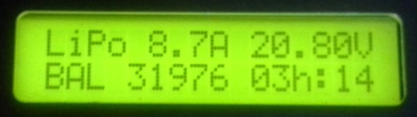

so i'm back on the idrive this week, since the dh comp is in repair. such a different ride. so high up now! tighter suspension..
anyway, i had a long errand after work yesterday and had to ride 21 miles! and without a CA!
i was late for an appointment at the end, so i got a good workout, going on speed 1 (15mph max) most of the way. considering normal driving uses about 1 to 1.5Ah per mile and the old pack had maybe 8Ah tops, i was asking a lot, pedaling hard, knowing i could hit the cliff anytime...
thankfully towards the end, i remembered that i had my lipo buzzers :idea: :lol: which hooks up to the pack db25 and it alerted me in the last 1/2 mile that one cell was hitting 3.2V under load.
that pack always had a runt cell, so i wasn't terribly surprised, and my balance charge cable hasn't been working, so it hasn't been balanced since 2011.
here are the no load voltages at the end:
and here's the video, fwiw, from which i got the numbers:
i think cell in the top left pack is the runt, and it'll be interesting to check the IR of cell 4 from the other packs.
why are they low? do they coincidentally happen to be runts in their cell groups?
or have they been working extra hard to balance up the runt from the topleft pack, and are consequently overworked? what's the explanation? i sort of figured that when cells were paralleled, they'd balance themselves out?
i kinda expected the runt would be in the top right pack, which looks likes it's been getting poked by the locknut! :shock:
i think this dent is somewhat recent, the pack may have gotten mishapen recently. anyway, they may be tougher than we thought..
after 3.25hrs on the balance charger (set to charge up to 4.2v/cell):
after 4.5hrs on the balance charger:

Postby methods » Thu May 31, 2012 11:06 am
FYI: I recently found that my iCharger was off by 40mV on one channel. Not that I think this is what caused your runt situation, but I suggest carefully calibrating your iCharger channels. The calibration routine is posted in the maga RCGroups iCharger thread.
In my experience when a group of parallel cells all show low capacity (like your runt cell) it is because at some point a single cell failed and after that the parallel group of 4 was driven down deep past 3.0V when the pack was not being monitored for cell level LVC. This happened to two packs we recently built here (that were not running cell level protection)
-methods

Postby GCinDC » Thu May 31, 2012 11:39 am
thanks, methods. i balance charge other packs with the icharger and haven't noticed a difference, but will pay closer attention to that.
isn't another sign of a runt that when hooked up to a charge, the runt cell's voltage will rise quickly, comparatively quicker than healthy cells? why is that, just out of curiosity?
it should be noted that under load, it dives far lower as well, so just doesn't seem as stable anymore.
i'm afraid these cells have seen the mid to high 2V's once or twice, or three times, from lack of protection and lazy monitoring... :roll:

Postby methods » Thu May 31, 2012 11:49 am
Low capacity or high internal resistance.
Higher internal resistance
Drive a current into it and it will show a much higher dynamic voltage (I * R = V)
Pull a current from it and it will show a much higher dynamic voltage drop as well
Same would happen for a lower capacity...
Cells would climb faster and drop sooner
Oh well... anyone who is serious about ebikes has piles of lipo around that has been abused. All of my lipo has seen 2V at one time or another :) Dont you hate that 45min push home just *knowing* your cells are sitting at 2V? Arg... I dont miss those days.
For real bro... test your iCharger channels with a Fluke. You may be surprised.... mine were WAY off and from what I understand that is somewhat normal for older units. Check it.
-methods

Postby GCinDC » Thu May 31, 2012 12:22 pm
thanks, that helps my understanding. i always think chemistry and forget math.
so what fluke would i need? most cost more than the icharger .. :roll:
and while we're on the topic of IR, is there any reason i would not be able to measure the IR of my whole pack, reconfigured to 5s8p? i tried this and blew my last icharger, but i probably screwed up, since i seem to recall that several cells displayed 0 mohm and one had an impossibly high number... perhaps i connected the leads in 20s... ? :mrgreen:
ps. did i also read somewhere that there's a little deviant method in the oven? if so congrats. i always buy a bunch of stuff for my own projects to compensate, so 5 cromotors seems like a good start. :lol:

I say, if you have a couple of bad packs, just throw them out or replace them. I read lipo fire is nasty stuff!

That's so weird how all the 4th cells are low.
