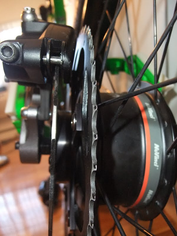

Postby MattyCiii » Sun Feb 26, 2012 8:26 pm
Those are certifiable ES wheels:
Spokes by JRH,
Rims from the Recumpense 47mm wide, 406mm rim group buy.
The tires are Pirelli 16" x 2.5" moped tires. Something I never would have thought would fit a 406mm rim without the ES collective knowledge base.
Up front the hub is a Lefty (of course) hub custom machined by Project321 (http://www.project321.com/), who was incredibly helpful in getting me the right parts to fit a lefty fork to the Norco. Stopping power from a Hayes Prime Pro and 203mm disk.
Out back the wheel is laced to that NuVinci N360. I've removed my dropouts in anticipation of Magudaman's replacements http://endless-sphere.com/forums/viewtopic.php?f=3&t=35654&p=532410#p518345 coming hopefully in March.
I gotta thank MadRhino for the tip about Magura Gustav M brakes
Image, there's not a lot of room between the brake rotor and the drive sprocket.

Postby MattyCiii » Tue Feb 28, 2012 6:42 am
Not even 1/2 built and I'm already making changes. I'm using Magura Gustav M brakes on the rear because of the tiny, ~10mm clearance between the left hand chainring and the brake rotor. I got the Gustav as a pair of used brakes through Pinkbikes - I paid $250 for the pair, bleed kit, and a bunch of parts including rotors and pads to last me a long time.
Now I'm thinking - why use the Hayes on the front - why not go with Gustav front and rear? That way I can standardize on one type of brake, carry only one type of spare pad, and have all that Gustav stopping goodness on the front, where it'll do me some good. Of course, I don't have the correct mount to use the front on my fork, so I'll have to figure out which one is right for me and buy more parts...

Postby MattyCiii » Wed Feb 29, 2012 6:45 pm
Here are some pictures of the tires/wheels. I took them to cross/post with this post http://endless-sphere.com/forums/viewtopic.php?f=28&t=29888&start=60#p542254, but also to show the wheel in relation to a close cousin: 406mm bike tires on a more standard bike rim.
Both front and rear are 406mm x 47mm rims (from the Recumpense group buy) with Pirelli moped tires:
Here's the whole thing, laced into a NuVinci N360. Mmmmmmm, beefy!
Here it is next to another 406mm wheel from my "daily driver" Dahon folding bike.
The Schwalbe is a 20x1.6 inch tire. Here it is alone:
And here they are stacked.
