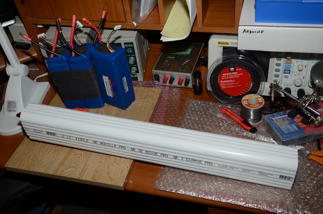

Took a run to the hardware store tonite.
Picked up some really thick heatshrink, some of the small copper crimp sleeves, and a ten foot section of "vinyl downspout". This stuff looks quite useful for batteries. It is 2" by 3" so the Turnigy fits with 1" to spare, but the Zippy 6S 5AH packs fill the tube nicely, leaving room for some wires to pass by. It is thin and light and somewhat flexible, not brittle like PVC. The inside size is just under 2-1/4 by 3". The Zippy packs are under 7" long so six of them is 42" plus some space for connections and balance boards, easily under 50".
Taking a tape measure to the bikeE we find:
Above the top of the frame beam is about 20-24", depending on where the seat is positioned. With my long legs there is about 24" available.
Under the frame beam is 30 inches to where the cables come out.
Six Zippys 6S8AH are about 1KWH and takes a bit more than 42" of this rectangular vinyl pipe. Could split the battery into the two halves of three Zippys in parallel each and get 12S 24AH in a pair of 24" long pipe batteries. These could go above and below the beam, or on either side of the beam under the seat but spaced out a bit to miss the forks. The motor controller could go right at the aft end of the tube under the beam.
This is very tempting. Anyone else done this? Others have used this vinyl downspout pipe on some builds, but not a recumbent that I recall.
So should I make a vinyl tube battery for the bikeE?

Took a closer look at the battery situation today. I'm going to try a vinyl downspout tube battery. Three Zippy 6S 8AH in parallel in each 24" tube. One above the frame, another below.

Re: ebikeE Recumbent Testing - it's alive!
Postby Alan B » Sat Mar 03, 2012 8:59 pm
Bad News
The zippy batteries fit nicely in the 2x3 vinyl downspout pipe... right up to the wiring pcboard where they get a little taller and wedge.
Back to the drawing board... :(
Postby Alan B » Sat Mar 03, 2012 10:50 pm
Battery Plan E
My apologies if this feels like a roller coaster ride. So many plan changes!
This may work out better than I had expected. It is a bit more work, but it is coming together better.
So, I'll take the vinyl downspout and slice off about 1/2" so there is a 2x2.5 inch "U" left. Put a layer of 1/4" foam in the bottom, then the batteries, then lay in the wiring. Add another layer of 1/4 inch foam on top. Then take another "U" piece inverted and slide it over the top, or interleave it, whichever works better. Push it down until the batteries are grasped by the foam. Vet-wrap this tube in several places to compress the foam a bit and keep it in compression. This will lock in the batteries, wiring, and make a compact package that is protected on the sides by 2 layers of vinyl downspout material, and on the top and bottom by one layer plus the foam.
To do this I'll probably have to dig out the table saw to rip the plastic. Carefully and Safely.
There is hope for this yet! :)
Postby Alan B » Sun Mar 04, 2012 9:05 am
How can Vinyl Downspout material make a useful battery housing?
I received one PM asking about that, so I'm sure others are wondering as well. I need to add some photos, but it is 5am and I'm not going to get out of this warm bed yet, and the best light for photos is hours away. So I'll try to describe it without using the requisite 1,000 words. :)
I have 6S packs from both Turnigy at 5AH and Zippy at 8AH. I could use either for the bikeE but the Zippy require fewer interconnects and as it turns out they fit the downspout tubing better, except they don't quite fit. More details in a moment.
Part of this process is affected by me getting anxious to get this bikeE on the road. Much of my Turnigy pack is tied up on the Mountain bike so I can use the Zippy more easily without disturbing the already working Mountain bike. I have a few loose Turnigy packs, but only 500 watt hours. I have six of the Zippy and they are (a bit less than) 200 watt hours each. My goal is to put six Zippy packs on the bike for now. That will give me 1200 watt hours optimistically so perhaps I will have 900-1000 useable watt hours and give me a 50 mile range riding efficiently. The seatback, rear tail and underseat areas will all be available to carry other things. The batteries will be out of the way.
Spacewise on the bikeE I have 24 inches on top of the main beam, and 30 inches below. So we can take three Zippy 6S 8AH packs which are each seven inches long, and place them end to end on top of the beam and have a pack that is 21 inches long. The other three similarly packaged below the beam. I'm making these packs 24 inches long to allow some room for connections and the HVCLVC pc board.
This works out especially well for me since I'm planning to use 12S, so each of these two "tube packs" can be 6S with three 8AH packs in parallel. If I make them with the output connector being a 4mm dual banana plug (like a Turnigy battery) they will plug into my already made wiring adapters that series the packs and feeds the Deans that came on the controller.
So I will cut the top of the 24" long vinyl downspout tube off making a "U" channel, lay in some foam, lay in the 3 batteries end to end, lay in wiring, more foam, invert another cut U tube down over that and slide it down till the batteries are tightly captured, and tape or vet-wrap the two U's together into a tubular pack 2x3.5x24 inches long. Then these tube battery packs will be mounted above and below the bikeE beams, probably with vetwrap for now.
For charging I'm getting a Hyperion 1420i so I can balance charge the whole pack at once.
Most of the effort to do this is in making the wiring fit into this long packaging.

Postby Alan B » Sun Mar 04, 2012 2:56 pm
Variable height battery tube
Here are a couple photos showing the 2x3 vinyl downspout material being used as a battery holder. One side was cut off (do this carefully), and two U sections used to create a variable size battery tube:
And now with the top U section slid down over the lower section:
