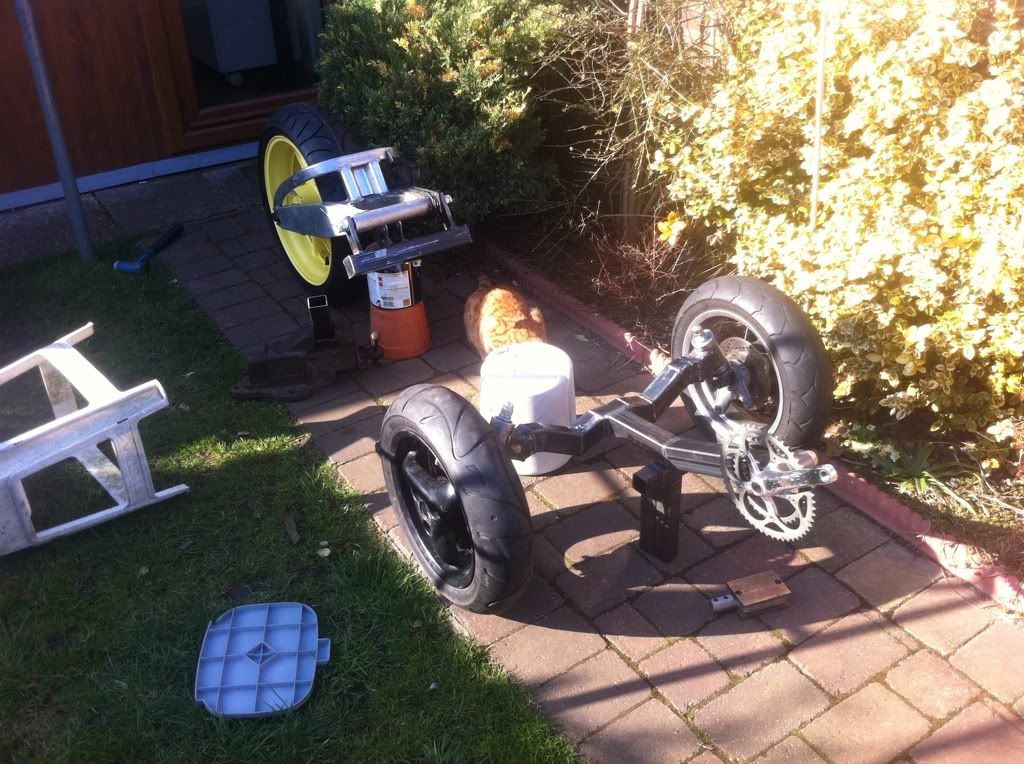

Postby Goped ESR750 » Sat Mar 10, 2012 1:07 pm
Started building a new project frame. This is based on a tadpole trike but uses scooters wheels on the front and a fire blade rear wheel.
Going to using a e-Tek motor. Here is a few pictures of what I got so far.

Postby bgnome » Sat Mar 10, 2012 4:16 pm
that thing looks like it is going to be very beefy..
will you be able to pedal it at all?
looks like a hub drive is not what you are going for.. maybe mid chain or left side motor? seems like it will be leaning towards a electric tadpole motorcycle!

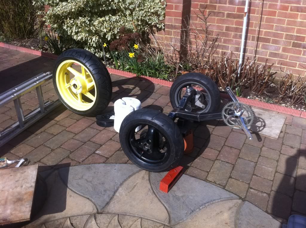

Postby Goped ESR750 » Sat Mar 17, 2012 1:39 pm
Thanks for the interest. The pedals are more or less for show, but hopefully it should not flag the attention of the fuzz if I am pedaling along.
The way in which the drive will be combined will be a shaft in middle of the trike, behind the seat. This will have the freewheel and cassette on it for the rear derailleur, it will also have a sprocket at the other end to take the large size chain to drive the rear wheel. Somewhere along the shaft will be another sprocket with sprag clutch for the motor.
Been busy sorting the steering linkages. Got around to welding the rear end on now. I have to make mounts for the shock absorber yet, which is probably more for show than anything because the shock is rock solid.
Here is a few pictures of what I got.

Postby sn0wchyld » Sun Mar 18, 2012 12:05 am
er, arn't you worried that the frame wont be strong enough? :wink:
other than that, it looks pretty damn good...

Postby Goped ESR750 » Mon Mar 26, 2012 6:11 am
My trike uses kingpins I made for tapered roller bearings. I cant remove either bearing as they need to be locked against each other to work. I included a picture of the kingpins assemblies I machined, they obviously have all the rest of the steering hardware welded to them now.
The steel I used for this is 50mm square box section with a 3mm wall. The actual frame is not hugely weighty, the wheels double the initial frame weight I would of thought.
There was an upgrade package for the kmx trike seat. I bought it, and made it fit my trike. I decided I didn't like it, although it was comfortable it certainly was not weather proof. I decided to make a bucket sort of seat which comes out the frame using 40mm x 3mm flat bar. Will add weather proof padding where necessary. The only bit of padding I feel I need is on the rear shock support for my back. The rest feels really comfortable for me, and keeps me in one place without risk of falling out in a corner. Others who have tried preferred the kmx seat, guess this happens when you make it fit one person :)
Few pictures of where I at.
