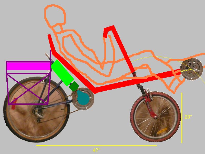

Structure:
There are so many recumbent design options I hit paralysis by analysis for a while. Maybe those of you reading this aren't too familiar with recumbents either, so after reading for a couple days I picked from a few hundred samples and condensed the major design choices to these things. I've labelled them myself, some of the terms might be wrong as I just made them up:
- I will be choosing to build a a Short Wheelbase. I'm not entirely sure what a racer is, but something that looks like a mid or high racer probably? Not too low for 4 reasons: 1- I'm scared to be too low, dangerous in traffic, 2- I don't want to ride with my chin down, opposite reason I don't like uprights cranking my chin up to see the road, 3- I like to be high enough to enjoy the view, I would like to tour with this bike (will also be using it in the city). 4- It's not comfortable to be in a sky-crawling position. -- I am aware there is a drag penalty for every inch of height I refuse to abandon, I accept the tradeoff --
- Straight or S-Pipe frame, diamond is ugly.
- Above seat steering, probably. Simpler.
- RWD & Right-side drive. I want to use at least the rear cassette to give some mechanical motor gearing (chain issues though?), I might not need it since I first chose this.
- 26" rear, 20" front. I think this makes it easier to have lower posture with an upright seat and cargo room.
- Front suspension from a kid's bike (bad idea?)
- Rear suspension maybe, if I can figure it out.

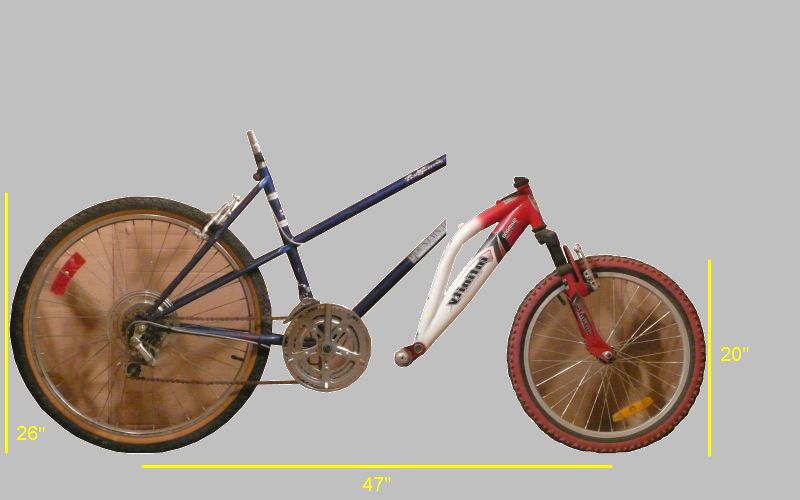

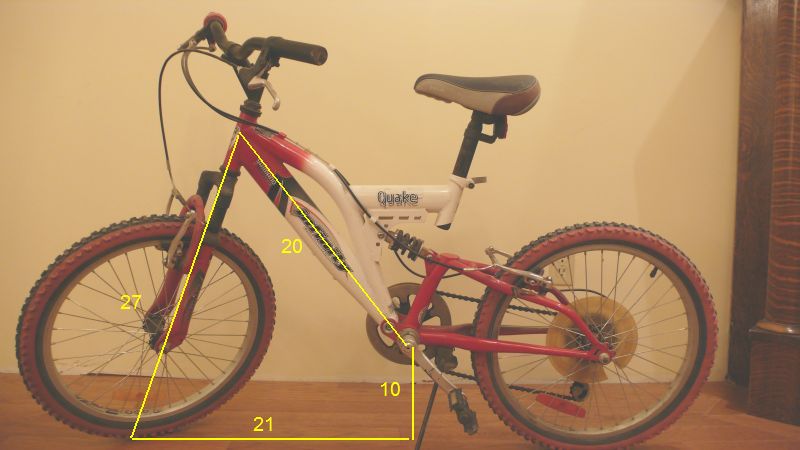

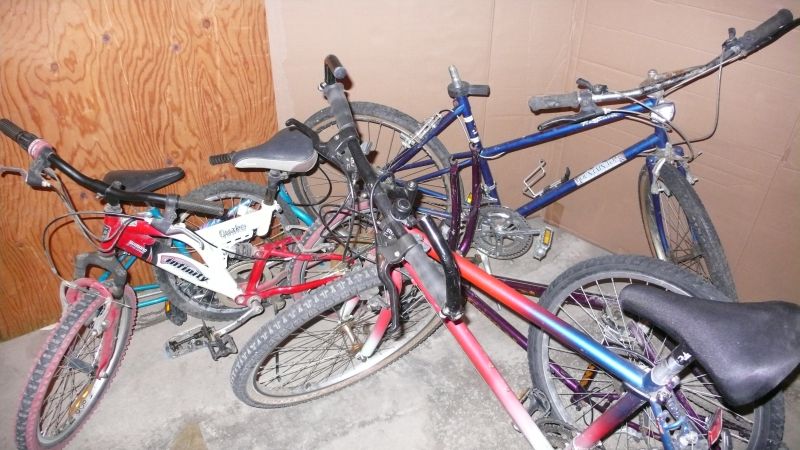

Frame:
Here are a few donor bikes I got for free/cheap:
I'll probably be using these two primarily. Red is a kids bike I chose because it has a 20" tire and some(?) front suspension. That was my entire selection process. REMINDER: I don't really know anything about bikes. The blue one is ancient and hopefully overbuilt. 3 rear dropouts:

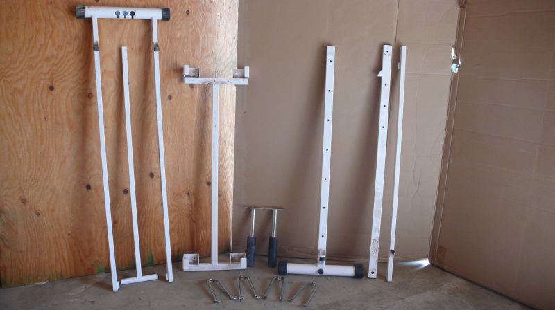

I also can get whatever scrap metal I want. This stuff came from Awkward Unwanted Workout Machine Hell. Most of the box frames are 3/32" thick. Some 7/8", 1", 1.5" square, some 1.5"x7/8". I'll probably use the 1.5" box as the main straight pipe from seat to crank. I know it's not optimal, it's what I have.
Who loves measurements? Everyone:
I measured pixels on my screen with a ruler and determined that 47" between tire spots is a good(??) distance. Then I MSPainted this, to proper scale to help me visualize what to chop/add:
Seat height? Other considerations?

Rear suspension, the little kids bike spring probably won't be enough? I think I'll have to move it. Rear suspension scares me because it stresses the chain, and I'd need to add chain tensioner thingies. In an upright the crank is before the pivot, on a recumbent, it's obviously after.
I think I'll mount the motor/gearbox to the frame, rear of whatever pivot I do have. But seat/batteries/cargo ahead of it. Should I try adding some angled front suspension (ala Amberwolf) rather than the little spring I have now?
Ideas?
Chain pathing:
Unforeseen challenges. Chain must clear from crank to rear wheels. Must cross above front forks or they'll hit it. Must go under seat to where it joins the motor. This is not a straight line. I'll need redirector things. Presumably extra rear-derailler-things (the preying-mantis arm parts) are okay for this? Might need beefier springs.
Ideas?

Great job detailing all of your possibilities! You mentioned using an s-frame and you mentioned not especially liking the chin down position (opposite of the head wrenched backward when aero on a diamond frame). Went through this myself - but still wanted to be aero as much as I could be. With the addition of a small sponge at the headrest, the chin down is actually quite comfortable. This position was extremely relaxed for a 100 mile ride/race I did a couple of years ago. The handlebar mirrors allow for excellent visibility behind, and, I have never had any issues with "not being seen" due to its height. Wheels are 20" and I can reach down to the pavement and balance myself when stopped. Below are a few pics of my position.
If you look close, you can get ideas regarding the rear suspension/idler (you mentioned the possibility of a motor in that area but had questions about how rear suspension might affect the chain..) Although not an ebike, I used a gear cluster on top of the boom along with a Schlumpf to get about 175 gear inches which should take care of any cadence issues with high speed and the 20" wheels.

I have been building/modifying recumbents since the mid 1980's. The perfect electric assist recumbent, IMO, would run dual 26 inch wheels (huge selection of strong, aero wheels, disc brake compatible, many tire choices), cranks 6-9 inches above the seat, cranks right over the front axle, ~56" wheelbase. A dual 26" version of the Verano...basically a FF electric motorbike.
http://lightfootcycles.com/products-ove ... ew/verano/
Recumbents are perfect for electric assist. The main frame can be a single large tube containing the motor, battery, controller, charger. An aluminum fabricator can bend you up an 5" wide, 8" deep channel, or you can fab it up with thin sheet, aluminum angle, and SS pop rivets. Guys have done them with birch veneer, and spruce strips, kayak style. Attach rear chain stays, and steer tube, from a donor bike. Buy a real recumbent seat, and steerer from Bacchetta, RANS, etc.
Frankly, I can't believe somebody isn't already selling this rig. Liability, and limited market, I suppose.

CrazyJerry wrote:I have never had any issues with "not being seen"
Well, #1 - I have heard many stories about low recumbents being invisible to cars, so, your opinion balances this in part but doesn't negate it.
#2 - My issue is less with me not being seen by others, than me being able to see. I am not interested in competition or racing. I do want to be able to see other vehicles, over hoods, as well as around at the scenery. Too low and even tall field grass blocks my view.
When I look at that second picture, I just don't like the look of the posture at all. Like I said, I'm aware there's tradeoffs for height, and I accept them. Difference strokes for different folks.
Gorgeous bike though. Looks great.
Thanks for the pics of the idler, ideas all help.
Warren wrote:The perfect electric assist recumbent, IMO, would run dual 26 inch wheels
Why? I've heard (questionable) claims to the marginal benefits of small tires, but none for big. Also, without a smaller front wheel, I'll have posture problems without even getting the benefit of lowered height.
What's better about a 26" in front?
Buy? *spit*. MAKE.
The Verano isn't to my liking. Seat looks very similar to whoever did the Yellow Bike and wrote the tutorial for conduit-bent seat frame. Got some more ideas off it though, thanks.

Being the bike noob that I am, could someone help suggest me, based on my design:
1 - What the wheel-wheel (on ground contact) distance should be? ("wheelbase?") Is 47" good/bad/long/average/short?
2 - What a good ride height for the seat would be, assuming a natural posture?
3 - How thick my frame should be, if I'm using any of that square/box tubing I showed from the exercise machines. It's not fancy chromoly or anything, just plain mild steel. I have no idea whether a 0.75" square pipe at 1/16" thick would be enough, or whether it should be 1" or 1.5". Not a clue.
4 - Front suspension, will the shocks from the red kid's bike be enough?
5 - Rear suspension, would the single coil/piston thing from the red kid's bike be enough (I'll be moving it somewhere)?
And also, any other "better watch out for this" or "make sure when you do this, you do it like this" tips that might not be obvious to a first time builder? Keep in mind, I don't even know the names for most of the bike parts and have never designed a bike before, so I'm perhaps shockingly ignorant/innocent.

MattsAwesomeStuff wrote:1 - What the wheel-wheel (on ground contact) distance should be? ("wheelbase?") Is 47" good/bad/long/average/short?
Seems kinda short, about like an average bike. Typically this is called an SWB (Short Wheel Base), and my guess is you'll end up with a HighRacer setup with that short a wheel base, with the seat up fairly high, nearly at that of the regular bike. But it depends on your preferences.
CrazyBike2 is nearly twice that length between contact patches, and would be considered a LWB (Long Wheel Base).
As noted above, that depends on your preferences for visibility and ease of seeing around you. Personally I don't really like being up at pickup-truck seat height, which is where most regular bikes put me. I prefer being at normal car-seat height, and that's about where CrazyBike2 is setup to put me.
The old unfinished ReCycle on my Electricle blog would've been a LWB Lowracer, putting me down where F1 car seat height would be. Aero efficient, but pretty hard to see and be seen. :(
Mostly, look at what existing frame designs that are similar to yours can use. If you see big single tubes, there's probably a reason for it. If you see smaller parallel ones with triangulation between them, that will probably work for you. If you leave out the triangulation in one that had it, then it probably won't work as well as it should, and may fail catastrophically. I recommend using triangulation in any frame as much as possible for strength and reducing flex, but sometimes you can't do it or it weighs to much, etc.
I also highly recommend using old classic 10-speed bikes for frame material, because many of them have long straight tubes of good cromoly that you can easily re-use, and it is very light and strong. Depending on the design you may well be able to reuse whole sections of a bike as they are, maybe bending tubing to match angles if they're close enough already. this site:
http://recycledrecumbent.com
has some handy info on that kind of thing, including splicing tubing from short sections. But this kind of tubing is very superior to the steel you've got on those ex-exercise machines, which is heavy and thick and often soft steel. I've used it and many other kinds of scrap steel to build things with, and given the choice I'd rather recycle known-good bike frames to do it with, even if I have to splice sections together.
Probably not, but it depends on your road conditions. If you have roads smooth enough to ride without suspension at all, normally, then yeah, they'll probably be fine. But if you have rough roads, you'll want "real" suspension, which you can either build (a little difficult and rather time consuming if you deviate from established designs) or find used (depends on thrift stores and other used sources in your area) or buy new (expensive).
If you re-use the rear shock, try to keep all the angles and lengths of levers the same, or the shock will not experience the same loading and won't give you the same travel/etc. as designed, and may not do anything at all. As it is it may be such a light spring that just the one would be totally ineffective, compressing fully as soon as you put your weight on the bike. :(
I've tried designing my own rear suspension for CB2 a few times, and not come up with something that actually works or that I like yet. Still designing my own for the rear of the new bike, too, but it is totally untested. Using an old dirtbike motorcycle-class shock on it this time, which shoudl easily handle the weight loads I will have, but it's big and heavy. Front suspension there are a number of ways to make your own, and lots of sources of springs and whatnot, but when you re-use a spring from something else, you must consider the original usage and loading on it to know if it might work on your own design.
I thought big singles vs. triangles was an arbitrary choice. That a larger pipe is stronger for the weight (thinner material, up until the "beer can effect" [real engineering term] occurs around 60-70+ diameter : wall thickness ratio). Or, triangles are stronger for weight when covering large areas. One is not superior to the other in terms of strength, each has to be engineered to the situation.

It's just been my experience so far that in what I've built, triangulated stuff works better. The only thing I've used a single-beam for so far that has ever had to carry much weight is my cargo pod rails on CrazyBike2, but even that wiggles and sways under loads.
Well, the problem is that I probably cannot find thick enough steel from existing bike frames, unless I salvage a recumbent. There will be no such thing as a straight pipe that is large and strong enough out of a diamond frame to be a single beam. So, my choices are: Recycled Triangular or New Single, but not Recycled Single.
The deal with triangles is that they have to be rather large to get the strength benefits out of them. Obviously a very narrow/pointy triangle will be no better than a solid single, perhaps worse for weight. And, because it's a recumbent, there's simply not much room for a triangle, which is why I presume most recumbents use a single.
I guess I'm going single until the seat using the crap boxframe, and then triangle-up everything rear of there.

Postby MattsAwesomeStuff » Thu Mar 29, 2012 11:29 am
Read a few hundred more articles. Some of which I even understood and could make use of. Lacking motivation, feeling swamped, grindstone time.
Part of the difficulty of this whole process is separating wheat from the chaff. Bicyclers are optimization nazis and it's never really obvious whether they're arguing and insisting on variable ranges that have minutia hairsplitting improvements that are clouding my brain, or whether it's something big like "Put the seat far enough forward or your knees will clip the handlebars", another should've-been-obvious thing I just came across.
Insisting on decisions and progress for tonight has yielded:
1 - 47" wheelbase unless I decide otherwise. Too many opinions. Don't care.
2 - On an upright my seat height was 39" and my head height was 68". My new seat height will be 20-23", and ride height 46-49". 19" lower than before. Great. It might be easier to pedal.
3 - My ass-to-heels measurement is 45". This helps decide crank-seat distance.
4 - Crank radius is 8". Worst heel radius on crank is 13". So, wherever I mount the crank has to be 13" away from the front tire/fender. This helps figure out the lowest front frame angle or length forward of the handlebars.
5 - I'm not screwing with a chainline that could strike the wheel. I'll raise the seat up a foot if I have to, which I won't.
6 - Seat angle no less than 34' (view/chin-chest annoyance) and no more than 52' (is apparently uncomfortably upright to pedal with feet forward). 40-ish sounds fine. Whatever. It'll be slightly adjustable without screwing up the ass-heel distance.
7 - I might be able to arrange for the rear suspension to pivot *at* the motor drive output using my own bearings. If so, no chain stretch issues when the suspension compresses on a bump. If not, maybe screw with chain stretch idlers on the upper chain on the front (human-powered side). If not, oh well, no rear suspension, hope the batteries and motor don't snap if I hit a bump.
8 - If I end up just using the drill gearbox as is.. I'm leaving the chuck. I'll carry a damned chuck key and this will be my clutch if I can't find/build this double-opposing freewheeling system that no one's got the hang of yet. If the batteries die and I don't want to crank over the motor while pedaling, I'll just loosen the chuck a bunch so I'm only spinning the 90' outboard gearbox prop and not the geardown/motor. Shouldn't be too often an occurrence anyway. One extra freewheel only to coast pedals under motor power simplifies a lot.
9 - No such thing as low-ish upright seat and low crank. Puts your crotch up near the steering pivot. Can't slide it all back, because then crank then runs too close to the tire and there's heel strike. If you want to move back, the crank has to move upward arcwise around the 13" clearance to the front wheel. Will settle for higher crank rather than lower seat angle or larger seat height.
All together... torso is scaled small, but otherwise measurements check out for something like this:
Purple is cargo rack/paniers and batteries. Green is motor. Dark green is reduction gearbox. Bluegreen is 90' gearbox. Handlebars are screwy 'cause I only had distances not angles and chose for distances to be exact while I eyeballed, and handlebars were drawn last.
Rear wheel isn't perfectly rotated, things will shuffle, didn't draw chainlines, but.. good enough for me to see that everything will work out.
Perfect and Never has yielded to Shitty and Sooner. Including my artistic abilities.

Postby CrazyJerry » Fri Mar 30, 2012 3:59 am
You may not be into lwb but your earlier draft shows a position very comparable to my modified Rans Tailwind. With dual 26" height is right up there so you would not have to worry about visibility, and the ride is like butter.

Postby MattsAwesomeStuff » Fri Mar 30, 2012 7:54 am
I don't understand. That's somewhat of a random post/comment to make. It's similar in that it's.. a recumbent? And the angle is not as aggressively inclined? I don't really see the similarity. I'd actually say your example is almost as dissimilar as could be. Almost completely upright and bottom bracket well below the seat. A random picture of any recumbent, such as those I posted at the start of the thread has as much or more similarity.
And yes, not into LWB, nor excessive ride height, nor dual 26", it's not what I've chosen to build since the start. I want short, car-transportable recumbent that's at a middle ground balance between the grampa-bike lawn-chair-on-a-rick-shaw and the speed-demon-road-hugger extremes. Low enough to make aerodynamic gains, high enough to avoid turning, visibility, or posture problems.
