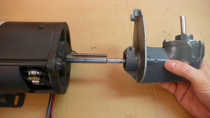

Also, the 90-degree outboard motor gearbox arrived today:
It is a 2:1 geardown, and quite small. The bottom bulb is half the size of my fist.
One complication, it has no bearings, just seals, and the gears grind badly if it's not aligned both tilt-wise and depth-wise. This is a pain in the ass but not insurmountable.
So, the motor might be a little bit overpowered. Bit of a difference in shaft sizes here...

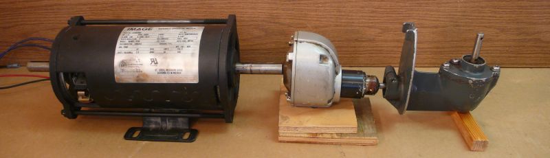

And the "completed" driveline:
Too much geardown as is. I'll have to remove, at least, one of the drill geardown stages.
As-is, with all 4 stage geardowns:
3200 RPM @ 130V.
90' gearbox is 2:1 so 1600 RPM.
The drill is 38:1 so 42 RPM
The drive sprocket will be ~3" and the rear cassette varies from 4.5" to 2.5", so, between 1.5:1 and 0.8:1, so between 28 and 53 RPM.
The rear wheel is 26"=0.66m or 2.07m circumference, so between 3.48-6.69 km/hour. Or, between a slow and a moderate walking speed. *Fail Stamp*
Kill one of the 6:1 geardowns in the drill gearbox.. 21-41 km/hour. Not bad. And if I use 170V instead of 130V like it's supposed to.. 27.5-53.7 km/hour.
Still a bit weak. I'd like a max speed a bit higher than that, batteries will drain too, so, maybe I'll upgrade to a 4" drive gear and increase those numbers by 33%.
Hrm, let's see if I get rid of the drill gearbox entirely, but pulse it on average at 130V still.. 126-246 km/hour (75-147 mph). Nope. Guess not.
4" drive sprocket it is. 37 - 71 km/hour (22 - 42 mph). Slower is not a problem, can do that electronically.
I guess the next step is laying it all out and start disassembling/cutting.

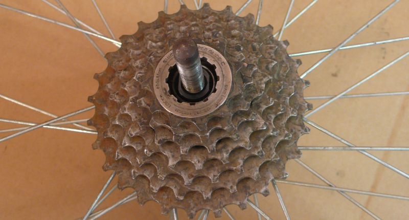

Trying to get at freewheels. Bike question time. I'm a bike mechanic novice.
Here's a rear wheel from a Shimano mountain bike:
Here's the rear stuff from a single speed kid's bike (with backpedal braking):
Both should have freewheels yes? I can't figure out how to get them out/off.
I've read Atomic Zombie's tutorial on freewheel disassembly, but I can't quite put the pieces together (or in this case, take them apart).
I believe the top one is a cassette-style freehub, and the second is a threaded freewheel?
Help?
MattsAwesomeStuff

Postby Warren » Thu Apr 19, 2012 5:27 am
The top picture is a cassette mounted on a freehub style hub.
http://www.parktool.com/blog/repair-hel ... el-service

Thanks Warren! I guess the whole cassette just slides right off the splines.
The lower picture appears to be parts from a single speed, coaster brake hub. No "freewheel" ratchet and pawl stuff in one of those.
So it's fixed like a kid's tricycle? There's no ability to coast? I figured it was a BMX type thing, with backpedalling to brake but still coasting when forward.
I have a couple others bikes I can gut for freewheels, I'll look into those next.
Thanks for the tutorials.

- Grabbed a couple dozen bearings from inside industrial copiers, none fit any of my shafts though.
- Took apart an old almost-junk grinder after I realized they must have 90 degree gearboxes in them, (it does, 3:1) and considered using it instead of the propeller gearbox (2:1) if I never add another geardown stage. But I couldn't figure out how to take the damned thing apart any further than the back casing.

MattsAwesomeStuff wrote:- Took apart an old almost-junk grinder after I realized they must have 90 degree gearboxes in them, (it does, 3:1) and considered using it instead of the propeller gearbox (2:1) if I never add another geardown stage. But I couldn't figure out how to take the damned thing apart any further than the back casing.
Post some pics, we might be able to help. Most come apart pretty easy, but also some of the cheap ones have so much lash (gear slop/wiggle) that if you really put a lot of power thru them you may well rip teeth off the gears with power from a bike motor. Also, they don't always use bearings in them, but sometimes just bushings, and those tend to be very worn in old grinders, and end up causing lash or other slop that wears gears quickly. I've got a harbor freight one that is trashed like that, becuase the bushings wore too much. Motor works great but gearbox is junked.
Keep in mind also that often the hsaft of the motor has one of the gears machined into it, meaning you must cut the shaft and create a coupler between it and the motor you are wanting to use.

- Tried to pull off the rear cassette like in Warren's linked tutorial, but they won't budge. I'm stumped, cone nuts are off, I can see clear through the other side.
First question: are you trying to get the sprockets off, so you can use them or the wheel hub (and it's built-in freewheel) separately, or are you wanting to use the whole freewheel mechanism on something other than the wheel hub?
I ask because that looks like a freehub type, using a cassette of sprockets that slide onto a splined section of the hub itself. The freewheeling mechanism is part of the hub, and is not easily going to be usable without the hub or at least some part of it.
Have you removed the locking sprocket(s) on the outside? Usually one or two of the smallest sprockets unscrews, or a separate lockring just outboard of all the sprockets. Depending on how they are made, it may require a "chain whip" to hold the other sprockets while you use the sprocket removal tool (splined with a nut built in for a large wrench) to loosen the small sprocket. Sometimes you just need the sprocket removal tool, turning against the locked freewheel mechanism (but it may require a very large amount of force / leverage to get it started--I've often had to use a hammer on the end of the wrench, while standing with my feet on the bottom edge of the rim to keep it from spinning).
Aha. I could not find a lockring, and I could not pull the cassette off. I wasn't aware sometimes the small sprockets unscrew first.
It has spline teeth but they're only 1/8" deep. So chain whip (chain-in-a-vice for me, since I don't own a whip), and I'll make a spline tool from a bolt. I noticed when I turn them backwards it freewheels and presumed that must not be how they come off. Duh, gotta hold it with a whip.
On the two cassettes I have here right now, both can be disassembled using the same splined removal tool that is used to take regular Shimano-type freewheel clusters off of thread-on hubs. I forget if I had to use a chain whip (chain screwed to the benchtop in my case) or not, on these, but on others I have.
It's not uncommon for me to find trashed bikes or wheels where the whole thing is rusted together, but I can still use sprockets separately if I can get them off--bolted or welded to other things for chain guides, tensioners, drive or receiver sprockets, etc. It's where I got most of the sprockets used on CrazyBike2's original powerchair drivetrain, and for the many failed attempts at chaindrive on DayGlo Avenger before that.
