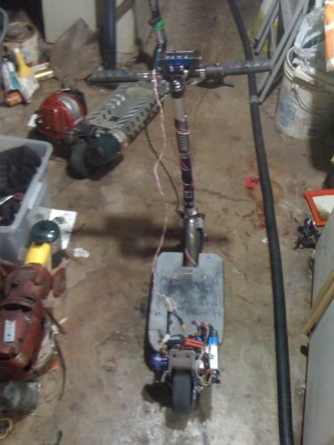

I wanted to share with you my scooter conversion process for electric power.
This is an old chassis of GOPED SPORT and RC electrical equipment
Installed components are:
*Motor : Chinese 6364 230KV from Hobbyking
*Controller : Hobbyking 190-200A
*Servo tester
*BEC
*Batteries : nano -tech 45C 5S 5A X2
Most parts were constructed of composite materials, the final weight is 8 KG.
The motor take me (80KG) easily and never warms up even on long rides.
Speed ​​is 25 KPH with a 1:5 gear and range is about 10-12 KM per charge.
I got it like this:

working :
(211.03 KiB) Downloaded 15 times
(134.57 KiB) Downloaded 15 times
after paint:
(140.17 KiB) Downloaded 15 times
(149.19 KiB) Downloaded 15 times
(140.69 KiB) Downloaded 15 times
Electronics box:
(152.96 KiB) Downloaded 15 times
(125.36 KiB) Downloaded 15 times
(140.11 KiB) Downloaded 15 times
(141.29 KiB) Downloaded 15 times
look bad .. so:
(127.88 KiB) Downloaded 15 times
(153.66 KiB) Downloaded 15 times

Postby Guy H » Fri Apr 13, 2012 6:07 pm
Green Machine wrote:Really sweet work. Not enough good electric scooter conversions anymore.
I am suprised you dont get faster than 25kph per hour.
Thanks for the compliments
Don't be surprised.. now I'm working on 5 cells instead of 6 , as soon as I change my battery I will get to 30.
I have transmission for power insted speed because I live in a mountainous area..
milesinfront wrote:Awesome job! Is the carbon cut from hard sheet, or did you 'brew' it yourself? Wish my scooter was 8kgs, but then again I'm aiming for 50km/h+.... :)
Thanks to you too
I cut the motor and rear wheel parts made from purchased plate (thickness is 2.5 mm)
Plate and the part for carrying made by me with 180 g/m carbon fabric
Consideration in selecting the components were made only by weight since I'm a student and need to take it with me between classes...
I have a few more projects which go much faster, hoping that soon I will have the time to upload them

there was not a heating problem because the transmission was for slow speed (25-30 km/h)
The engine stays cold even after long climbs ( My weight is 80 kg)
Because the RC equipment light and have good performance, I recommend you consider using it in small scooter ..

The reason that i didnt using RC motor,
1. This kind of motor have low efficiency 40-50%
2. Generate lot of heat , that lead to short life time.
3. Low torqe, and high RPM, all this system generate lot of noise.
Generaly, this motor did not designed for heavy loads.
But i fan of small things.
Maybe in my next design i will try combin motor like you have, can you give me link for specification of your motor.

40-50% is not quite accurate... you may be running the motor in not the best conditions to be getting that bad efficiency. The 6054 should be powerful enough, but if you're running near 30mph you might want a more powerful motor. One option is to take a lower Kv 80100, rewire as wye/star, and it should still cope with the power demands of ~2kw. RC motors are just BLDC motors, so they might be inefficient in the sense they're not the highest quality if purchased from a cheaper place, but they can be decent in the right conditions.
Definitively requires a lot of reduction. I've been told you want to replace the ball-bearings on the hobbyking motors if you're running above 5k rpms, but at 5s I guess you're running at 4k and might be ok. The high heat might be a factor of the smaller motor being stressed throughout accelleration in these high demands.
I hear you have some of the coolest scooter designs in israel! At least all the cool ones sn0rkal posts, seem to be from Tel-Aviv.
I think Guy-h is running something like the http://www.hobbyking.com/hobbyking/stor ... duct=18180

Postby Guy H » Fri Aug 02, 2013 12:18 pm
*controller is Mystery 200A with Bec (in project box under the deck)
*Battery is 3X5A - 6S total 15A
*turingy speed regulator
http://www.youtube.com/watch?v=gyQIzej8X2w
*Batt-man wattmeter (not in the pictures) work great!
http://batt-man.com/
*65 sprocket , 11 pinion
also made him rear wheel cover and freewheel as you can see in the pictures
