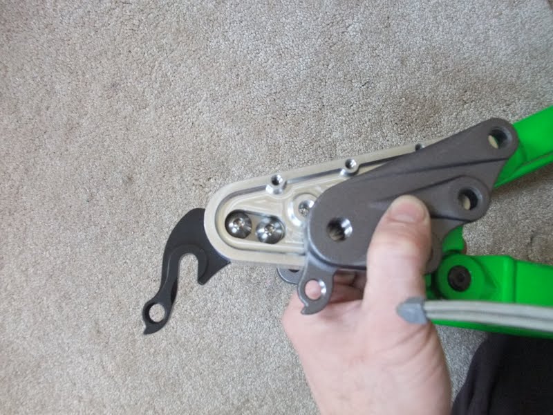

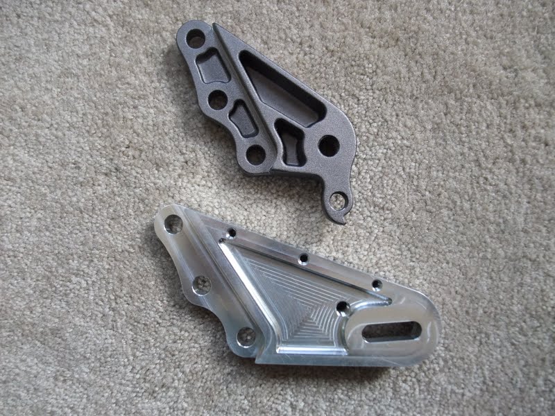

I bought the A-Line frame when I was bitten by the "replaceable dropouts" craze that hit several ES members this past winter. But from the start it was always a stretch whether other efforts would suit my needs: Most people were creating dropout replacements for hub motors. From the start, my plan has been to build the bike with a left-side RC drive and NuVinci hub. So my notional dropout replacements would be something like the two pictures below. My thought being, I can simplify my dropout design by using off-the-shelf modular components that give me dropout, derailleur (== chain tensioner) hanger, and disc brake mounts. These are pics pulled off the web that I used as a design guide:
So drawing on inspiration/ideas from Oatnet, Magudaman, Andje, Sn0wychild, and help from Adam333 and especially Fractal, my path led to a custom design of my own and fabrication by emachineshop.com (I plan to create a "review" thread of emachineshop.com in the near future - but the bottom line up front is it's a great service, thumb's up).
My custom dropouts give me about 3" more length and 1" more height than the originals. The right side replacements showed up Friday and the left sides should arrive early next week. Here's the thing mounted, with of course the original in the background:
Why the extra holes? Well they only added a couple of bucks to the order, so why not? The smaller holes on the upper edge (tapped for M5 bolts) are for possibly mounting a mudguard in the future. Anyone know a good 22" diameter, 3" wide mudguard? The larger hole is tapped for M8 and is there for whatever - I was thinking possibly a mount for a trailer hitch. I suppose if I was smarter I would have made the diameter and thread pitch the same as the original A-Line holes, making my A-Line dropouts literally able to accommodate a downhill hub as was original. Live and learn.
More pics:
The mount holes on the new and old are vertically aligned. Big difference!
Comparing the insides: I had some material cut out but not nearly as deep as the original. Strength over lightness. When in doubt, over design. Note the custom parts, when mounted, are 150mm between the inside faces. The bolt-on modular parts by (from Paragon Machine Works) are 7mm thick, taking me close enough to the 135mm spacing the NuVinci needs.
Comparing the outside faces:
One more pic of the dropout, mounted. It's a really tight fit! I had to do a light sanding in a couple of places, no big deal. These will be a bugger to take off- but I won't ever need to take them off, so I don't mind.
So I'm waiting eagerly for the UPS man early next week. Once I get the left side dropout assembly installed, I'll be able to mount the rear wheel and at least have a bike I can ride rolling down hill (electric and human power propulsion still awaiting some parts...)

MattyCiii,
Awsome build mate! Those dropouts are fantastic, so clean and an elegant solution! :mrgreen:
Going with a longer rear shock will more than likely need a longer fork to balance the height gain to keep your head angle where it should be.
It'd be worth looking into exactly how much extra length you would gain by going to normal DH forks, it may be less than you think as those Leftys look fairly long already.
Where as going to larger rims and tyres stands to gain you anywhere from 2" to 3" in height depending on your diameter choice.
I'd go with the bigger rims for sure. Someone on the site would surely buy your current wheels to help get back some valuable ca$h.
Just my 2c, hope it helps :wink:
Paul :D

Postby MattyCiii » Wed Apr 18, 2012 10:33 am
sn0wchyld wrote:hehe... 'i told you so' :mrgreen: sorry couldnt resist!
me: :oops:
sn0wchyld wrote:are you sure the shock is supposed to be in that way? or doesnt it matter? on my norko its got the resovware on the top. being round that way opens up some more space in the triangle...
In its final form I'd like to ride with the reservoir on the bottom, giving me more space in the triangle for LiPo. But until I mount batteries, I can play:
  • I can't presently use that "lower mount hole" because the reservoir will bump the cable mount points down inside the seat stay. Of course I can always just grind them off with the dremel tool...
  • What I can and should do is ride the bike with the reservoir up, and with it down, and see if there's any difference. That and comb the Internet for opinions. I'd hate to be using the shock wrong and ruin it just to gain a little space.
Timma2500 wrote:MattyCiii,
I wish! The problem is what I've built is so extremely specialized. Lefty hub up front is not standard - heck, the spoke length is different on the left than the right. In the back is a NuVinci, pigeon-holing that wheel into the RC build niche. So starts the "spare parts pile" so many e-bike veterans cultivate...
Timma2500 wrote:Just my 2c, hope it helps :wink:
Definitely!
etard wrote:...personally I would go with bigger wheels for aesthetic reasons alone, it looks kinda funky in current guise.
I second that! I thought I'd need all that extra room out back to fit my planned RC drive, but with it all built up it's clear I can spare at least 2" out back. Plenty of room up front too.
etard wrote:One option might be to put a bigger wheel on front and then use those two front shock mount holes to build an extension tower that would jack the rear triangle down an equivalent amount so that your head angle stays the same.
I really like that idea. It should not be too hard to fabricate said extension tower.
etard wrote:Another option is pegs instead of pedals.
When built this thing will be a beast to pedal, but (as all novice e-bikers say...) I do plan to pedal it a lot.

Postby adam333 » Sat Apr 21, 2012 2:55 pm
The price is pretty good.
Larger wheels. I think this is a no-brainer, upgrading to 18" moped wheels should gain me about 2" in height, right?
I would also consider bigger wheels personally. I'm using 26 inches front and back on mine and I like the fact I can pedal in curves. ( I "fake pedal" mine just to avoid drawing too much attention on the cycling trail :) ) Next step is to find a schlumpf rep that is still open in the Montreal region....
About your rack fixation on the bike, I used this system on my previous one, and had a lot of issue having it swing left and right with about 15 pound on it. I would go with something more stable personally. If only the controller is going there, it could be fine though.

Postby MattyCiii » Sat Apr 21, 2012 8:28 pm
Thanks Adam. I have 18" moped rims, tires and tubes on the way. Once they arrive, I can measure the ERD and get spokes. Then I'll be building me some new, larger wheels!

Postby MattyCiii » Wed Apr 25, 2012 9:34 pm
Measure twice, cut once.
Remember when I said this?
MattyCiii wrote:Larger wheels. I think this is a no-brainer, upgrading to 18" moped wheels should gain me about 2" in height, right?
About 5 days after placing my order for all the wheel parts, it hit me: moving from 16" rims to 18" rims won't gain me two inches in height, it'll gain me only one!
Epic Facepalm!
But good luck was with me. My source for rims hadn't shipped yet (order successfully cancelled), and the supplier of my tires had them on backorder (also cancelled).
So now I have 21" wheels on order. Let me do the math out loud this time: 21"/2 = 10.5" new radius. 16"/2 = 8" old radius. Subtracting gives me a difference of 2.5". Damn that was easy - wish I could have gotten it right the first time!

Postby doc007 » Thu Apr 26, 2012 12:20 am
MattyCiii wrote:Measure twice, cut once.
Epic Facepalm!
I think you should also consider the tire thickness. Some tires are low profile (ex. road racing) and others are high profile (ex. downhilling, freeriding). With thicker tires you could easily gain an inch on the radius.
ps nice dropout design im sure someone will buy those "paperweights" off you to help offset your initial investment. cant hurt to post an ad in the for sale section. good luck! looking forward to see how the build progresses.

Postby MattyCiii » Thu Apr 26, 2012 5:33 am
doc007 wrote:I think you should also consider the tire thickness. Some tires are low profile (ex. road racing) and others are high profile (ex. downhilling, freeriding). With thicker tires you could easily gain an inch on the radius.
Thanks Doc. My new 21" rim is only 1.6" wide. A narrower rim should force a tire to be somewhat taller compared to mounting on a wider rim. All within reason of course. I have a 3" by 21" moped road tire on the way, hopefully the combination will work! It's hard to find 21" motorcycle/scooter/moped tires much narrower, and I can't go much wider than 3" wide without bicycle frame clearance issues...
doc007 wrote:ps nice dropout design im sure someone will buy those "paperweights" off you to help offset your initial investment. cant hurt to post an ad in the for sale section. good luck! looking forward to see how the build progresses.
Will do! Of course I have a very small audience to market to - 2009 A-Line owners - but never say die, right? Hopefully this build will come together nicely - and soon - giving me something to show potential customers, mainly a nice component of A-Line owners wanting to go RC.
