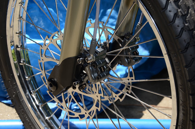

I'm also ordering spacers to move the dual front discs out away from the spoke-caliper interference. Hopefully 2.5mm will be enough. The other option is to go to larger discs, these are 160mm. The problem with going to larger disks is finding the mirror image caliper adapters. With duals I hope 160mm is enough disk area (at least for my riding style, Luke would melt them in seconds). It is sort of like a single 320mm disc. The problem is the caliper width is enough to touch the spokes now. It is hard to judge but 2.5mm may well be enough to clear it. Ebikes.ca have a 2.5mm spacer that I'll try first.

Postby Alan B » Sat May 05, 2012 3:20 pm
Front rotor spacers are in. Dual front 4 pot Gatorbrakes are on. They clear the spokes, which is the important thing. I need to find more spacers to get the calipers centered, but they will work now, they just drag slightly on one side.

Ebikes.ca 2.5mm disc spacer. Just what the doctor ordered for this caliper hitting spoke problem.
Dual mirrored four piston Gatorbrakes on 160mm dual discs. 320mm of stopping power. And not hitting the spokes!

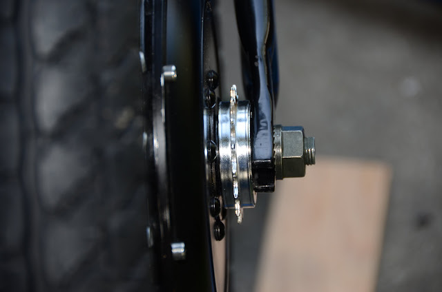

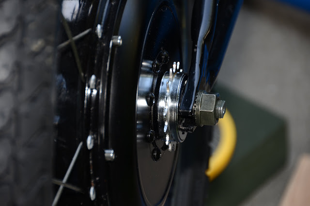

Postby Alan B » Mon May 07, 2012 1:11 am
Dicta freewheel is flush with end of motor threads, has run out of threads to turn it on farther but needs about 2.5mm freewheel spacer to rest against so it is not against the end of the threads. (edit - wrong, the freewheel is resting on a shoulder, no spacer is required or desired).
Dropouts touching freewheel. The motor shoulder is just about the same height as the freewheel threads so an axle spacer is needed. The usual ones don't fit these 16mm by 10mm axles, so "C" washers with OD of about 25mm need to be fabricated.
Dropouts touching brake mount even without disc installed. "C" washer needed here to allow cable clearance and space the dropouts out.
It's a roller, sort of. :)
Need some spacers.

Postby Alan B » Tue May 08, 2012 1:08 am
I ordered a rear shock.
Looking into "C" washers for the motor. May have to make them. Need 25mm od, 16mm axle, 10mm slot, approx 2.5mm thick, one for each side.
Brake washers and freewheel spacer on the way, as well as "nut" for the threadless headset cap.

Postby Alan B » Wed May 16, 2012 10:15 pm
Freewheel Info
I tried to measure the freewheel edge to end of the Cromotor's threaded freewheel mounting tube, and it is essentially flush. I also tried to measure the inset of the axle shoulder, and it is not easy to measure, but it is very slight. I didn't get a good reading, but it appears to be a small fraction of a mm. So I gave up on measuring them and took some photos:
Alan B

Postby acuteaero » Thu May 17, 2012 12:35 am
Hey Alan- Love the photos- great combo of pretty parts and good camera/technique :)
Looks to me like the FW side could use regular flat washer(s) between the axle shoulder and the dropout- 5/8 nominal size would likely work out fine- does this seem right or reasonable to you?
When I'm making up the prototype C washer out of aluminum, 1" OD, what would the most optimal thickness be? Still ~2.5mm? I may be able to do this before the end of the week, for dead certain before the end of next week.

Postby Alan B » Thu May 17, 2012 1:49 am
A regular washer should work, though it doesn't get quite the shoulder support that a "D" or "C" washer would.
I grabbed those pics this morning before I went to work, I'll try the same on the flip side in tomorrow morning's light and verify spacing. How much clearance between the hub and the dropouts is prudent? The dropouts are about 130 mm and the motor is wider than that, so I will be bending dropouts outward slightly. I'm trying to minimize that but we need enough clearance.
OK, I just went to the garage and used a flashlight plus an off-camera slave flash to get some shots of the wiring side of the Cromotor. There is a bit of axle shoulder beyond the disc brake flange. Aboutn 1mm. So the washer needs to be disc plus screwhead thickness plus dropout clearance minus the approx 1mm to work with a disc, or just a couple of mm to work without a disc. I don't have the rear disc to measure yet, and I don't know how the disc is going to line up with the chainstays. Ultimately it might need a bit more washer width, but this might decenter the tire if it gets too wide.
So 2.5mm is about right for no rear disc, but more is needed for the rear disc. I don't have to start with clearance for the rear disc, though it might be smart to start close to that.
Here are some quick shots of it:

After returning from the Maker Faire I set up the Borg and re-spaced the front calipers, ending up with 2.10 mm of spacers.
Then I changed over the temporary steel bolts for stainless on the swingarm.
I tried a 5/8 washer on the motor's freewheel side and the OD is too large so it hits the threaded freewheel tube. The washers are needed to install the hubmotor wheel.
