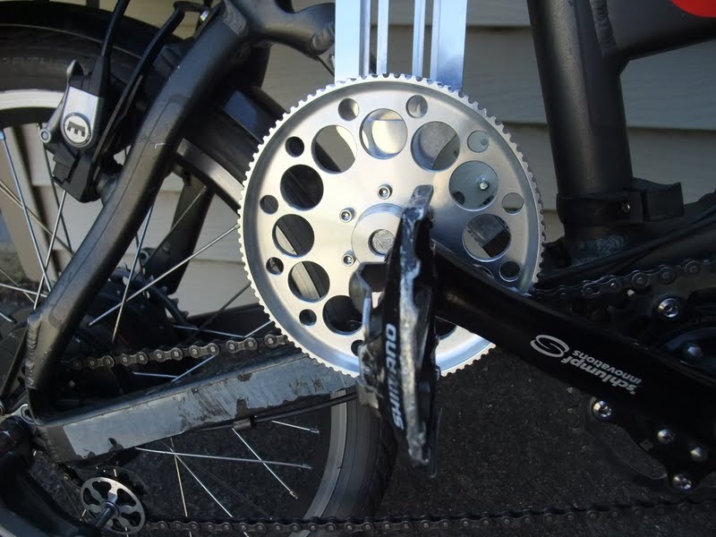

Postby MattyCiii » Sat May 19, 2012 8:22 pm
OK, that pic above looks painful: The motor is in contact with the suspension triangle, the seat stay and the shock. This is the worst case scenario, and to get the pic I let all the air out of the shock. But, it's not bottomed. So I'll have to figure something out. Here's a closer look:
I'll consider grinding some material out of the vertical member in the rear triangle. I don't think it supports as much stress as the other members. That, and I'll keep the pressure really high on that air shock. The suspension on this bike is to take the bite out of potholes, not for any serious off-loading.

Postby MattyCiii » Sat May 19, 2012 8:36 pm
I see why electric bikes is a hobby that brings out the passion. Everything is a compromise, strength, weight, price, location... Everything is at a premium. For my build, every millimeter counts. Here's a couple of shots of my e-drive chain line:
Gonna need a chain tensioner to get the chain line on top of that lower chain stay...
I don't have a good shot of the alignment, but as it stands I need a shallower sprocket adapter, or I'll have a chain line that's off a few mms. I can't bring the freewheel closer to centerline without losing meat to clamp to. I can't bring the rear chainring out from centerline without the chain rubbing the upper chain stay. Stuck, in the middle.
Here's the belt reduction on the right side of the bike. Note my neutered Norco A-Line hiding in the shadows to the left. Anyhow, the belt-drive fits in nicely between the arc of the cranks and the pedal-chain line

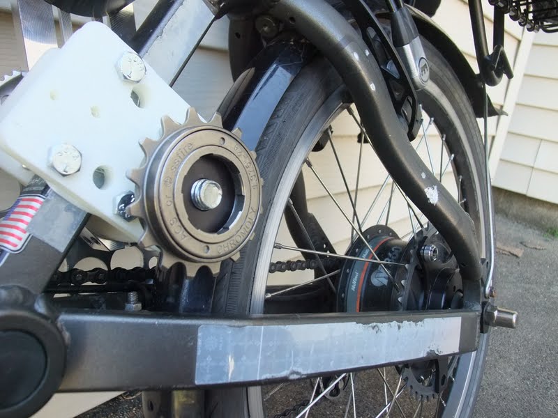

Postby MattyCiii » Sat May 19, 2012 8:41 pm
3mm is enough right?
So much for stealth. Maybe I can have that belt pulley anodized black. Though I'm also considering making (commissioning actually) an enclosure for the belt drive, for visual and audio stealth and protecting the pants from high-speed running gear.

Postby MattyCiii » Tue Jun 05, 2012 5:40 am
OK, to improve my reduction ratio and live better within the room I have available for a chain line, I'm going to swap that freewheel you see above for a 13 tooth
Available from multiple sources probably, but at the very least from FFR Trikes:
This freewheel has a smaller inner diameter than the 1 3/8 typical freewheel, so that means I'll have to get a freewheel adapter - this is harder to source, but also available from FFR
Edit: I originally wrote the below. And was completely wrong. I will not need to flip the freewheel or its adapter! :oops:
MattyCiii wrote:It appears I can probably get away with mounting the freewheel "flipped" - so the grub screws are on the outside - which will place my threads and freewheel pawls working in the correct direction. To do this I'll need:
1) A longer shaft. Presently I'm using cheap soft nickel plated all thread to model everything and thus estimate the distance. Once I can get good measures I'll source a new shaft with the correct/longer length. It needs to be about an inch longer.
2) I'll need a custom spacer. See the top pic from my previous post. With the freewheel threaded on, about half of its depth sticks out from the depth of the adapter. This will need to be spaced at least 1-2mm away from the shaft collar. So, I'll need to find or cut a 1/2" ID by ~3/4" OD spacer just long enough to fill that gap. I'll take some pix to illustrate, next time.

OK, a little bit of catching up.
My mini freewheel adapter and freewheel arrived. I selected the ACS Crossfire FWs instead of the Odyssey shown above; I already own the ACS removal tool, so I'm trying to standardize.
I've been riding the bike on and off with more and more of the drive mounted. I've ordered a longer shaft tube (cut to size by online metals.com). I needed an additional 6mm over what comes standard with the V4 drive. The shaft itself has flats to support flexibility in drive mount width - so I'm taking advantage of this and hopefully don't need a new shaft. Here you see it recessed into the FW adapter by that 6mm I need...
With my current parts placement there's a great chain line, and I have about 4.5mm clearance for the large belt pulley on the left side of the bike. What makes the chain line possible is using 5mm chainring spacers, to offset the chainring toward the centerline of the wheel. First I tried a 60t chainring I had laying around... Not exactly stealth!
The 60t is too big for a good chain line. Other practical matters, like putting air in the tires, suffers too. Next up: 53t. This one is black and has a bash guard.
I finally got off my duff and installed the belt (not easy to see, it's on the other side). But this was crucial - if I can't get the motor to sit where I want it to with the belt on, I need to research, buy and wait for a new one. As it turns out the stock belt will likely work just fine! Here you see it with the shock just about bottomed. I let all the air out of the shock and use a come-along strap to sinch the shock down to minimum. See how the motor still has space.
Here's the right side of the bike. Suddenly I have an overpowering desire to have the V4 drive parts anodized black!

Two thoughts:
1) Not a lot of chain wrap on the pedal chainring. Maybe that can be solved with a chain tensioner between the motor and the pedal chainring. That will also give more chain wrap to the small motor sprocket
2) Unless the motor has really low KV, and is run with low voltage, you will need some reduction.

Postby MattyCiii » Fri Jun 15, 2012 8:49 pm
crossbreak wrote:Why don't you run the motor power through the NuVinci?
I'd love to, and some day I might. But for now, it's all about reliability. Powering through the NuVinci would mean both human and e-power through one chain. Complex arrangement at the drive sprocket. Extra stress to NuVi freewheel and internals. Too much risk of something breaking
In contrast, putting e-power on the left means I have two fully independent power sources to get me home. If "one side" should fail, I can detach the chain on that side at the master link, throw it in the bag, and get home on the other power source, no sweat.
That would violate rule #1 for the build of chain drives: never put any chain tensioner into the tight span of a chain drive
I hope the chain wrap will be ok the way I designed it already. A normal bike sprocket of a shift drive does not get more chain wrap,too and it still works. A chain guide which prevents the chain from falling off would be a possible solution.
The chain wrap of the crank chain ring is a concern. I just hope it will work with the chain tensioner right behind the chain ring.
I want to use a 36 front driving Q128 hub motor with 200rpm @ 36Volts. It has a 1:8 planetary reduction, so the inrunner should runs @ 1600rpm max.
The hubmotor gets a 16T sprocket, the 3-speed hub a 15T, the crank chain ring will have 44 teeth. I wanna start the project next month when I have the money for the folding bike.
I understand your concerns. But driving the power through the Nuvinci would gain you a hill climb ability improvement of 360% with the same top speed in theory :D
