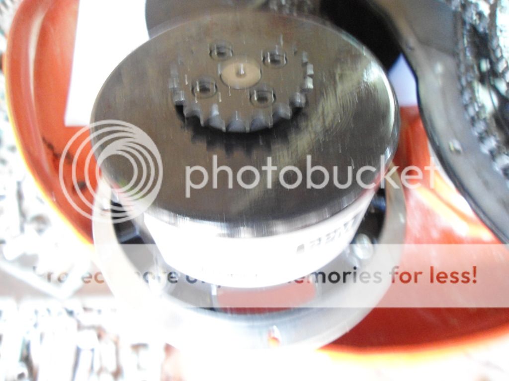

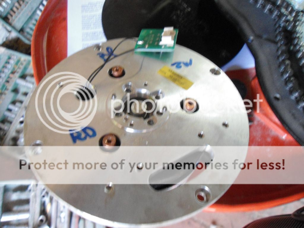

I am new to this forum ,but recently i bought myselve a pg bike black block dark basic ,i am aware that the members on this forum say that the pg bike is seriously overpriced and the the blacktrail of course is. I bought my example new from the importer in the benelux for a very good price because now there is a newer model the black block 2 .I use my pg bike for driving to work every day and i have the 45km/h examle so it takes me 40 minutes to do almost 30km one way.
I already took the drive gear from clean mobile apart to see whats inside and i thought some of you would be interested in seeing the inside.Here are some pics to see more details .

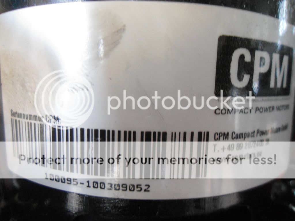

Thanks for the pics and welcome!
Now we know they use a CPM motor..
