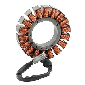

Postby magudaman » Thu May 24, 2012 1:46 am
Ok so building the core and such sounds like headache. So has anyone tried using a 3 phase motorcycle stator as our core?

Re: Machining a Brushless motor design
Postby Jeremy Harris » Thu May 24, 2012 1:54 am
I have a motorcycle alternator here that I wanted to rewind, fit with neo magnets and turn into a motor, but when I took the epoxy coating off I found the laminations were really thick, around 0.8mm, so the losses would have been way too high for a motor.
Machining the bearing support, can etc is pretty straightforward, I think the sticking point is finding a source of high quality laminations. I believe the power croco people get them laser cut, but suspect that the cost is quite high.

Postby Arlo1 » Thu May 24, 2012 8:38 am
magudaman wrote:Ok so building the core and such sounds like headache. So has anyone tried using a 3 phase motorcycle stator as our core?
Yup lol the Lams are thick and cause heat at hi rpms. You can get ~6000 rpm max with a motorcycle stator. I was aiming for ~12-13000 rpm so it did not work for me, now IM workign with iron powder (SMC) stators. Here see this thread viewtopic.php?f=2&t=28748
You will find with a motorcycle stator they are wound different then you will proly want them. Its going to depend on the number of magnets.

Postby Lebowski » Fri May 25, 2012 5:58 am
This is the perfect picture of a bad stator ! Look at how much extra room there is left for more copper ! Thicker wires
would have given the same motor properties but with lower resistance, so with lower losses.

Postby Chalo » Fri May 25, 2012 12:02 pm
On the other hand, thinner wires keep the intense parts of the EM fields close to the ferromagnetic core. Maximum copper fill is probably only the best choice when you'll be pushing a motor to its limits. Folks here do that a lot, but designers of other electric powered gizmos may not have it as a design goal.

Postby Miles » Fri May 25, 2012 12:15 pm
Chalo wrote:On the other hand, thinner wires keep the intense parts of the EM fields close to the ferromagnetic core.
I don't think it makes any difference.

Postby Jeremy Harris » Fri May 25, 2012 12:41 pm
You're right, Miles, it doesn't make any difference. These motorcycle alternators are built right down to a price, with thick (cheap) laminations, poor copper fill (so they can machine wind the stator) and ceramic magnets (again because they're cheap).

Postby flathill » Fri May 25, 2012 2:55 pm
Jeremy Harris wrote:You're right, Miles, it doesn't make any difference. These motorcycle alternators are built right down to a price, with thick (cheap) laminations, poor copper fill (so they can machine wind the stator) and ceramic magnets (again because they're cheap).
It does make a difference. It is just so negligible it shouldn't be taken into consideration.
