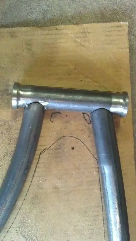

So!..First up i needed a 1 1/8 inch head tube, i have a couple here however both are mild
steel, i want this frame LIGHT so decided on using a piece of 4130
fyi: all pics for this build log are taken using my HTC Sensation's camera...
I knocked up an extended fork i had laying about to use as a basic 'jig' to align a set of
steel cups correctly, so they could be welded in place-->
The end result was a nice light head tube with inbuilt steel cups! granted it will require 'major surgery'
if these cups ever wear out and need replacing, the amount of use my bikes get though lol
hell will freeze over before the cups wear out LoL..

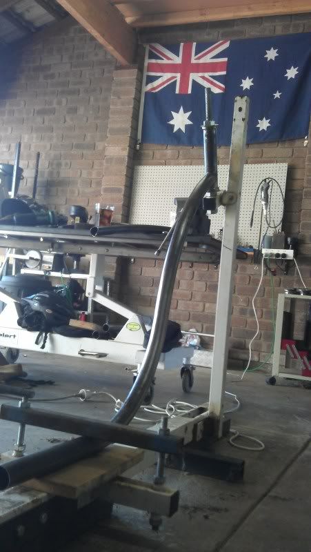

Thanks to ThuDs efforts i.e purchasing packaging and posting a roller bender he obtained
for me from Harbor Freight
, i can now bend the tubing, kink free!!
This 4130 cuts like hot knife through butter using thin cuttoff disks on the 5inch
angle grinder but, bending the stuff though, sheeeet its a task and a half!!!...
A Good mate and I were swinging off the wheel on the bender so much
it clean snapped the spokes straight off the hub on the bender, the connection of the spokes
has since been reinforced-->
Thanks to good buddy Snapper for doing this at Benginnerings workshop..
with bender repaired, the remaining tubing for the construction of the front half of the frame continued-->

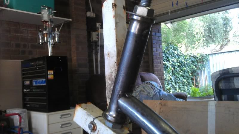

The front downtube had to be done as it also was on the first frame, in two pieces
I have traced the outline of the old frame onto a sheet of cardboard, makes it easier
to ensure the bends are accurate, i want it as close as possible to the former mild steel frame...
Using a small piece of 4130, i made a slit along its length so i was then able to slot it inside
the two pieces of tubing at the join-->
Sleeved and ready for welding, should make for a very strong join imo...

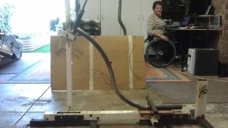

One of the things i wasn't happy with on the first frame was the seat tube bend, it was full of kinks and not
bent so it 'followed' the circumference of the tire correctly, with new bender, i was able to
achieve a nice flowing kink free bend, the following pic is where i am currently at
in the fabrication process-->
The frame jig has been pulled out from 'storage' so i can mount the tubing and get the front
half of the frame assembled, i want to get this done today, some may have noticed
the smaller horizontal tube 'missing' in above pics, this will also be added, to-day ::fingers crossed::
I shall update this worklog as i progress through the build, i want to knock this over as fast as possible

I have the bike in the jig and am welding
it up, i took a couple of "teaser" pics yesterday, i was slowed slightly had to 'redo' the head tube
profiling to get a better head angle or i would have had it all together by this time
i wasn't happy with it previously now, its dead smack on what the old frame was, which was perfect
for the Mazzochi forks im using.
a few shot showing the profile on the tubing, done with flap disk on 5in angle grinder-->
Mounted in frame jig ready for tacking-->
Yup hehe i even got my flags hanging in Karans garage LoL
She came home early yesterday and worked from home, booted me out of my wheelchair and took over
the "central command" station in the workshop HAHAHA

So today was very productive, for my speed, i got the entire front half tacked then fully welded and all but one joint
"cleaned with the air die grinder... I dont have photochop on the lappy out here in the workshop so ill just
whack all pics up one after the other, also have a couple bois over for a beer so can't be too unsocialble..LoL
Gotta say this thin walled chromo took a bit of getting used to in the welding department, i thought i had the welder
set up good worked GREAT for tacking, hrmz..start doing more than a couple of cm run the metal heats up and BAM
holes... I went through alot of scrap before i was confident to tackle the welding of the frame, i have the entire
front half fully welded and all joints run over with the air die grinder, they will be invisible once powder coated
:P take that you TiG lovers tehehehe... :mrgreen:
The front half, guys, its SOOOO light i couldn't believe it when i first pulled it from the JiG and felt the weight
this is going to be ONE light ride!!
