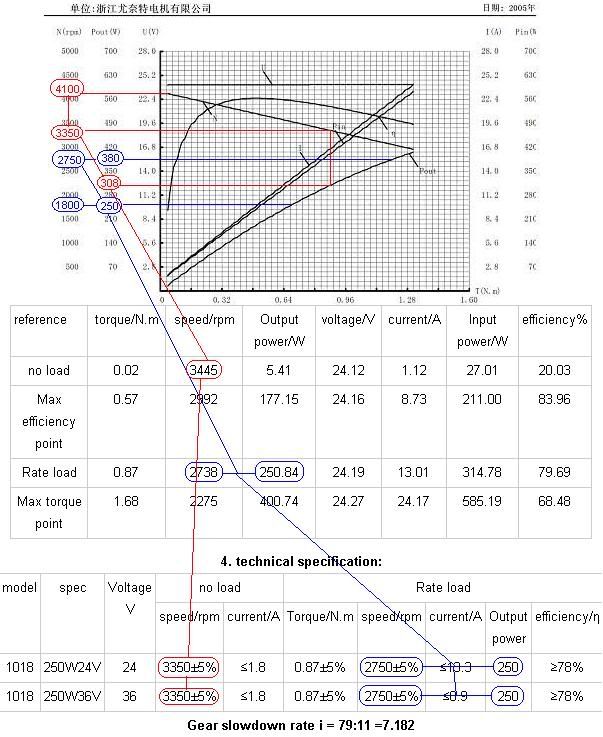

Values for customers!
Create the reputation, pursuit the excellence.
Get punch in the face here.
Does anyone have real world specs for the MY1018?
Something like actual no-load rpm would be nice.

I see the problem.
Their charts don't match their stated numbers at all.

Postby Mathurin » Mon Apr 16, 2007 9:57 am
Hey Tyler,
How about... A speedo mounted on the rear wheel, output in km/h & wheel circumference set to 166.66cm? That way, when the computer displays a speed of say 30.6 km/h, it's measuring 306 RPM. Otherwise the RPM could be figured out of indicated wheel size.
Then check the no-load full-throttle RPM with the batteries at close to 24v as possible. It's probably safe to assume it's burning ~40w no-load. I'd also need to know the number of tooth on the motor & wheel cogs.
If the Unite graph is accurate, the motor should be spinning around 570rpm

Postby TylerDurden » Mon Feb 25, 2008 10:19 pm
Mebbe that is GHETTO P.
Here ya go:
(70 links in the e-drive chain) * (72 chain revolutions/min @ full throttle)
70*72=5040 links/min
9t cog
5040/9=560 cog rpm
motor reduction 7.182 (as per unite)
560*7.182=4022rpm
4022rpm wheel-up
