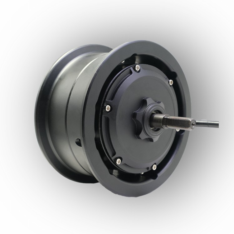

I am looking for a good hub motor for a DIY project. The idea is to build a scooter which is faster than the current available scooter on the market like the Dualtron X, Weeped SS, Zero 11x. I know there are also the very expensive Rion scooters which play in a different class.
I am planing to use the ASI BAC 8000 and to max it out with a 20S10P Samsung 40T battery combined with a smart BMS like the Speedict 150A.
I will probably take a bare bone chassis with dual hydraulic suspension, dual hydraulic disc brakes (Magura MT7) and install the dual motors and electronics.
Peak power should be about 180A-200A total battery / 160A per motor at 72V.
Top speed >100km/h and the range will be ~100km
I have found Lunyee motors like these two so far
https://www.alibaba.com/product-detail/12-Inch-60v-72v-84V-96v_60784576503.html?spm=a2700.galleryofferlist.0.0.649f45a2092blq&bypass=true
https://www.alibaba.com/product-detail/Gold-color-60V-3000W-65km-h_62346967225.html?spm=a2700.icbuShop.41413.29.4c3057d4NgXTOH&fullFirstScreen=true&bypass=true
If you have any better suggestions, please feel free to share.
PS: It should be BL, gearless and with hall and temperature sensor in best case. I plan to run it in FOC.
