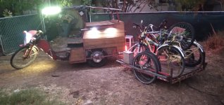

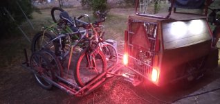

Still in design phase, sketches attached.
It will have an enclosed and insulated area 4 feet x 4 feet x 4 feet, so just a little wider than the last one, and about the same length.
Basic frame design is nearly the same as the Mk IV, just wider and with enclosure between the wheels, which had been planned for Mk IV anyway, just never done for lack of time and the right materials for that plan.
1 inch square tubing for the framework, with some solid rod and/or cable with tensioners for stuff that only stays in tension (is a little lighter that way, as this will be quite heavy even unloaded).
Metal grillwork as cage inside the insulation, to prevent dogs from digging thru (ones I have now dont do that but I have had some that would, and could have again in future). Theyre big enough to dig thru even plywood if they wanted to (Nana did).
Insulated panels will be removable so they can have a view (and people can see them, too) for the half-year its cool enough to do that. Rest of the year the insulated panels would enclose the entire trailer box to keep the heat out. At least 1 inch of styrofoam between plastic sheets, most likely, possibly in a wood frame to make install/removal cleaner.
Air conditioning:
I have a harbor freight inverter that might be able to handle the smallest window A/C unit I have. Theres reports on the web of people using it for larger shop tools, so it might be able to handle compressor starts.
Itd run off a pack of EIG NMC cells like the trike itself does. All this stuff would probably weigh almost 75-100lbs by itself, depending on the battery size needed for it, and the extra mounting hardware to set it up on the triangular frame just in front of the big box, behind the hitch tongue.
If I could find an RV-type A/C unit being scrapped out (but that still worked) Id put that on there, but not much chance of that. Theyre too expensive to just go buy something meant to run on DC, unfortunately, and I think that all of my window A/C units use capacitive-start/run compressors (I could change teh blowers to DC types, but I cant do anything about the compressors).
So if the window A/C unit wont run off the inverter, then Ill have to work out some evaporative cooling method, like a mini swamp cooler.
Either way, Ill be putting a wired-remote thermometer of some kind in there, so I can monitor temperatures on the handlebars during a ride, in case something goes wrong, so I can stop and deal with it.
Wheels:
I have two realistic easy options, with parts I already have. The first is just to take the axle out of two bike wheels, and install them both on a longer axle (like solid or threaded rod) that goes thru both of them. Most likely Id take out the regular bike bearings and use cartridge types, just to make the whole build process easier with parts I already have, without finding threaded rod that fits the existing bearing-cup type axle hardware.
Basically two independent bike wheels (26 inch, as I have enough of those, and bigger diameter is better rolling/ride) on a single axle. Provides redundancy in case of flats, and spreads the load out under normal conditions. I have some old knobby MTB tires that will work, though Id prefer fatter ones for a better ride, but Im pretty much out of repairable tubes, so I would have to buy those, which likely adds up to $80 to the cost of the trailer.
Second, I could use the pair of motorcycle wheels and tires I have. Tehyre basically like cast wheels, so much heavier than the spoked ones I wish I still had (that appear to have vanished after the housefire 5 years ago, probably stolen). One is probably a 19 inch and the other probably a 21 inch, a front and a rear off the same bike. IIRC they still have their bearings, just no axle, so Id have to come up with a solution for that.
The tires are so thick I could possibly pull the empty trailer even if they were flat, though not likely with the dogs in it. But theyd be nearly bulletproof for my application, and they are designed to take this kind of weight and more. The catch is they probably add another 100lbs to the trailer, between the pair.
More later, as I work it out.

Theres a few bicycles Ive seen around the web with dualies, usually trikes, but a couple of trailers. Some interlace the wheels, spokes from one hub going to the other rim, some use special hubs built for the purpose, and some just do what Ill be doing, two regular wheels on one axle, independently rotating.
I also ahve a pair of motorcycle wheels I might use, but theyre each as heavy as the Mk IV trailer, just about. :/ Would probably be essentially failure proof for my purposes, though.
Some more thoughts on cooling. I sketched up an evap cooler that could run directly off a 48v / 52v battery, as I have a couple of 48vdc box fans, and I think I have a 12vdc water pump that could provide enough pressure to force it thru misters rather than just a dripper (and a 48V-12v converter). I definitely have plastic tubing or pipe that could be used for the drippers, and I think I have some misting heads for garden dripper-sprinklers left.
Have to come up with excelsior for it, but I think I have some in a portable AC-powered evap if I still have that unit. If not, it hsould be cheap enough to buy some. Dont need much, for an evap the size of a tiny window-A/C unit.
Have to come up with a water tank. If I use something that can be pressurized, I can use a tire air pump thru an old innertube valve to pressurize the tnak to push the water out, rather than using a water pump.
Soda bottles would be one easy thing to use, if I put the valve at the bottom end and the water fill/exit at the cap end. Just have to figure out how to get the valve off an old innertube down into the bottle and secured from the inside without cutting the bottle open (other than the valve hole itself). Can even use several bottles in parallel if a lot of volume is needed.

The piano pick up went just about as planned, other than several boards of the decking (old pallet wood) not being up to the task. Stayed tied down fine, just harder to get off the trailer when I got it home (havng to lift it's wheels out of the holes).
Was really really hot out there though (112F last time I looked before it got just a little cloudy past noon; it got hotter after those went away). So I had to do some resting up after i got back before getting on here and posting this stuff.
As promised, pics:
First, those of the whole setup loaded with the piano, just after getting home.
Next, those of the setup unloaded, once i finally got the piano off. The ramp as it is above is designed specifically for my heavy-duty dolly, so I can't accidentally roll off of it with the wheels--just pull it up the ramp and lay it down (or stand it up) with whatever heavy item is strapped to it, then strap the whole thing down to the trailer.
Really heavy stuff I can use a pair of cargo ratchet straps to inch it up the ramp, cranking one strap tight utnil it's reel is full, then the other, then resetting the first, etc etc until it's up on the deck. Tha'ts how I loaded the piano, though ti was complicated by it's size, so it actually dragged the baseplate of teh dolly on the rails (since I couldn't tilt and roll it up) once it was around 1/3 of the way up the ramp.
Because the rails have threaded screwholes (they're rails for a 19" rackmount cabinet), I can make a "solid" ramp out of some plywood I have here, that bolts to the rails, sitting between them, just under the metal flanges with the holes. That leaves the rail guides for the dolly in place and available, but gives a regular ramp too. Didn't have time to do it today, but it would've been handy if I'd had it, to get the piano off when I got home. I can also add further hinged framework at the edges of the trailer deck and rails that allows a full width ramp, with more plywood between them.
Presently the taillight/signal lighting bar is bolted to the bottom/back of the rails, so it faces rearward when the ramp is up, and faces down under the ramp when the ramp is down. For cases where either the load is long enough (like the piano) that the ramp can't be raised, the lighting bar unbolts (one wingnut and screw on either rail) so it can be strapped / etc to the back of the load instead.
No provision for the SMV sign yet.
Some construction details:
I did not have time to build the same hanging-deck type framework for the outboard wheels as I did for the inboard, so I just ran a straight rail at just below axle height for the outboard side rails, and connected it to the inboard outer rail (now the center rail) and by a short horizonal strut at each end, and a diagonal down to the main deck. At the rear I left the vertical of the center rail at the height the metal started at, because I might add to it for the rear ramp to "pin" to, later.
I added a horizontal strut from the front of the front stiffening rail to the upper rear face of the hitch tongue, so there will be less tendency to flex that area as I brake/accelerate and hit potholes/bumps. It made a big difference with the piano on there (without that strut, I've seen it flex even with just Yogi on it, and he weighs probably a fourth or fifth of the piano).
This is the rod used for triangulating that center rail, from teh forward top rail down to where the axle-deck hanger tubing meets the deck.
These are the dropouts of the outboard wheel vs the inboard. Top pic is the right side, bottom wheel outboard, offset to the rear. Bottom pic is left side, again bottom wheel outboard, offset to the rear.
Other assorted pics:
