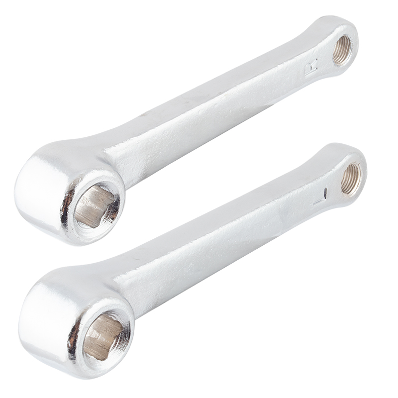

I’m after a pair of offset jis /square taper crank arms either forged or billet aluminium,max length 150mm .
I’ve found Lekkie Buz Bars which would be perfect but they don’t do smaller than 160 .

If you mean fancy crank arms, maybe somewhere that sells BMX racing (as opposed to freestyle) equipment. You may be able to find Mini or Junior class cranks that have square tapers and are designed for plate-type chainrings, and thus don't have a spider.
If you mean the same quality as your mid drive, then unicycle.com will do fine.

Jay73RX wrote:
Jan 10 2021 1:53pm
I’m after a pair of billet crank arms both with offset and max 155mm square taper but struggling. Has to be individual arms no spider
I used 152mm unicycle arms on my BBS02. Very square (minimal offset), forged steel, extremely reliable and inexpensive (like $15 retail).
https://www.jbi.bike/site/product_detai ... mber=21521
I intentionally chose low offset arms to minimize tread width. Steel construction increases stiffness a lot, and minimizes the likelihood of a crank working loose due to reversing torque through the interface.
These are also easily obtainable in 127mm and 102mm lengths. Post-trade war pricing is about $20.

These have offset, they're made from tip top material, 140mm, don't cost too much:
https://www.tartybikes.co.uk/cranks_pai ... 13254.html

They say "Offset: 29mm left, 35mm right" in the description.
However, there's no reason your bike should have offset cranks. The cranks don't come close to anything, and you can cut down on the excessive tread width by using low offset, "square" cranks. It will make pedaling more comfortable. Those flared cranks don't accomplish anything except screwing up the ergonomics of pedaling. I think your bike wasn't intended to be pedaled.
Does your crank arm turn separately from the chainring? Because if it and the chainring are attached, then you need a crank with a chainring or a spider where you can mount one.
