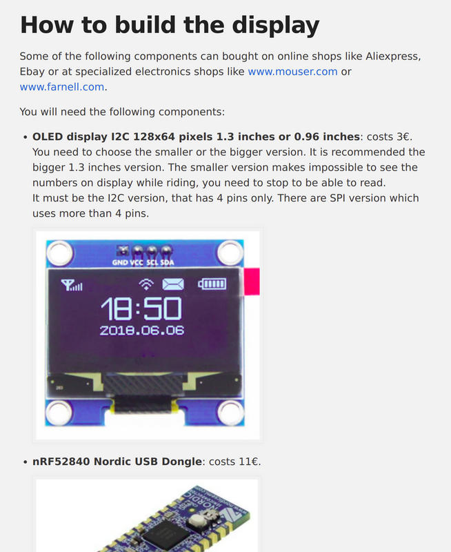

Final documentation on How to build the display, here: https://opensourceebike.github.io/
Because 850C / 860C display are expensive, suddenly fail and were done to not be repaired, I now have our simple, DIY, easy to repair display, based on the SW102 display. It works very well but still needs some more firmware development, mainly to refine some things.

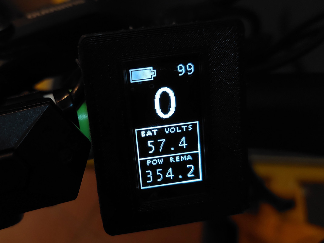

Here is a video of the display working on my EBike with TSDZ2 motor:

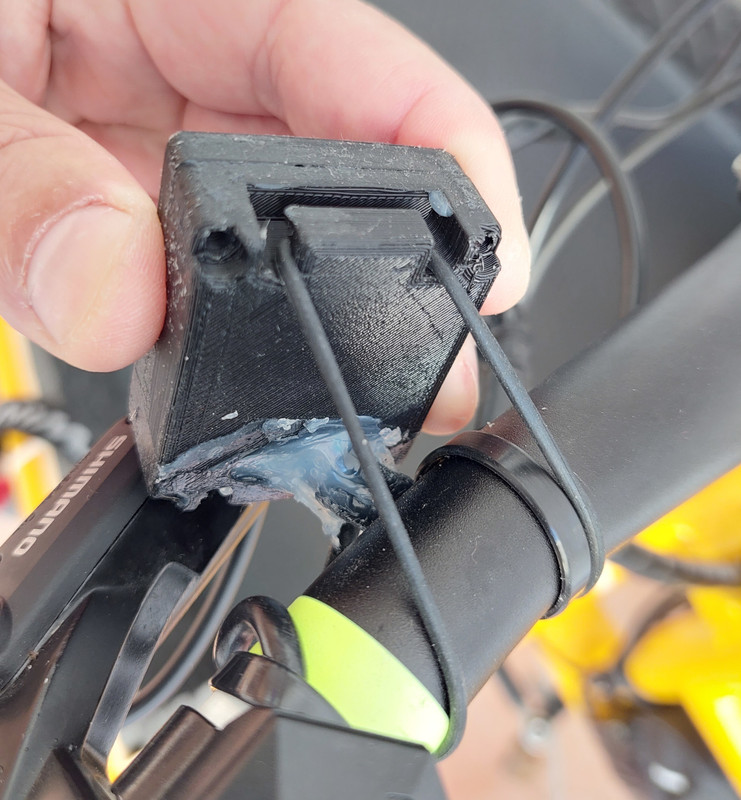

I did the 3D printing enclosure in a way it fix to the handlebar in a similar way of the Garmin GPS displays, using the elastic, so should be easy to fix on any handlebar position.
On the bottom there are 4 small screws on the corners, to easily open in the case of needed repair:
It also works with our mobile app, where we can make the configurations, change the assist level and see motor data:

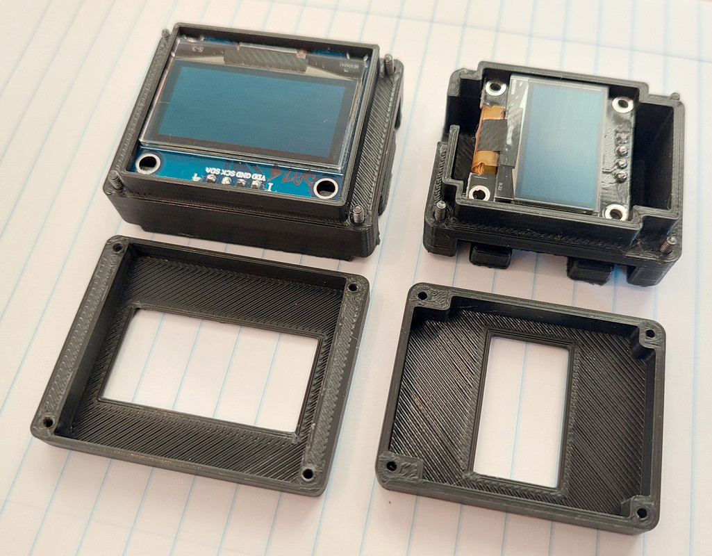

I did a new design because I wanted to make the display water prof. I think it is not water prof but in the end I got new ideas how to improve the design to make sure it will be. Meanwhile, here is the latest design:

Finally I insulated my display, using tape and then silicone. Soon I hope to start using this display on my ebike, then make a release of the firmware and write instructions for how to build it:

Because the OLED 0.96 inches screen is a bit smaller than the electronics itself, the volume of the final build is a bit big compared to the screen itself. So I decided to try with the OLED 1.3 inches, that is the exact same size of SW102.
Both this OLED screens has the same pixel count of 128x64.
Here the result:

I did finish the configurations menus. Next week I will be using this firmware on my EBikes and if all goes well, I will make a release and I will document the build process for the display, as also update the TSDZ2 wiki:

I am being testing the display and the screen data on the display, is almost invisible against the sunlight - my only hope is that this OLED displays get better over time.

3D printed enclosures, version for the OLED display 1.3 inches at left and 0.96 inches at right:
