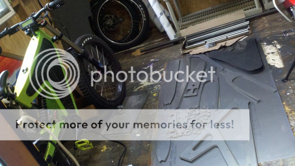

Re: New electric mountain bike frame by Phasor Cycles
Parts are back from the waterjet machine, kind of a before and after shot:
