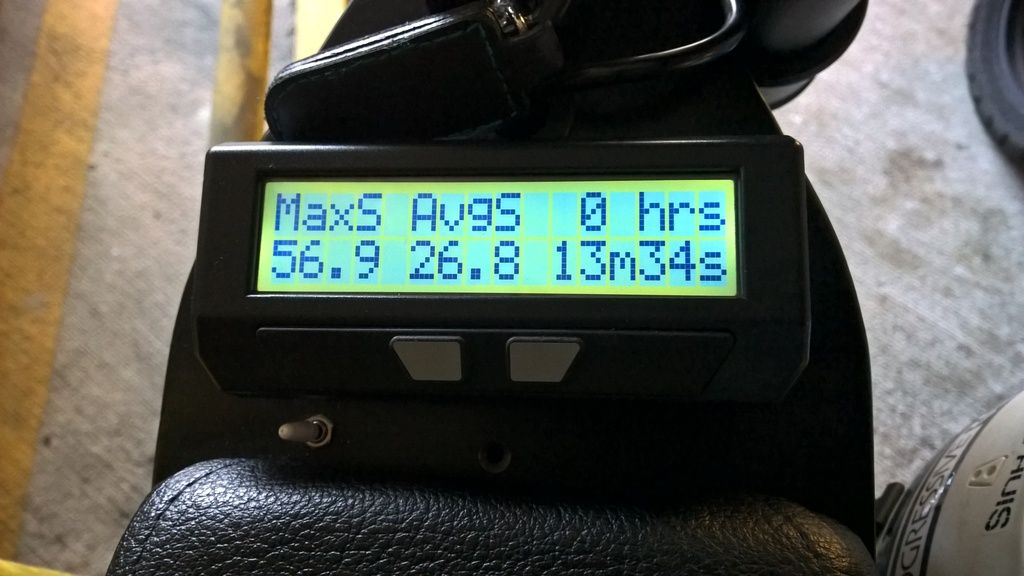

This is my commuter. Has some issues right now with the CA picking up ac signal. Sinwave controller on 18s lipo. Peaked at 56.9mph on CA, 55 something on gps. Fun bike that mostly sees asphalt only. Gets a lot of attention too. Very stable at high speeds. Peaks over 10kw. I don't need any more than ...
