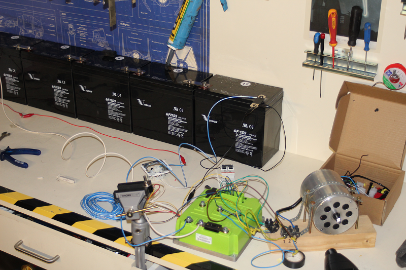

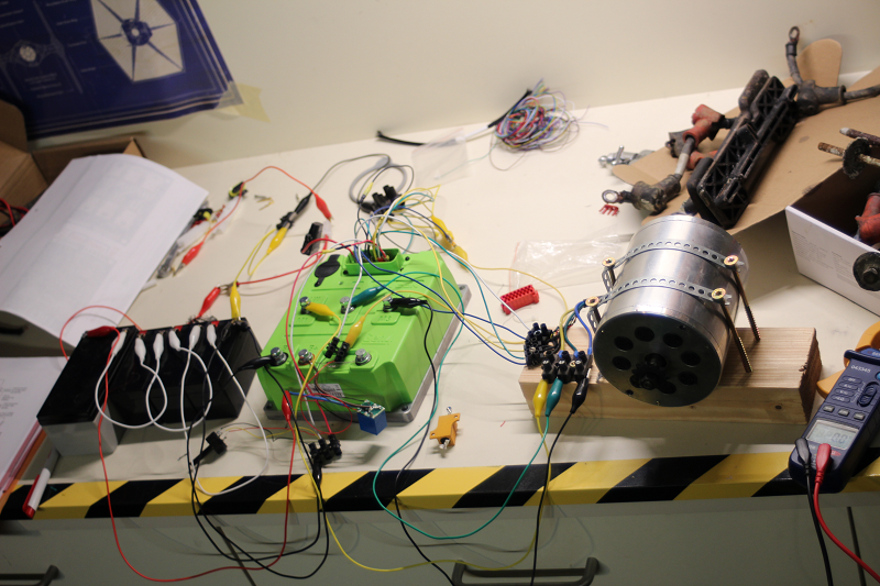

First test with 50 Volt
Second test with 60 Volt
by E-Chopper

Hello at my owen risk I buy one of these KLD Controllers for 140 bucks (for a sevcon it´s real cheap) the controller come with no wiring harness or manual . So i had to make a DIY wire connection . The manual i download from thunderstruck-ev . (the manull dont tell you for what the controller is pro...
