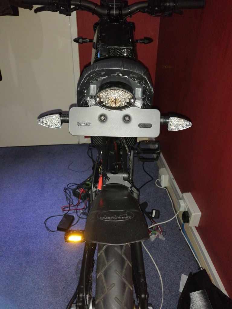

My offer of a old style .50 ammo can still stands. Cheers mate but I did buy a couple of the 5.56mm cans which are identical to the older .50 cal ones. The trouble is, because I made the pack with the batteries on their side, it makes it about 230mm wide which is way too much. I bought some other b...

I admit when I've made a mess of things......
I found some aluminium boxes the perfect size for the batteries but..... I fitted them on the bike and now, I can't ride it because they're far too wide.
Back to the drawing board :(
V2 of the battery is looking much better though :D
