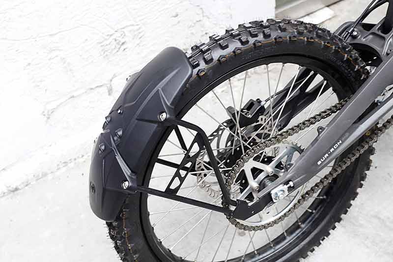

Re: Sur-Ron - New Mid drive Bike
They also have this interesting mud guard for sale on the same jd site around AU$20
