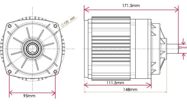

Aug 02 2019 6:27pm
Forum: E-Bike Technical
Topic: Cyclone motor length and mount volt measurements
Replies: 2
Re: Cyclone motor length and mount volt measurements
This is the very first google result for "cyclone motor measurements". It's accurate.
