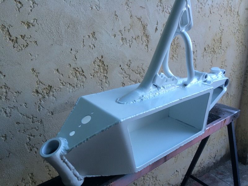

The box is designed to fit a battery that is 130mm x 140mm x 300mm. This is the space required for a 14S 14P 18650 pack. I recently had one of these batteries built for a friends bike by Cell Man(EM3ev) and put it into a Electric Enduro frame build. I purchased the whole set up from Cell Man, my mat...

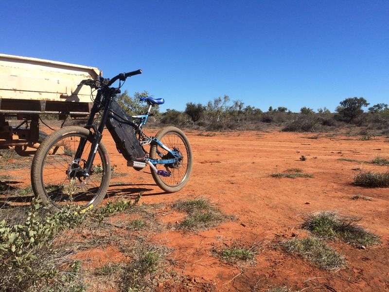

I found a photo of the complete bike when running 2 x 16000mah multistars.
This was taken on a friend's cattle station 1200km north of Perth.
