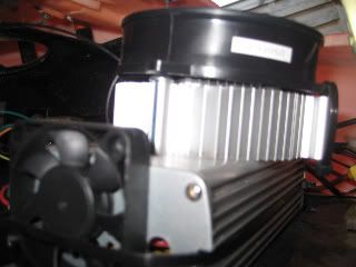

Re: YOUR CONTROLLER COOLING
Here a close up of the controller mounted on the scooter with cooler.

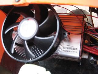

ok i tried another sollution which pretty works well for now. I used this cpu heatsink and mounted it on the topside of my controller. Also i placed a 60mm fan on the side of the controller. (these pics will follow) I can put them on with a simple unused lightswitch on my scooter. http://i256.photob...
